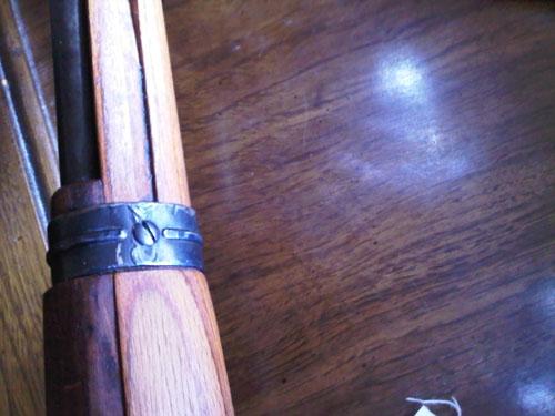

    The rest just looks like leftover parts put together. i wish that I could see the front site better. It appears to have a sight protector like a Czech VZ-24 but, it could just be the photo. At first glance I thought it was a VZ-24 in a "last ditch" or post war stock but, the rear sight is definately a 98k. Also, I would like to see how the bands are being held on. If they have screws holding them on it could give it another vote for "last ditch" but, a lot of Israeli ones had them too.

    I've uploaded some more photos based on your comments so far asking to see different parts for more answers.
