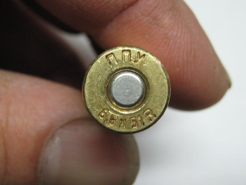

    When I bought this Type 38 carbine I bought a new stock from Numrich(the old one is pretty bad)and went out to shoot. I loaded five rounds, loaded and fired, cycled the bolt and fired again, that's when I noticed the piece of brass on the ground didn't look right, it looked like this:
    After I got over feeling very stupid for not checking the rifle out better(thank goodness for the strength of the Arisakaicon action) I unloaded the rifle and went home to see what the deal was. I soon discovered that a number of 6.5mm Jap rifles had been rechambered in .257 Roberts. I did some measuring on the spent cases and found out it is a .257 Roberts. Since then I have shot the correct ammo through it and it does good, it will hit the 200 meter NRA rams every time from the rest. You would think that the .257" bullet would be a tight squeeze in a barrel made for 6.5mm(.2559")but it works, although it may be hell on the bore. I figured I'd post this so somebody else doesn't have to learn the hard way.

    .257 bullet a tight squeeze in a 6.5mm bore? I think you have it backwards. I'm quite surprised your getting any accuracy at all. A 6.5mm bullet measures .263-.264 dia. while a .257 bullet measures .257. Appearently your gun's bore is just tight enough for the lands to grip the projectile. If you were to shoot it over a chronograph you'd see a lot of velocity loss due to blow by from the undersized bullet. The .2559 measurement is actually the BORE diameter for a 6.5mm barrel not the GROOVE diameter. Get yourself a set of 6.5/257 dies and use the correct dia bullets and you will get better accuracy.
    Your right, I was thinking backwards, anyway I don't plan on shooting it anymore but if I do I'll take your advice, thanks.
