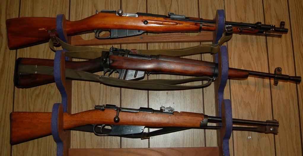

    I've had two days to work in this, probably spent a total of 8 hours on it. The stock was treated with two coatings of citris strip and two coatings of wood bleach on the rust stained areas, rubbed down with steel wool and given one coat of BLOicon. The cracks were glued, I did use the dreaded sandpaper on the butt stock crack repair.
    The metal was scraped with the flat edge of a screwdriver to knock the heavy rust off, wire brushed and lightly steel wooled. The magazine is showing some pitting but everything else cleaned up pretty well. I tried to take the same photos for comparison but this is with flash rather than sunlight as it is now getting dark here.
    Let me know what you think.
    Before:
    After:
    Before:
    After:
    Before:
    After:
    Before:
    After:
    I'm not done with it but was anxious to get it back together. Probably won't get much time to work on it again for a while. I want to go over it again very closely for rust that I may have missed.

    Feeling better about your purchase now, Strider?
    As far as ammo goes, Norma's the worst, Prvi is a safe but not too accurate choice, and the Hornady is outstanding- IF your bore is in excellent shape. Hornady runs a larger dia. bullet- I like it, but it has stirred some controversy in the past. There's several older threads about ammo and such in this and the "ammunition and reloading" forum. An excellent old MKLicon article as well, I think.
    My little carbine is about the least accurate of my Carcanos, but the front sight's too close for good focus anymore. A younger fellow would probably do better. What's interesting to me is that all my fixed sight Carcanos have spot on combat zeroes!

    Yes, I feel pretty comfortable with my purchase now. I figured the metal would clean up but you never really know for sure. I still have to find some clips before I plan on getting ammo for it. I've looked around and found several places that sell them so that shouldn't be too hard. I'm not in a rush to shoot it though.
    Slings appear to be a bit tougher. I found a couple of old ones for sale that don't look like they are correct, one on ebay looks more like a Chileanicon Mauser sling than a Carcano. There doesn't appear to be any repro slings out there either other than K98icon slings which various sources say were used on these. Finnishicon marked slings seem more common but this isn't a Finnish marked rifle so I don't really want to go with one of them.
