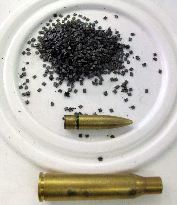

    As part of an investigation instigated by a thread on the Japanese Rifles forum, I decided to actually check some dimensions of some milsurp and some commercial ammuntion.
    Three highlights and then mostly pictures.
    First: Original bullets (four different samle types) AREN'T 0.264" diameter. More like 0.2615-0.262".
    Second: Some commercial ammo is seriously undersized on the rim thickness and drop to a shoulder datum. (pick whatever datum you want- its still short!)
    Third: Base dimensions for all ammo checked are fairly uniform but small for the chamber. (This is what started this knowledge quest originally!)
    Blue million pics!:
    1a, 1b. Milsurp ammo
    1c.
    1d.
    1e.
    1f.
    1g.
    1h.
    That'll do to start. More coming...

    Rim thicknesses are also not consistant. Note that the Norma ammo is not the newest, but I've lots of it and have had no previous reason to buy more.
    Thicknesses were measured with a vernier height gage on a shop grade granite surface plate. An average of three drops were taken on each case measured and checked against several other samples of the same type of ammo, if available. Note that the bases on the milsurp ammo pictured in photo 1b. are somewhat rounded and have strong primer stakes. If particularly proud, the stakes were gently filed flush to prevent false readings. The dome like nature of the bases prompted the use of the height gage rather than a normal quick "mike-ing" of the rim thickness.
    Not a very photogenic process, no photo at this time.
    Results:
    Milsurp: 0.052"
    Hornady/Grafs: 0.052"
    Norma: 0.043"
    Base diameters:
    3a.
    3b. AKA Hornady
    3c.
    Overall case lengths aren't hugely critical unless they are too long, but it does affect the "name" of the cartridge if done as follows- 6.5x50mm Japaneseicon- Kamzac did note that 6,5x51 seems a better name, but it's not commonly used even if it's much more correct!
    3d.
    3e. AKA Hornady
    3f.
    Needed to measure a drop to the shoulder, as I don't altogether trust the teeny rim to do it's headspacing function, given large chambers and any possible chamber mouth radius!
    As a purely comparative measure, not intended to meet any "standard dimension", I used a Redding neck sizing bushing as shown below:
    3g.
    Results- Surprising!:
    3h.
    3i. AKA Hornady
    3j.
    Member kamzac has other info, and can be credited with instigating this thread, along with ireload2.
