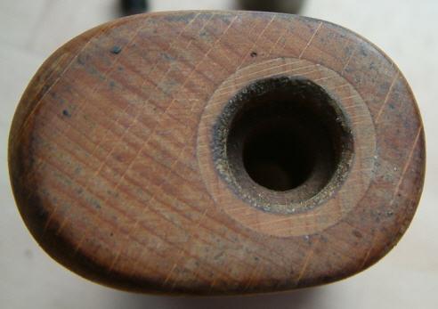

As a matter of interest, after a few hours on the lathe and with some hard wood (local beech.......) it's relatively simple to machine up a wooden bush to the external and internal dimensions that you need. I rasped two shallow flats down the shaft, glued it and pushed it in then made off good afterwards. If anyone else needs to do this in the future, maybe I can suggest that you fully machine the wooden bush to dimension including the new central bolthole AND top and bottom recesses for the butt slide bolt housing and bolt head. Apart from a few duff starts and re-starts, I did a couple and a sample for whoever eventually has to do the job!
I haven't tried vice-verca yet, Mk2 to 1 but it should be a fairly straightforward boring and counter-boring operation
