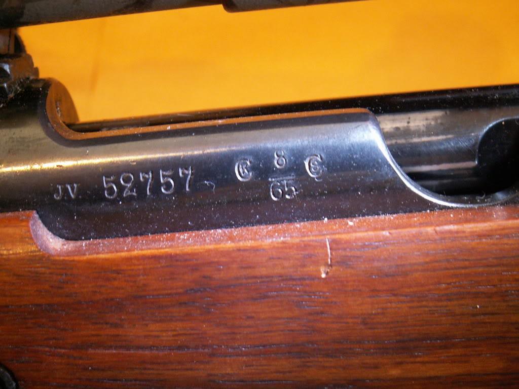

    Actually, the answer to almost every question that was asked, (with much more information and detail,) could have been found in "Crown Jewels." It is the first book I reach for when looking for information on the Swedishicon Mausers.
    A previous post mentioned the possibility of it being a Match rifle. From your written description, it does not mention such markings, although the CG-63 Match Rifle and the FSR rifles, (which were sometimes fitted with improved sights,) use the basic m/94 or m/96 action. A CG-63 Match Rifle will have markings on it similar to ones in the picture below if made by Carl Gustafs. Some CG-63 rifles, however, were made by FSR approved Gunsmiths or other factories, such as Norma.
    While a good description is all right, there is nothing like close up pictures to positively identify an object or markings. It is much better to post detailed pictures when asking about something on these Forums.
