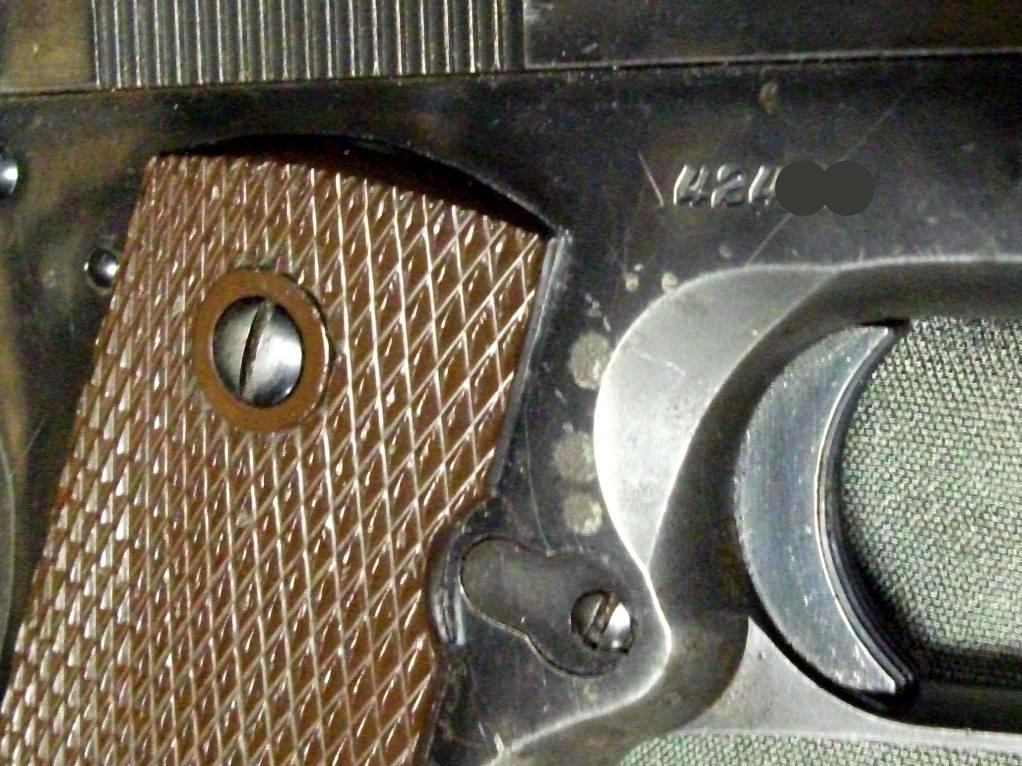

    jmoore's Avatar
    06-09-2023 @ 04:20 AM
    US of A
    7,066
    04-18-2024
    10:28 PM
    I'll try to round up mine in a day or two. Poor thing's been mouldering away since ammo prices went mad. It's not a real high condition piece, but it's unmessed with.
    jmoore's Avatar
    US of A
    7,066
    04-18-2024
    10:28 PM
    Sorry for the delay.
    If they came with the pistol, and there's no reason to think otherwise as far as I've discovered, the grips on this early Post-WWII production Colt are regular old GI type grips:
    Post War pistol on the bottom- Pre War on top both .38 Super.
    hitch1911's Avatar
    03-31-2016 @ 09:03 AM
    36
    04-18-2024
    09:28 PM
    Thanks to all for the info and pics. I see that the post war serial is 42xxx. Close to my serial.
