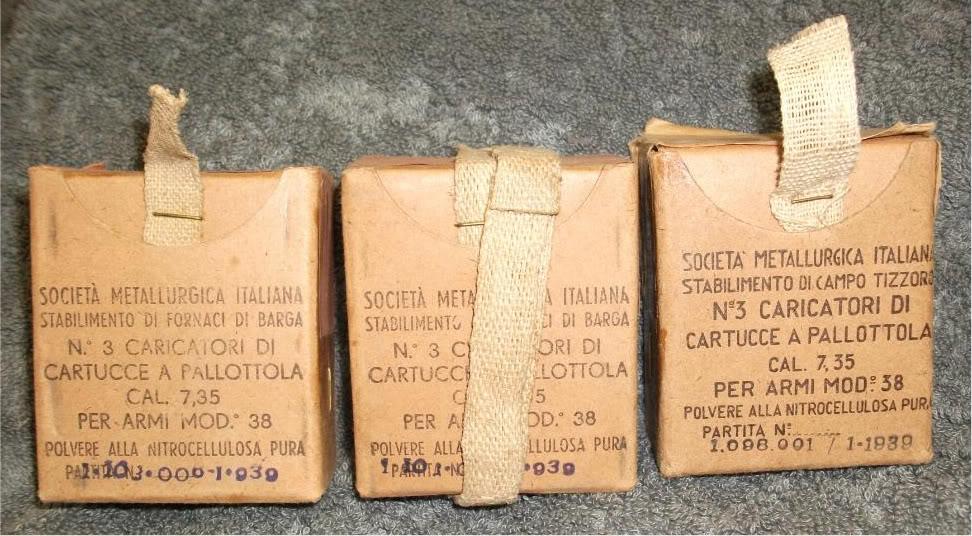

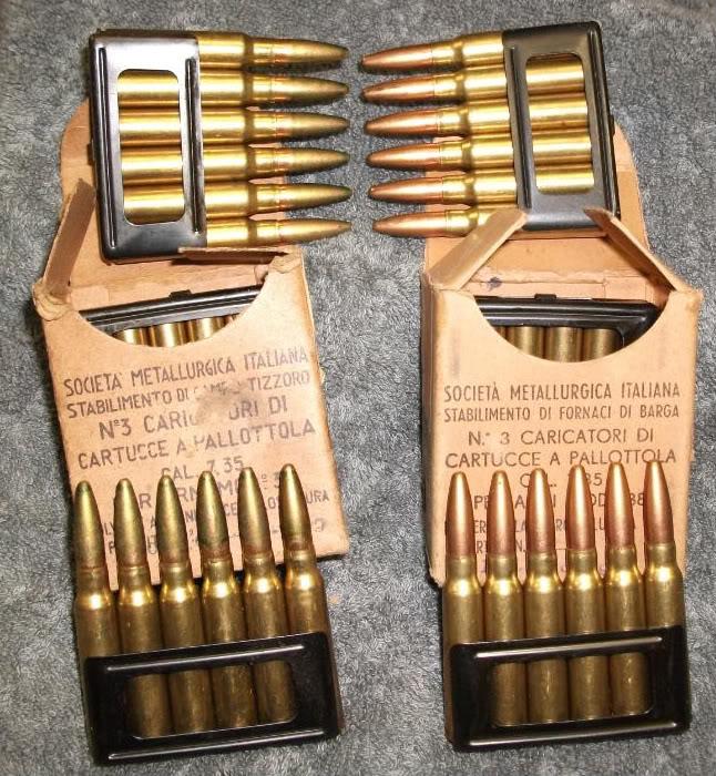

    I don't seem to find any 6,5mm SMI photos handy, but the 7,35mm boxes are about the same, and the clips are identical:
    Note the different shape (Tapered ogive and a bit pointier) of the 7,35mm projectiles from the more cylindrical 6,5mm bullet:
