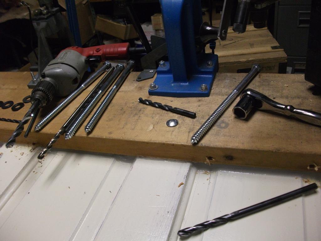

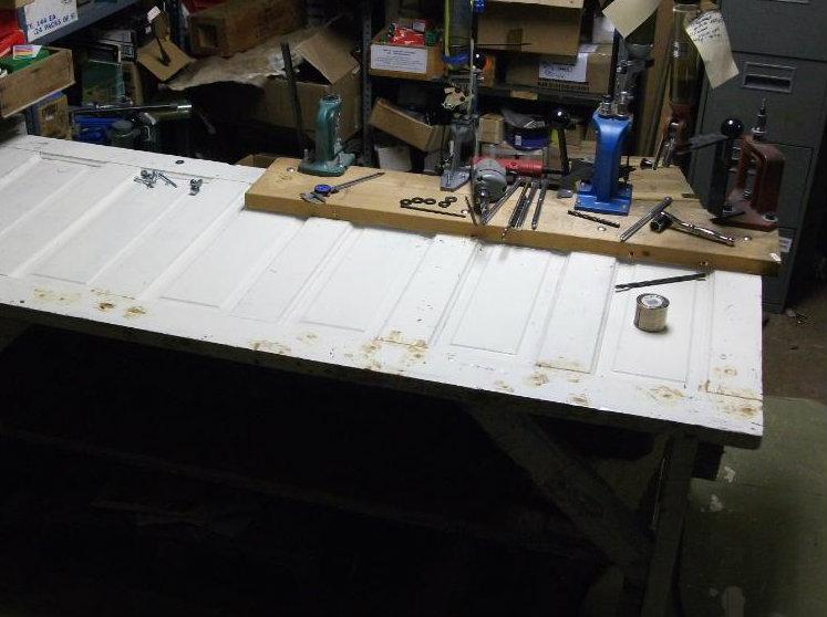

    A bit of paint, filler and reinforcement to the "gang plank". It was showing signs of a split in the center, so some interference fit lag bolts were installed. One went a bit off horizontal, but it was all done by guess and by golly, so that's actually better than expected. The bolts sure seem to reduce flex which was evident even on the old table. ( The calipers were used to get the right sized drill bits for about 0.010" undersized stepped holes. Linseed oil and a bigger wrench was required to reduce torque to managable levels during install.)
    A little silicone caulk to keep small stuff from hiding under the plank was added too.

    Almost ready to start production. Actually a bit ahead of "schedule", but the organization of components has a LONG way to go before anything resembling completion (or sanity)!
    BTW, running the six lag screws horizontally through the top board helped reduce flexing during the upstroke a great deal. A big improvement!

    wondered how the long screws were going to help .. now I get it.
