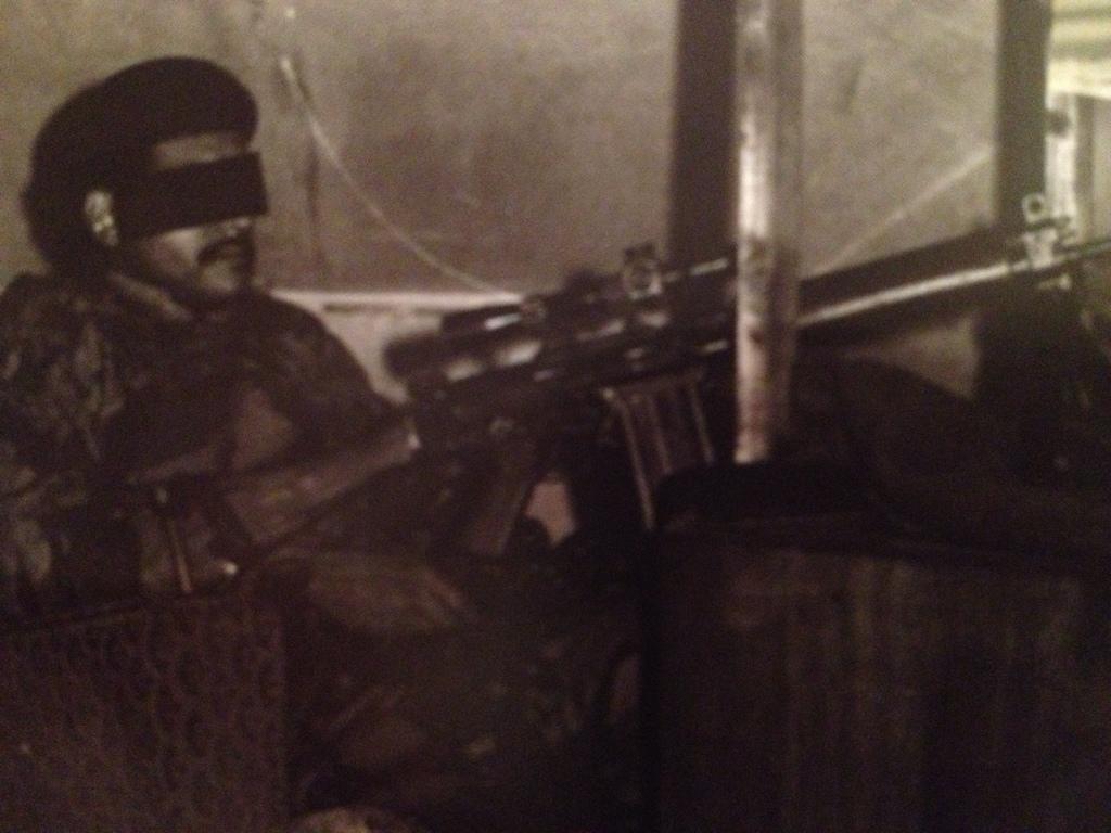

    Sorry to bring up an old thread but...
    3 LI taken between Nov 72 - Mar 73: Northern Ireland: Belfast (Ardoyne) or Apr - Aug 74: Northern Ireland: Belfast (Lower Falls).
    Cheers
    Danny
  12. #30
    Today @ 05:38 AM
    6,935
    06-19-2013
    01:41 PM
    We've seen this 3LI/ex KSLI photo before and the same comments would apply now as then.
