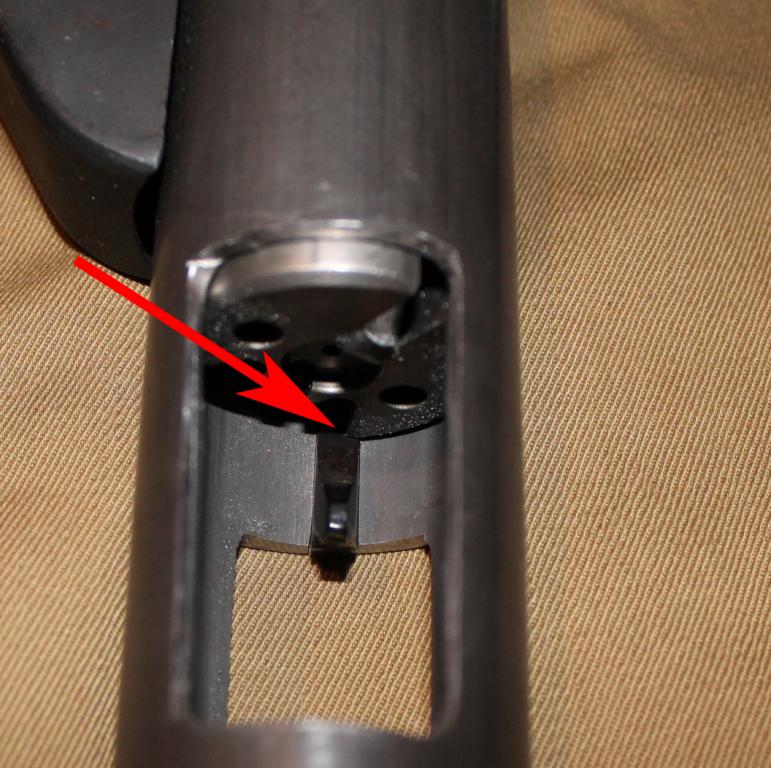

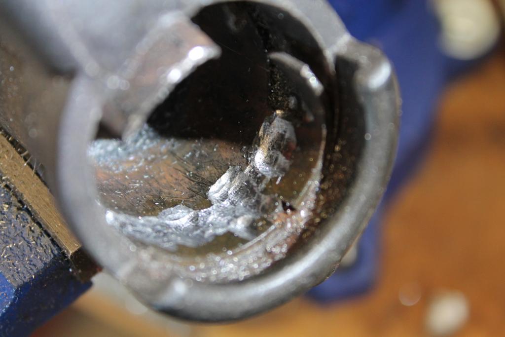

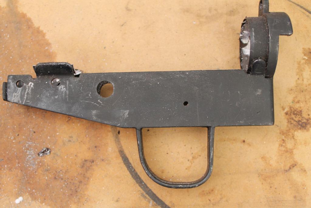

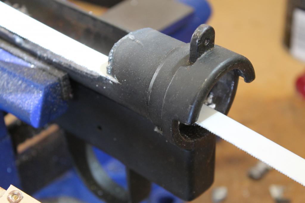

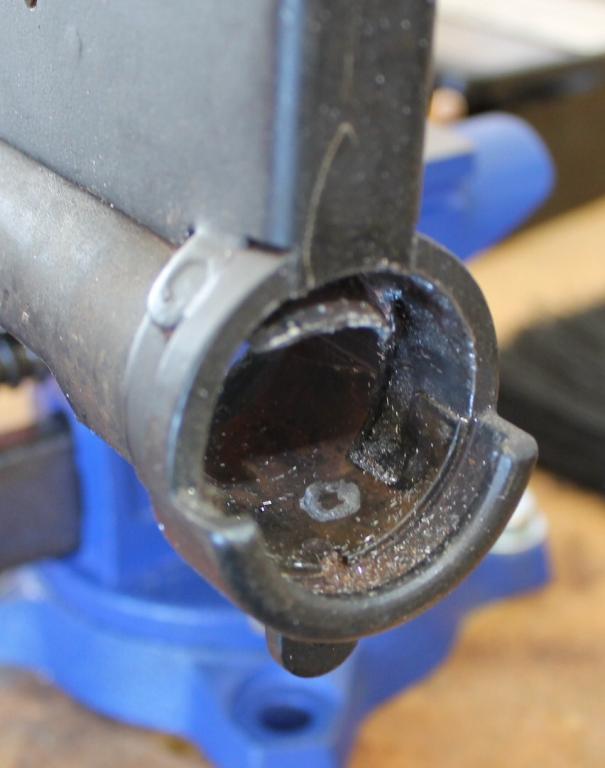

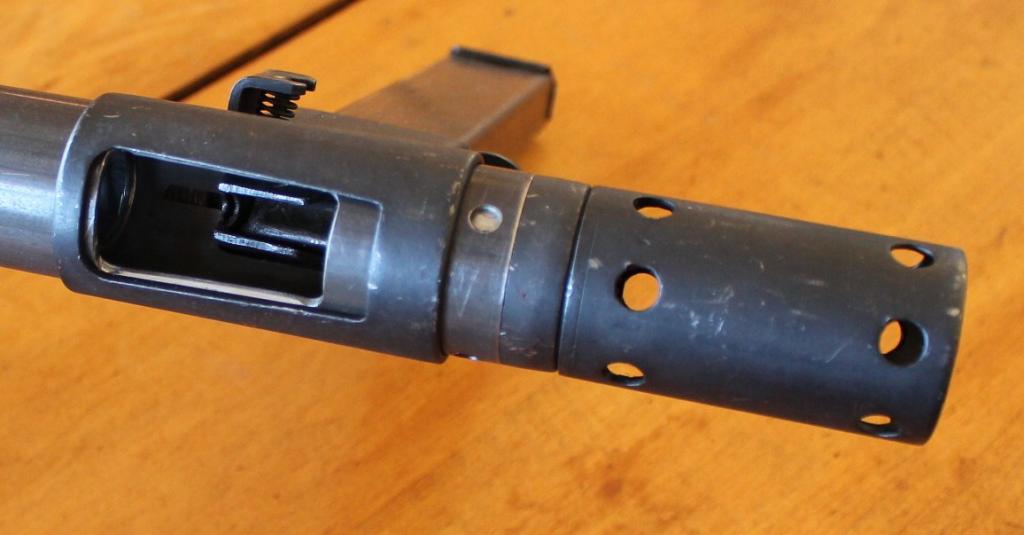

    I received my STEN Mk V parts kit from Apex guns. Overall I was pleased with the parts kit. The torch cut of the receiver tube was done with the re-builder in mind. There was no damage done to other components, and I am pleased that I will be able to detach the trigger housing from the cut tube and reuse it. It has a few nice ordnance markings on it, and it will save me a few bucks. I was curious about the finish as it was done with the semi-gloss black finish over a dark parkerization.

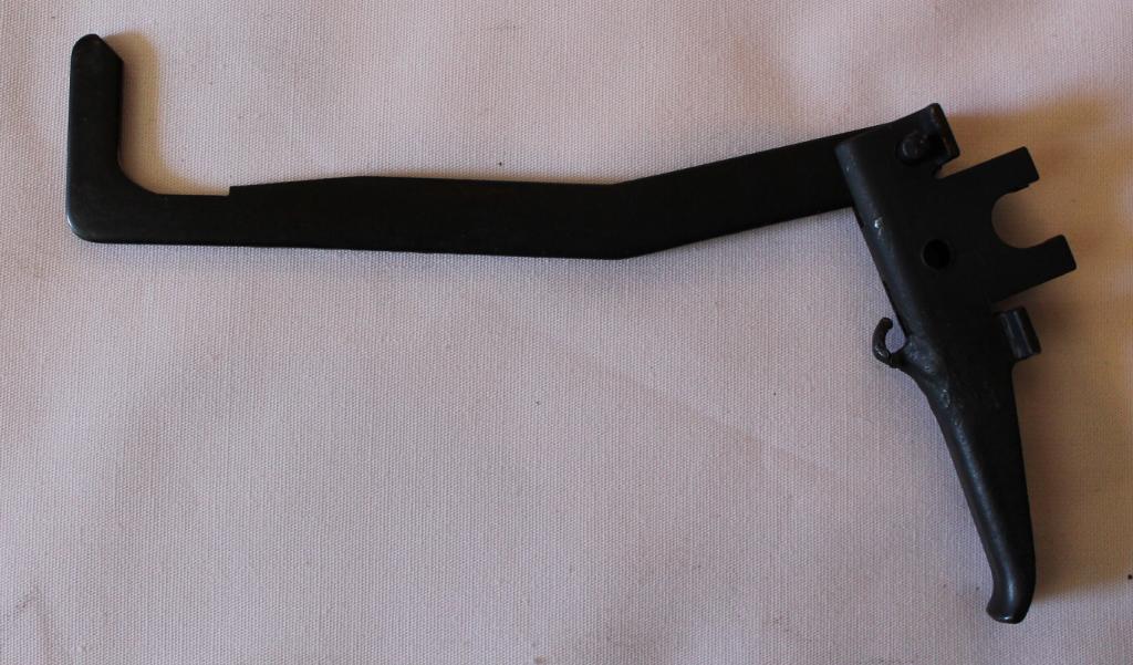

    I will be able to use most of the parts from the kit. The barrel shroud, trigger housing, wood furniture and fittings, magazine housing, front sight and some of the components.

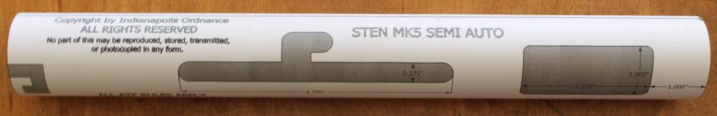

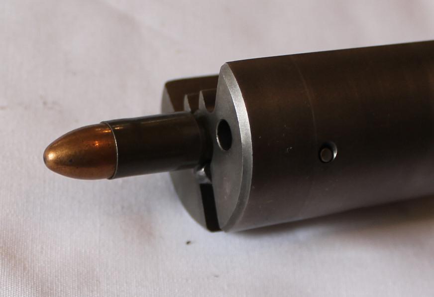

    I will need to purchase a few parts from Indianapolis Ordnance to get the gun running and legal. They sell a Mk III/V kit which is ATF approved and incorporates a smaller diameter bolt that fits in their tube and fires from a closed bolt. Their tube has a smaller inner diameter to accept the bolt, but you cannot put an original FA bolt in their tube. I am not sure which of the trigger components will be able to be used. With my parts kit and their new 4130 steel components i will have a STEN Mk V that looks about 99% the same as the original and is legal. I plan on matching the finish with a bit of wear so as to display the gun with the 17th Airborne Division Recon patrol display. I'll post progress as I move along. When finished, not only will the gun display nice, I can take it out and pound a few metal plates and paper Nazis with it.
    Next I will have to research and determine how to mill the tube blank and remove the old cut tube from the kit so as to do no damage to the trigger housing.

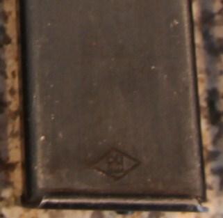

    Received a few nice ww2 STEN Magazines yesterday. These are in average condition in terms of wear to the finish and are full of cosmolineicon, which is good, but I selected them for the differing manufacture stamps. There are three types shown in the middle laying flat.
    1. L.B. For Line Brothers
    2. S68: Code for Line Brothers
    3. unknown symbol/letters in a diamond. Looking for comments on this one. It is also blued in stead of phosphate finished

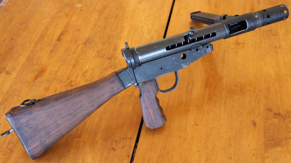

    Note the STEN, looks like a MkV.
