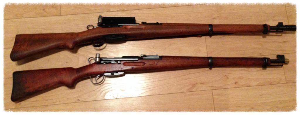

    Have added both the Swissicon Products muzzle break and Clamp-on Scope Mount to one of my K31s.
    The other K31 I will leave with the standard iron sights.

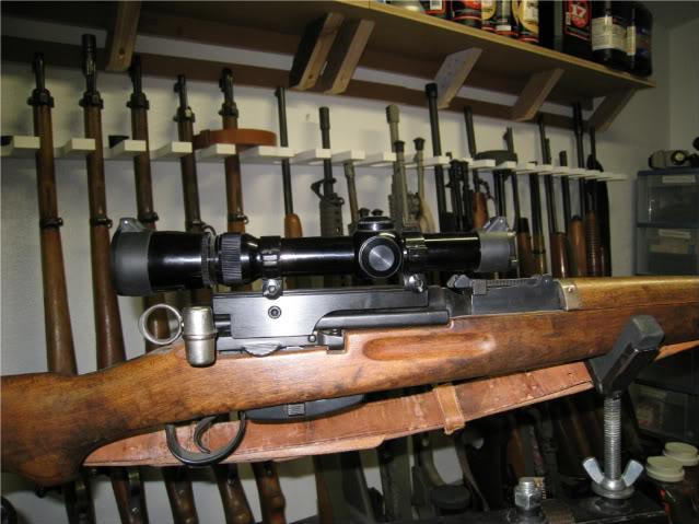

    I mounted a Weaver K4 60B with post/crosshair. Medium range all purpose.

    You're going to get a lot of opinions, but this is what my Father had in mind for all of our scope mounts, both Clamp-On and Drill/Tap mounts. His reasoning is "The lower and closer to the axis of the bore, the better."

    All of us here at Swissicon Products use fixed 6 scopes on our k31s and 1911 types.

    Latigo, could you tell me what scope that is you have in the picture? And when you said "fixed 6 scopes", did you mean fixed 6 power scopes?

    kymauser, that one is a Swift (old all metal type) fixed 6 power. We also have a number of Leupold fixed 6 scopes.
    The mount is a nominal .578 offset from the axis of the bore and brass has no problem clearing a 1" tube. All 4 mounts, the k31 Clamp-On, the k31 Drill/Tap, the 1911 D/T and the new 1911 Clamp-On mount have no problem with a 1" scope tube. In the case of the 1911's being both mounted on the let side (just like the M1D) would need the scopes rotated to the left it the turret was in the way of ejection. Doing that simply changes the elevation knob to the windage knob and vice versa.

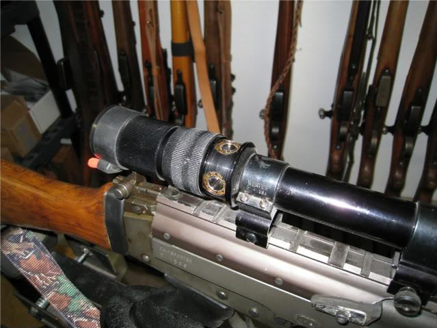

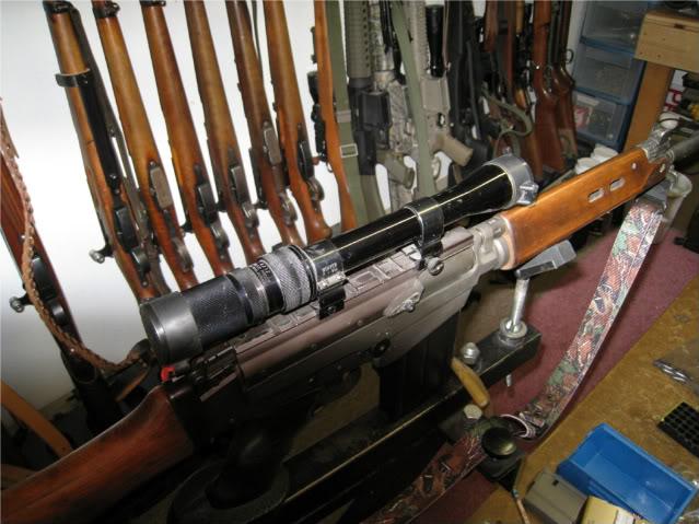

    This is (for me) the epitome of a scope for an off-set mount. Its a Swift Turretless fixed 8 power, rare and very hard to find. My Dad has even offered a $50 finder's reward, but so far, no luck. This scope has all metal inner workings. Look at the windage and elevation system with a slip collar that is 100% waterproof when screwed shut. Perfect scope for any SP mount. Here it's mounted on a FN. It does quadruple duty through the year.

    The next picture will be after my selecting/purchasing the scope.
    These products are easy to install if I can do it!
