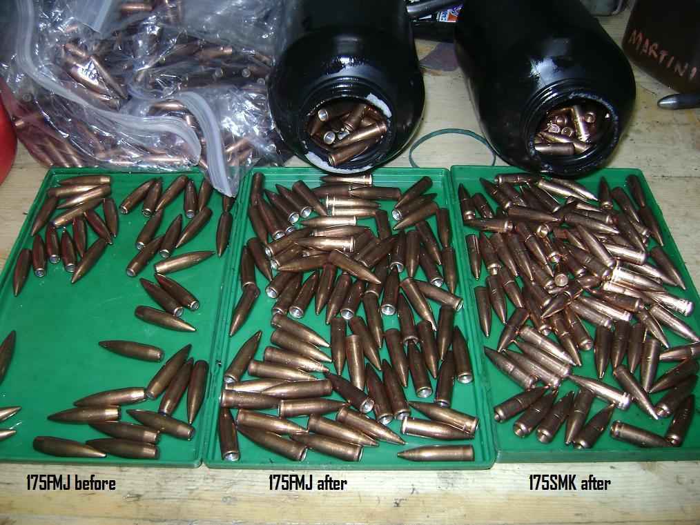

    I picked up 450 sierra 30cal match kings that were pulled from surplus ammo and 750 30cal FMJBT bullets. both 175 grains
    I have been running through the press in my spare time. all the SMK's are done and half of the FMJ's are done
    these will be used to feed the BREN and the Vickers

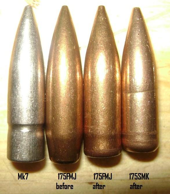

    there is the Mk7 from a 1942RG for comparison. the bullets went from .308 to .312 and lost their boat tails.

    I see from these pics the bearing surface of the .62 pill gets longer which is good, I also see the base of the lead inner is concave a good deal this would help with obturation and give a good seal but I have to ask can they be pushed to .312 or would this make the .BC suffer to much, thanks in advance.
    getting the 175's to .312 is no problem. I made the die the same profile as the Mk7 so no matter what I feed into it a Mk7ish bullet comes out just the length varies depending on the weight and construction.

    I finished all of the bullets I have on hand. I did 1200 bullets in 4 hours. (done in my spare time so its in lots of 30 min over several days). that includes the time to reset the die between bullet types. reset took about 5 minutes. its basically press a bullet and measure it and adjust the die body down for fatter or up for less fatter until the correct size is achieved.

    Looks from the picture as if the re-formed bullets may perform even better than "flat base" in slightly worn barrels. They appear to have a dimple in the base which should open up and seal the bore, a bit like a Minié ball. Could we see a cross-sectioned bullet?
