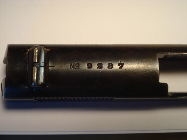

    Guys,
    I just realized I didn't get a picture of the top/rear part of the frame, it is also stamped with a circled RA and a G.
    I know the circled RA stands for Lt Col Raul Adreas Ara.
    A few parts are stamped with a circled R.
    What might the circled R stand for?
    What about the G ?
    In one of the pics you can see a C or G stamped inside the left groove of the slide.
    Also the picture showing the upper left grip screw hole. It has the number 20 at about the 9 'o' clock position, also a number 3 at the 3 'o' clock position.
    Any idea what these may stand for?
    I'm guessing the V with the small P inside it at the 6 'o' clock would be a Colt proof (?)
    Any thoughts are appreciated.
    Regards
    Charlie-painter777

    Here's a picture of the G and circled RA.
    Also pictures of it put back together and the link to Photobucket,
    Colt-Argentine model of 1927 pictures by Painter8439 - Photobucket
    Thanks for any help
    Regards
    Charlie-painter777

    The circled R and RA are both Argentine inspector's stamps. The inspectors were present at the Colt factory when the guns were made according to Clawson. Major Juan Carlos Bassi was in charge of the inspection team. Lt.Col Ara was Director F.M.A.P. in Argentinaicon, they made the Sistemas in Rosario, Argentina.

    Anyway, that pistol is a bit unusual in having the Argentineicon serial number on the right side of the frame in script. They normally had no serial number at all in that position, and the true frame serial was under the mainspring housing. When the guns were brought back, the importer was required to number the frame, so the slide number was used, but the number stamp was in a different font. Snce the Argentines apparently used only the slide number for inventory and control, they placed little emphasis on keeping parts together and it is rare for the original frame number, under the MSH, to match the slide or added frame number.
    Painter777, could you look under the MSH and see if there is a number there and if it matches the slide number?

    First I'd like to Thank You All for the help.....
    To JimK,
    Here's a picture of the Serial Number under the MSH.....
    Every Number on it matches...
