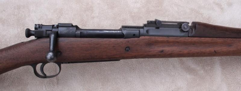

minuteman,
Here is a picture of my SA M1903, mid-1918 vintage, with its J5 bolt.
https://www.milsurps.com/images/impo...ofJ5bolt-1.jpg
rollins74, thanks for the photo. Nice looking rifle, I will try to bet mine looking that good someday. It will give me something to do for a few years
