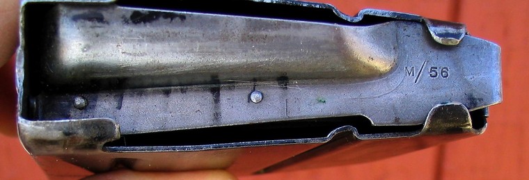

The magazine platform and body were manufactured by W.C. Cheney & Sons Ltd:
https://www.milsurps.com/images/impo...74b4017J-1.jpg
https://www.milsurps.com/images/impo...d46af9fJ-1.jpg
I don't have a clue what the D below the Broad Arrow signifies or the numerals 87. Perhaps they are inspector's' marks?
(The magazine body has a serial number stamped on the bottom but it does not match the rifle.)
