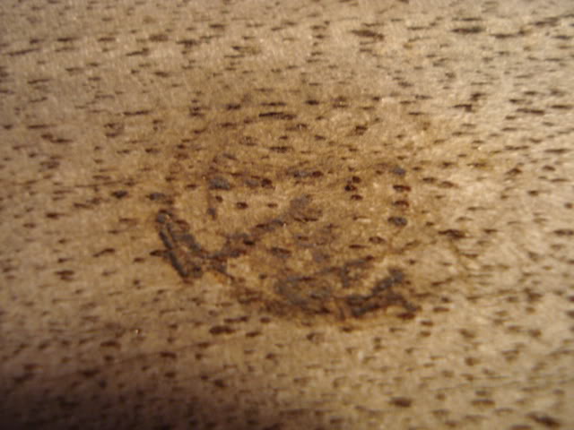

Here is a picture of a bleached out LW-B marked stock.
It is damaged on the hi-wood rail. A Type II...or was, repairable but will be time consuming.
It has just a remnant of the CC left.
Regards
Charlie-painter777
