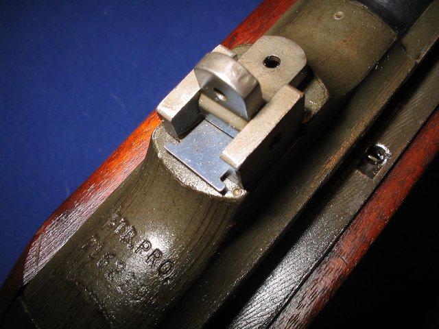

The stake marks (flattened areas) at the extreme right hand end of the dovetail may be the original Type 1 stake marks. I have an S'G' that is like that and have pictures of a couple others from this forum that are similar - they were smoother though. - Bob
Attachment 22997
Great picture USGI. You can clearly see how for to the left the flip rear is and the metal in the dovetail from the two chistle marks.
