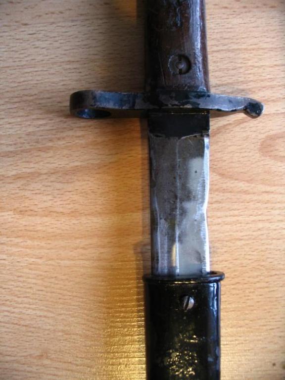

I bought a Ross bayonet model 1907 made in dec 1916 in prety bad condition. As you can see on the picture, the blade as been sharpened 20 years ago by the young brother of the seller (awfull). Also, the guard has been painted black with appear to be metal paint.
The same paint has been applied to the scabbard, that turned to be a Swiss Schmidt-Rubin model 1918. The two of them were bought in the 50s in a surp shop in Montreal.
How could I remove the paint without further damaging the metal?
https://www.milsurps.com/images/impo.../10/0032-1.jpg
I would use acetone or maybe 1850 paint stripper. Both are liquid and won't damage metal. Don't get them on your hands and do it in ventelated areas. The paint will liquify and wipe off.
dittos - but yes take it off
The bayonet pictured doesn't look lik a Ross bayo, nor does the scabbard look like a Ross scabbard. Looks more like a P-1903. Can you post a picture of the entire bayo?
Yes the bayonet's a Ross. The 1903's got double edge. If you read the original post it says Schmidt-Ruben scabbard.

I've found I could get lightly painted things off with acetone, but it takes a bit of work. That looks like it has quite a bit of paint built up on it and I'd use stripper. Paint stripper is designed to remove paint from metals and wood and shouldn't harm anything. Read the back of the stripper to make sure, and as Jim said, follow the safety rules.
When I use stripper, I coat the surface using a parts cleaning brush while wearing rubber gloves and after it sits a few minutes the paint will bubble up. Then use the brush and scrub it while rinsing it with the water hose outside. If you leave the stripper and bubbled paint on too long before rinsing, it dries out and the paint gets sticky. The water will neutralize and disperse the stripper. You usually have to repeat to get all of the paint off.
