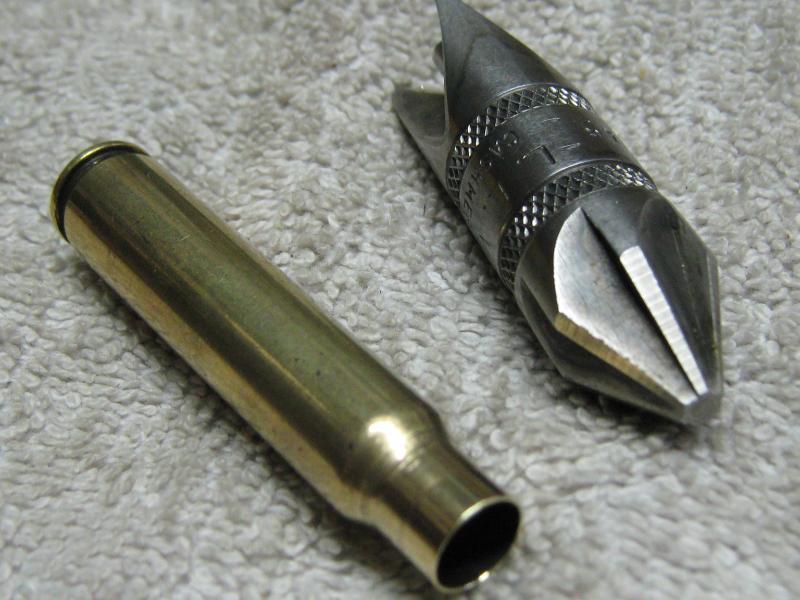

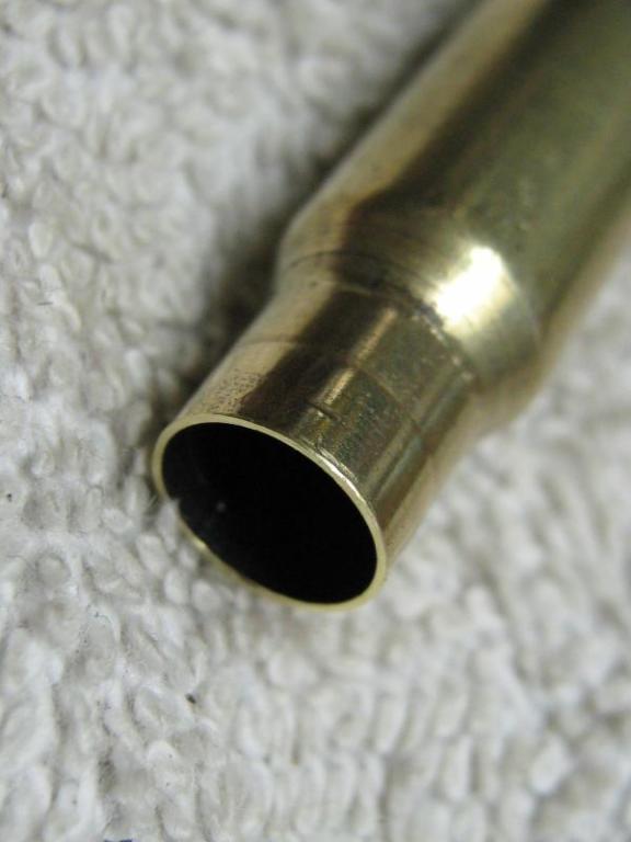

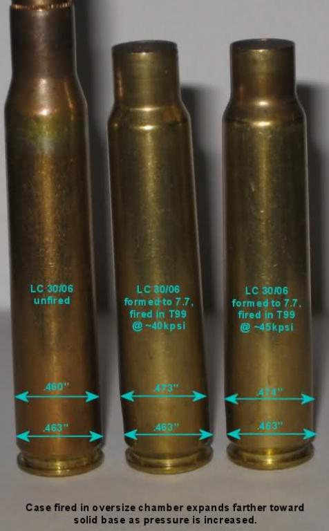

I have a couple of Type 99s and decided that I would like to shoot them a little so I formed some brass. I run 30-06 brass through a 7.7 Jap FL sizing die and cut about a quarter inch off and trim. I used bullets I pulled from 7.62x54r.
30-06, 30-06 squeezed through 7.7 die, 30-06 squeezed and trimmed

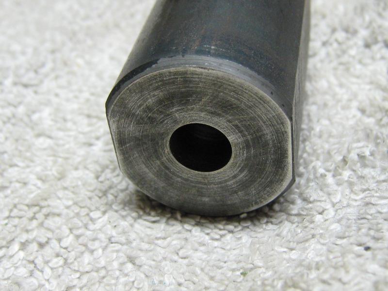

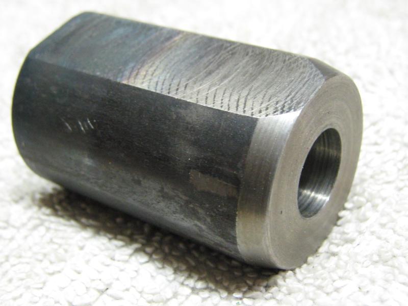

Here's the trim die my machinist friend made for me.
https://www.milsurps.com/images/impo...IMG_1997-1.jpg

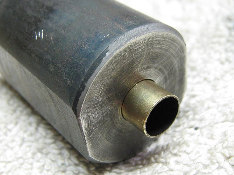

https://www.milsurps.com/images/impo...IMG_1999-1.jpg

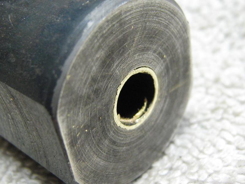

The untrimmed squeezed 30-06.
https://www.milsurps.com/images/impo...IMG_2000-1.jpg

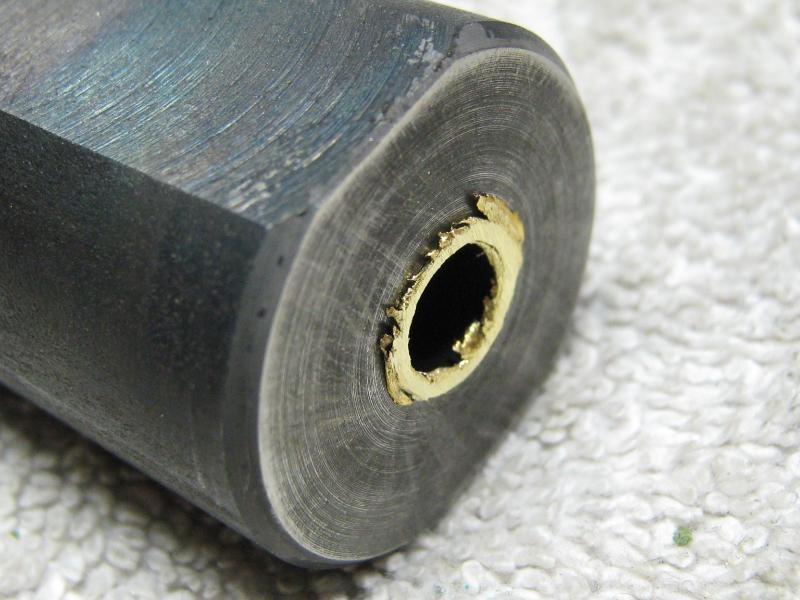

I take most of it off with the bench grinder.
https://www.milsurps.com/images/impo...IMG_2001-1.jpg
Then I file down to the die.
https://www.milsurps.com/images/impo...IMG_2002-1.jpg

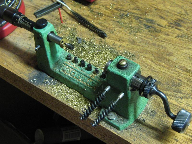

A quick spin on the deburr unit.
https://www.milsurps.com/images/impo...IMG_2003-1.jpg
Over to the trim unit.

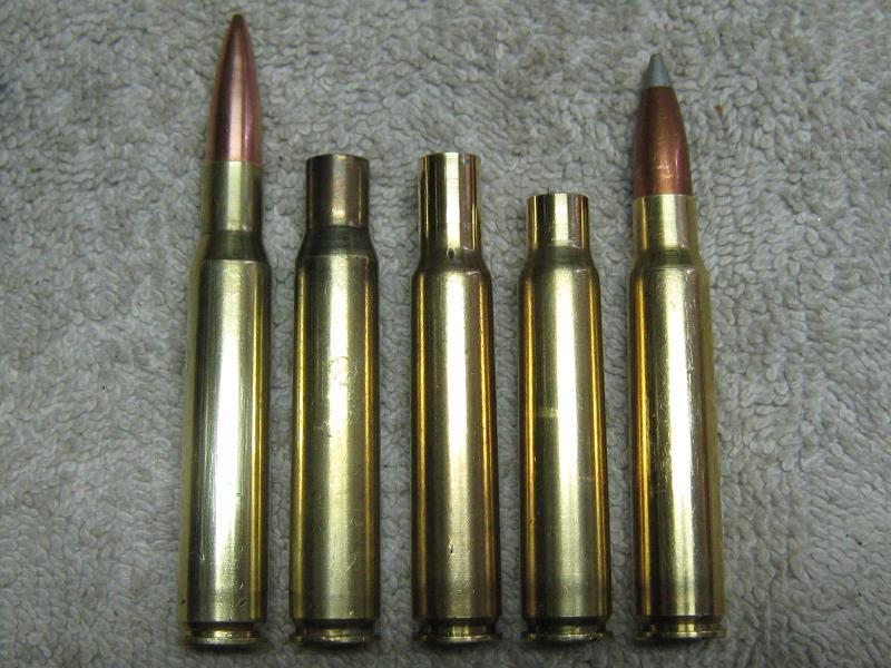

30-06, 30-06 fired case, 30-06 squeezed to 7.7, finished 7.7 case, loaded 7.7 shell
https://www.milsurps.com/images/impo...IMG_1996-1.jpg
