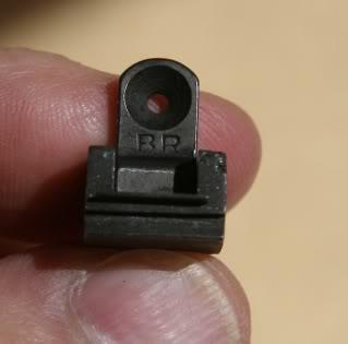

I have a carbine peep sight with the code BR (who made this peep ?) and what would be the correct base for this peep sight ?
Printable View
If original, it was made for Rock-Ola by
Jasper Blackburn Co.
St. Louis, Mo
They made both the leaf and the base marked BR
Thanks for the information, the peep is original as I have had it for a number of years, it is a medium color of parkerization

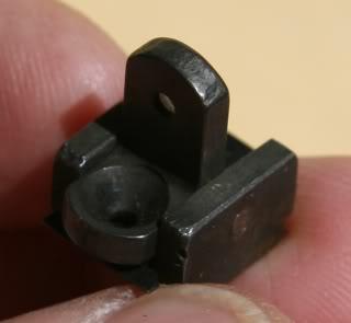

I have one in my parts box too, but somewhere in the past it was put on the wrong base.
I've been looking for a base a long time.
Oh well, 1/2 of a good sight anyway.
https://www.milsurps.com/images/impo...8/BRsite-1.jpg
https://www.milsurps.com/images/impo...achment2-1.jpghttps://www.milsurps.com/images/impo...chment12-1.jpg

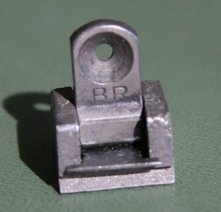

I have a photo of my BR peep sight on the carbine forum of jouster if you want to view it, can't post photos here.
Here they are.
https://www.milsurps.com/images/impo.../BRleaf1-1.jpghttps://www.milsurps.com/images/impo.../BRleaf2-1.jpg
