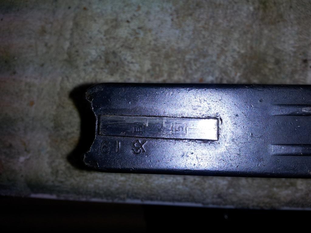

There a 640 under the POL OLD marking and a 619 on the Magazine ( same batch for Oldenburg, mixed magazine ? )
The serial even if it's small ( S37171), it looks like the S3 has been add later. Or maybe the first part " S3 " is electro-penciled and the " 7171 " is stamped. Can it really be a 1945 with that little serial # ? Or it was refurbished in 1945 ?
All pointed to a BSA rifle, except the Front sight blade is Longbranch and the Magazine appears the to be a Savage one, re-stamp B ( for BSA )
