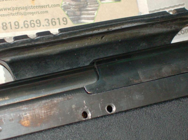

Second, I worked on the scope mount. Had to switch it to the right side because the left side will need to be clear for the bolt carrier knob... Easy enough to level the mount with the receiver, a few hours in the shop drilling and tapping; step 1 completed.

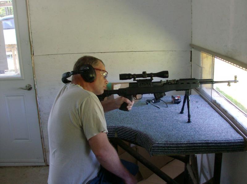

Well, there it is, I just have to put a scope on it, and we'll be testing this one out at the range. If the results are satisfactory, we'll see if theres something useful which could be attached to the forend - forward grip, or a brace of sorts; that'll be the fine tuning, if my friend likes the overall feel. I'm waiting for a buttstock with cheek riser, but other than that, it's pretty much done.
