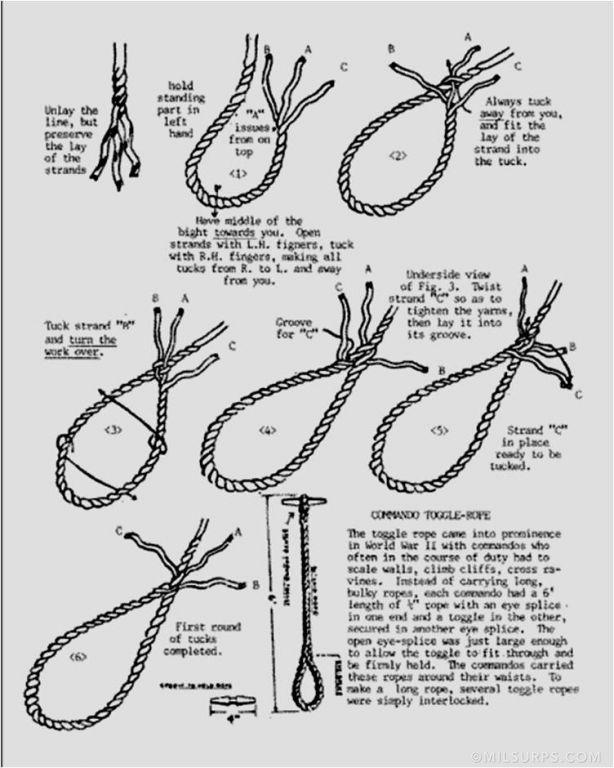

I have seen vintage pictures, both British and American, showing soldiers equipped with a "toggle rope". And I remember reading, back while going through FAOBC in 1973, a World War 2 period manual I found in the "stacks" of the Morris Sweat Library at Fort Sill that made reference to "toggle rope". I wish I could remember what that manual was. So "toggle ropes" are not myths. I have found a lot of article on how to make one and I have made a couple in accordance with those articles. But I have not seen any "OFFICIAL" document giving the specifications for an "OFFICIAL "toggle rope".
They vary greatly from maker to maker , but figure an adverage of 8 feet of rope with eyes on both ends , one around a wooden peg , about 6 foot long when done , and around 1/2 inch diameter rope.

As mentioned previously, Vietnam era (and post Vietnam era) Australian toggle ropes were nylon and had no wooden toggle. Here is a picture showing one properly coiled and attached to the webbing.
Here is an instruction sheet. Not the greatest but, I think that you can make it out.
