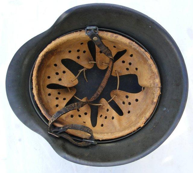

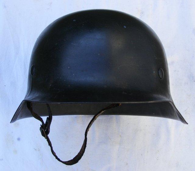

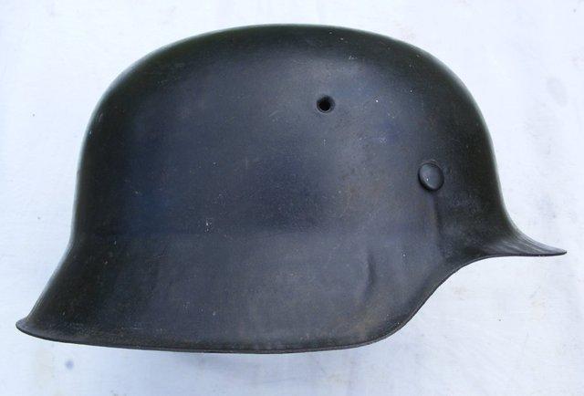

I was given this helmet when I was a kid, that was about 50 years ago! I realise that I don't actually know much about it, I don't want to sell it or anything, but if possible I would like to know a little more about its origin. Looks like an M43, but is it a German WWII helmet? Can anything be gleaned from the stamps? Any information very much appreciated!

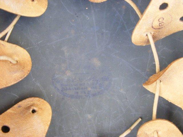

https://www.milsurps.com/images/impo...k20stamp-1.jpg
Ink Stamp, inside on the crown.

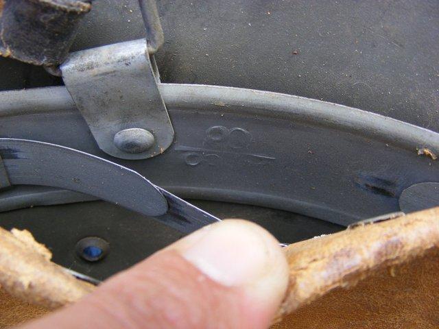

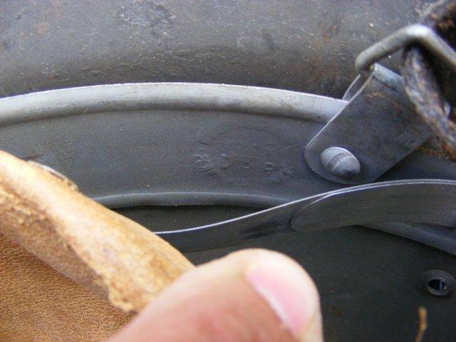

https://www.milsurps.com/images/impo...d20stamp-1.jpg
Embossed stamp on the liner band.
https://www.milsurps.com/images/impo...stamp202-1.jpg
Second embossed stamp on the liner band, opposite side.

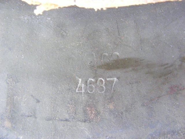

https://www.milsurps.com/images/impo...e20stamp-1.jpg
Stamp in nape of the helmet shell.

Or maybe its an M42?
More likely (having done a bit of looking on the internet), its a Model 1942 (M42), the most common type. But the air-vents don't seem to be embossed, as they should be?
The helmet is indeed an M-42 with a later war second pattern zinc M-1931 liner band as stated the air vents are rather odd and looks to have been pressed in reverse perhaps this section of the dye was missing and it went un-noticed as at this point in the war helmets were being produced through the method of hot pressing and was nearly completley automated by this point it could have slipped through the final inspection process and or was given a pass as other than that the helmet looks servicable.
Your helmet was produced at the Eisenhüttenwerke in Thale manufacturers began marking their helmet shells with the initials of the factory or company names over the course of time, several of these changed making it initially appear as though there were more than five manufacturers the company would have formaly used the initials ET before changing to CKL the change in the factory designated name and marking had to do with the fact that the company names changed.
Regards Mark
Charlie303, could you please confirm if the edge is rolled over on the rim to form what some would describe as a "safety edge"; I can't quite tell if there is from the photos. I understood it should have this if WW2???
There were three models of German combat grade helmets produced from 1935-1944 the first was the M-35 which had a rolled edge the air vents in this particular model were produced separately and then inserted into the helmet body.
The next variation of helmet was the M-40 the rolled edge was still incorporated into this model with a few small changes in the way they were produced most notably would be that the air vents were now directly pressed into the helmet body using heavy presses and a dye.
The last variation of German helmet that was produced was the M-42 which had a raw flared out rim by eliminating the rolled edge they were able to elimanate a step in the manufacturing process and in essance speed up production.

Many thanks Mark for the info on my M42 and for answering the rolled edge question.
Another source I found stated that the manufacturer was 'Eisen-und Hüttenwerke, AG Thale/Harz', is this a mistake, or maybe just another way of naming them?
I showed the helmet to a collector of German WW2 militaria I know, he thought that the chinstrap was possibly a post war replacement. Might you be able to offer an opinion?
Lastly, since I posted the pics above, I've cleaned the outside of the helmet. I recall, as a young lad (this being an excuse) I darkened the outside with black boot polish! :red face: This presumably to make it look like the German helmets I'd seen in Commando Magazine. Anyway, its all gone and the helmet looks better for it I think:
Attachment 66353
Regards,
Charlie
The straps were routinely replaced because these helmets saw use in various countries right up to a short time ago. South American type armies...they had to keep them in nick for actual use...yours may not be one of these though. That's why you can find these with replacement parts that are years old and look great. They actually are original replacement...but not German.
