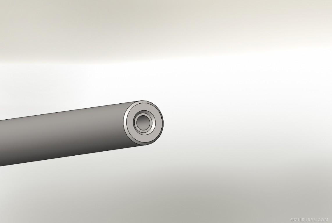

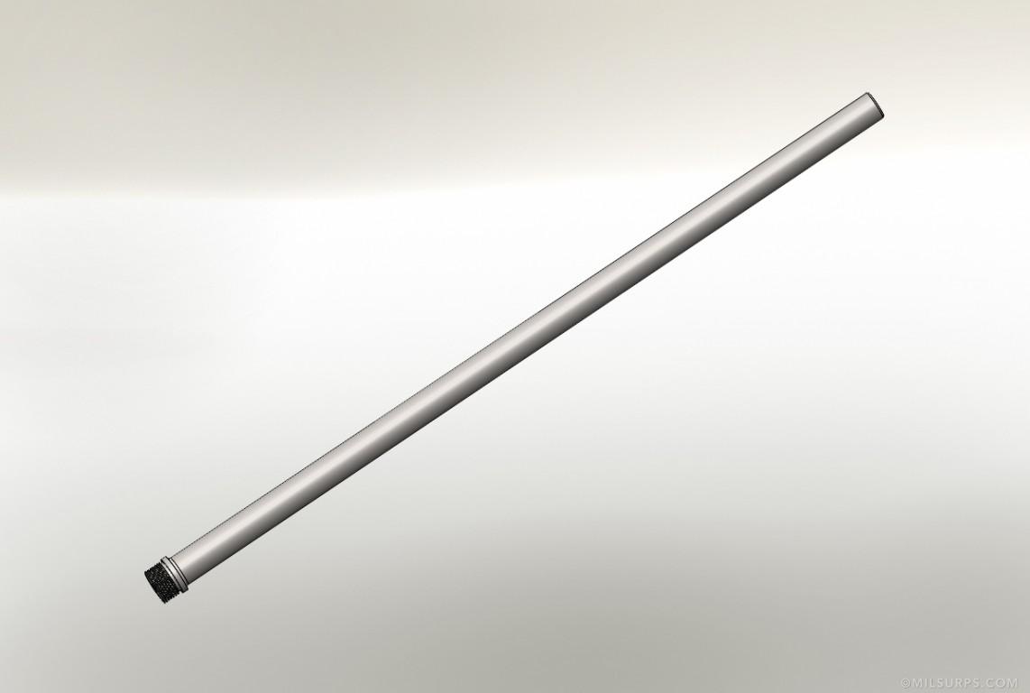

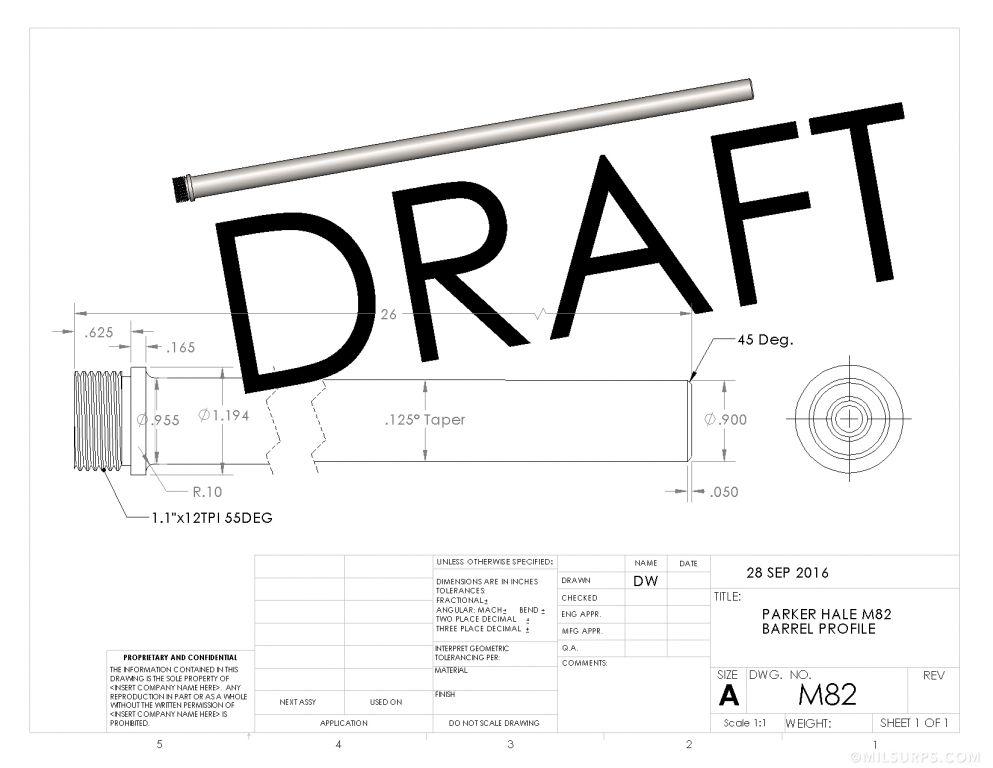

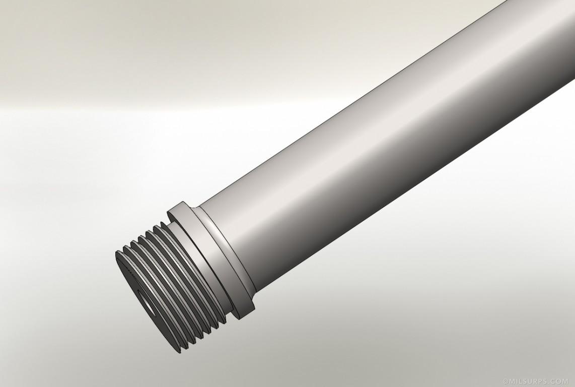

Hello,
I just made a quick M82 barrel profile in Solidworks based on the most reliable info I was able to find.
It looks like quite a few of us have M82 projects on the go.
Enjoy.

Can I ask is the M-82 action the same as the commercial 1200 Parker Hales as one day when my 22/250 P&H's barrel is kaput I would not mind making a clone M-82 as the action is super strong. But for me I would get the barrel customed from say Bartlein as I have allot of people say to have one turned down after it has been rifled that it stresses the barrel what is the consensus on that one. TIA
Same action,so you're all good there.
Sure barrels can be turned down to suit,but not all smiths will be geared up to do so.The easiest option would be to order the profile you want.
Cinders,
I have never heard of rifling a barrel after it has been contoured. Can you imagine a lightweight sporter barrel or most profiles for that matter not twisting and distorting during the rifling process.
When a barrel blank is button rifled, the button is pulled (usually) through the bore, you need the rigidity of the extra metal to keep everything straight.
For the M82 profile, I honestly would not worry too much at all as it is really thick and heavy (>4lbs). Most of my barrel blanks are 1.2" diameter, so it won't take much metal removal to get to the M82 profile.
