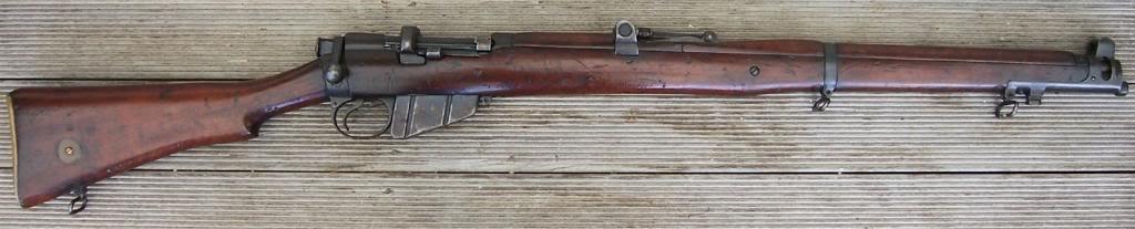

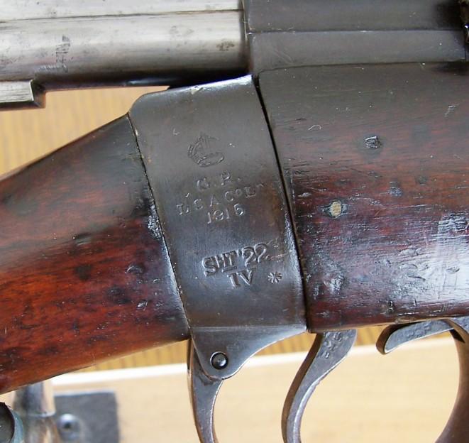

This is my 1915 LSA MkIII converted to a .22, does it look like this?
https://www.milsurps.com/images/impo...2MkIVone-1.jpg
http://www.milsurps.com/images/impor...2MkIVtwo-1.jpg
https://www.milsurps.com/images/impo...2/15LSA3-1.jpg
If there is nothing else on the wrist besides "LSA Co Ld", then it is likely a commercial (aka Lee-Speed) model, meaning that it was manufactured for private sale--either as a .22 or was converted later to .22. The AGP Parker rifling marks would indicate the latter. The marking you describe on the knox could be the L.R. Tippins mark. Sounds like this could be a rarity.
