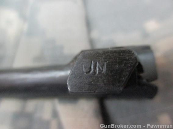

Just wandering GB today and came across this UN marked bolt.
Not faulting the seller, just curious as to the UN marking.
Anyone have a picture they can share?
Maybe just a bad stamp?
CH-P777
https://www.milsurps.com/images/impo...22403993-1.jpg

No picture, but why would it not be an NPM with a crappy stamping?
Not saying it isn't.
Feel free to buy anything you see with any Crappy Stamping you desire.
If made by US&S for NPM, I like to look closely and try to compare to clearly marked ones.
UN marked bolts IMO are some what rare, seeing that US&S only made 54,594 of them.
Many/some being found with a number 2 on the small left lug.
Cheers
CH-P777
on 4097XXX
This one is from my NPM purchased from CMP back in the carbine frenzy days.
Maybe NPM was not very particular with the quality of their stamps ?
Pretty sure they manufactured their own bolts in house.
Ray
