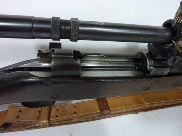

A few photos of mine. Condition is a strong 99%.
Barrel date 4-35
I can't thank you enough for posting that. That helps me a lot. I had seen that other one with a 1935 barrel and always assumed mine had been a 1935 NM as well. Seeing another one with a 35 barrel just make me think it is even more. But these 1935 NM seem rare as hens teeth. Your's is only the second one I have ever seen.

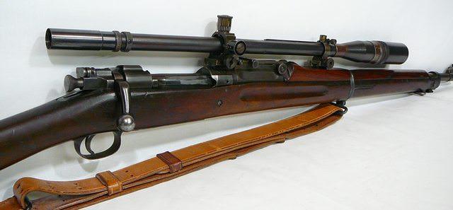

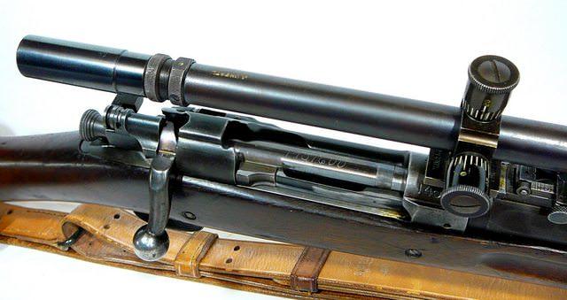

Here's my rifle 1459600. Mine was rebuilt by the Marines into a Special Target rifle (rebarreled NM rifle). The polished bolt was blued by the Marines in a July 1942 order, and the scope mounted probably in early 1943.
https://www.milsurps.com/images/impo...aygRf8gl-1.jpg
https://www.milsurps.com/images/impo...WBnzErsl-1.jpg
https://www.milsurps.com/images/impo...RhwG531l-1.jpg

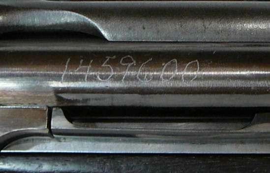

One other thing I would be curious on. How does the writing characteristics of my numbered bolt match yours? Usually I see a distinction in the way the number 4 is written.
I've always sort of though my bolt was numbered by SA and not the Marines. But the Marines bought replacement NM bolts and numbered them.
So I'm just curious how does this number's witing style match yours? I was trying to look at your pics and I couldn't tell for sure.
By the way that is a beautiful NM!!
