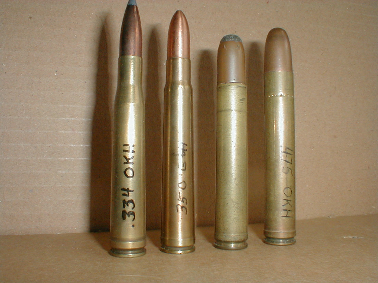

Then Elmer Keith and his friends started necking down the 375 H&H case to their 334 OKH which influenced the development of the 338 Winchester and 340 Weathererby.

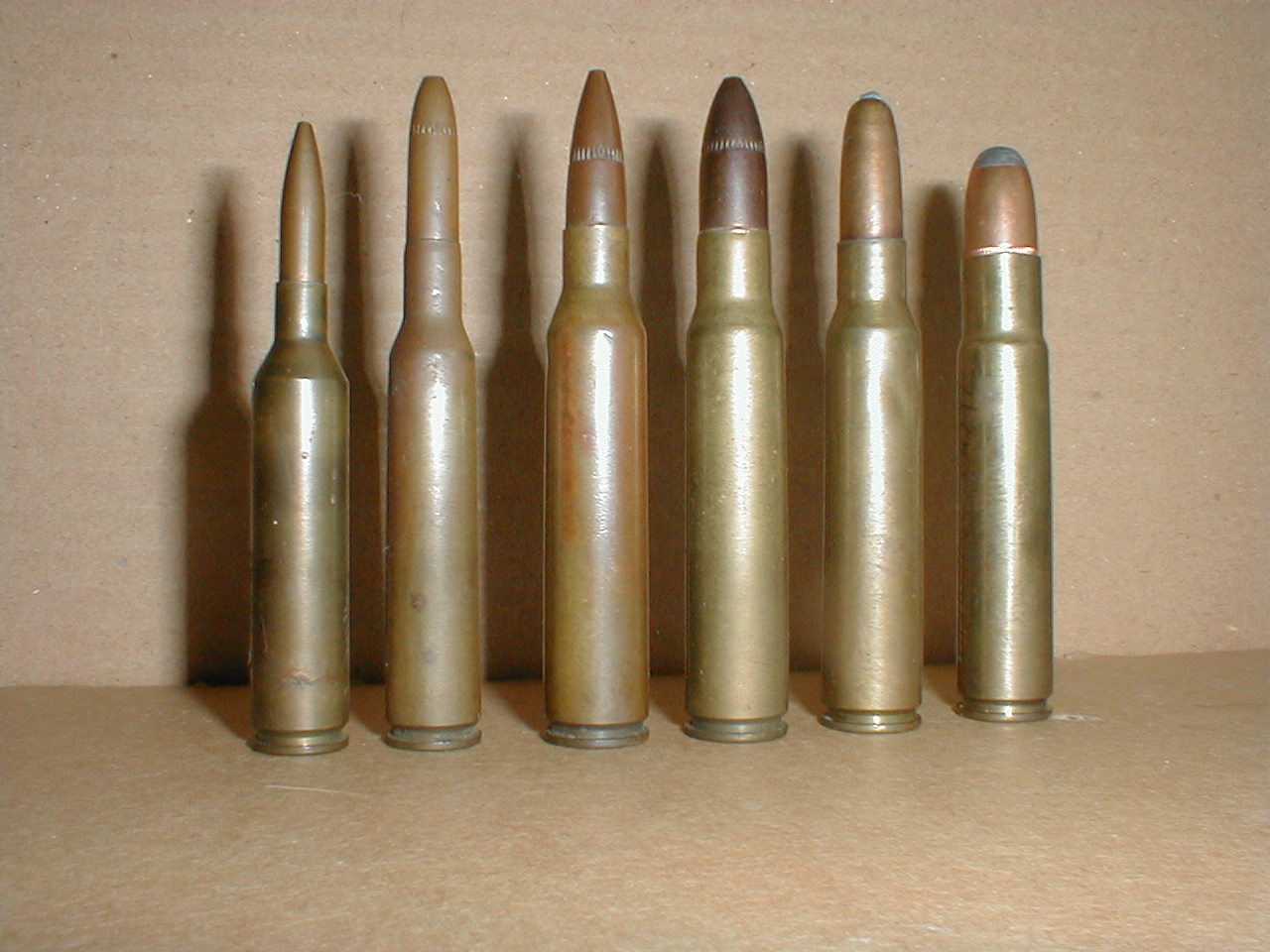

You also had the Newton cartridges from the WW1 period, while the 30 Newton and sometimes 35 Newton had a following, the 33 Newton died.
The 8mm Rem Mag is an excellent cartridge in the Rem 700 BDL just never sold well
photos show the Newton family and some of Keith's wildcats from years agoAttachment 123914Attachment 123915

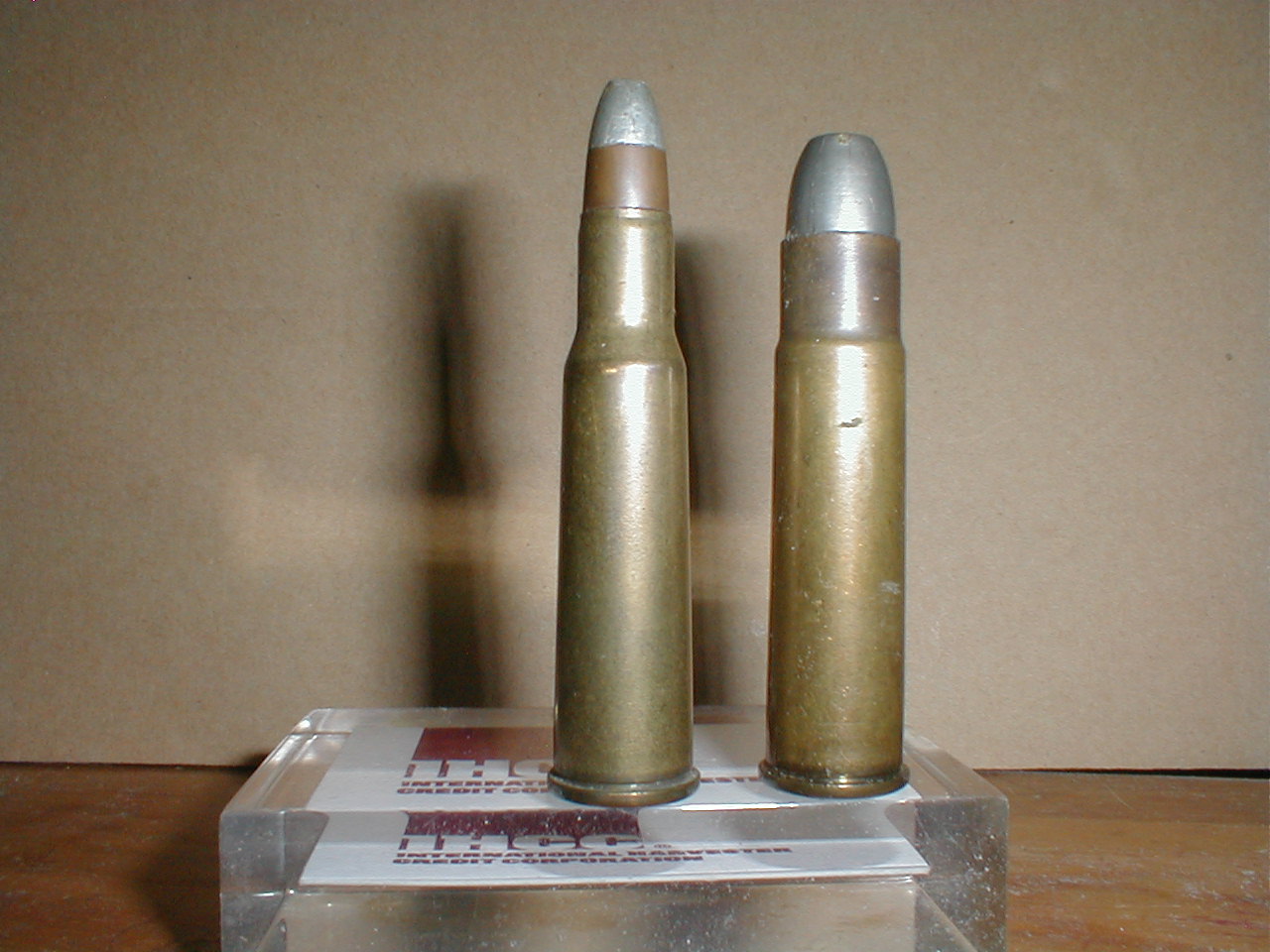

I know by the 10th Edition of Cartridges of the World, they were still using a photo of my 450 Alaskan cartridge. Years ago my friend at Gun Digest (H. Murtz) asked me to loan him some cartridges from my collection for photos in Frank Barnes' book. Most of the photos were replaced over the years but my 450 Alaskan stayed a long time. In the photo, it had a 405 gr lead bullet which was used to fire-form the cartridge.
My friend had purchased a Winchester Model 71 rifle which was converted to 450 Alaskan by a gunsmith in Chicago, George Pearsall (they had gunsmiths in Chicago years ago)
I helped him form the cases from 348 WCF into 450 and work-up loads using 3031 powder,
you have to use a flat nose bullet because of the magazine. My friend took this rifle to Canada hunting.Attachment 124389
What a thumper, nice bear cartridge.
