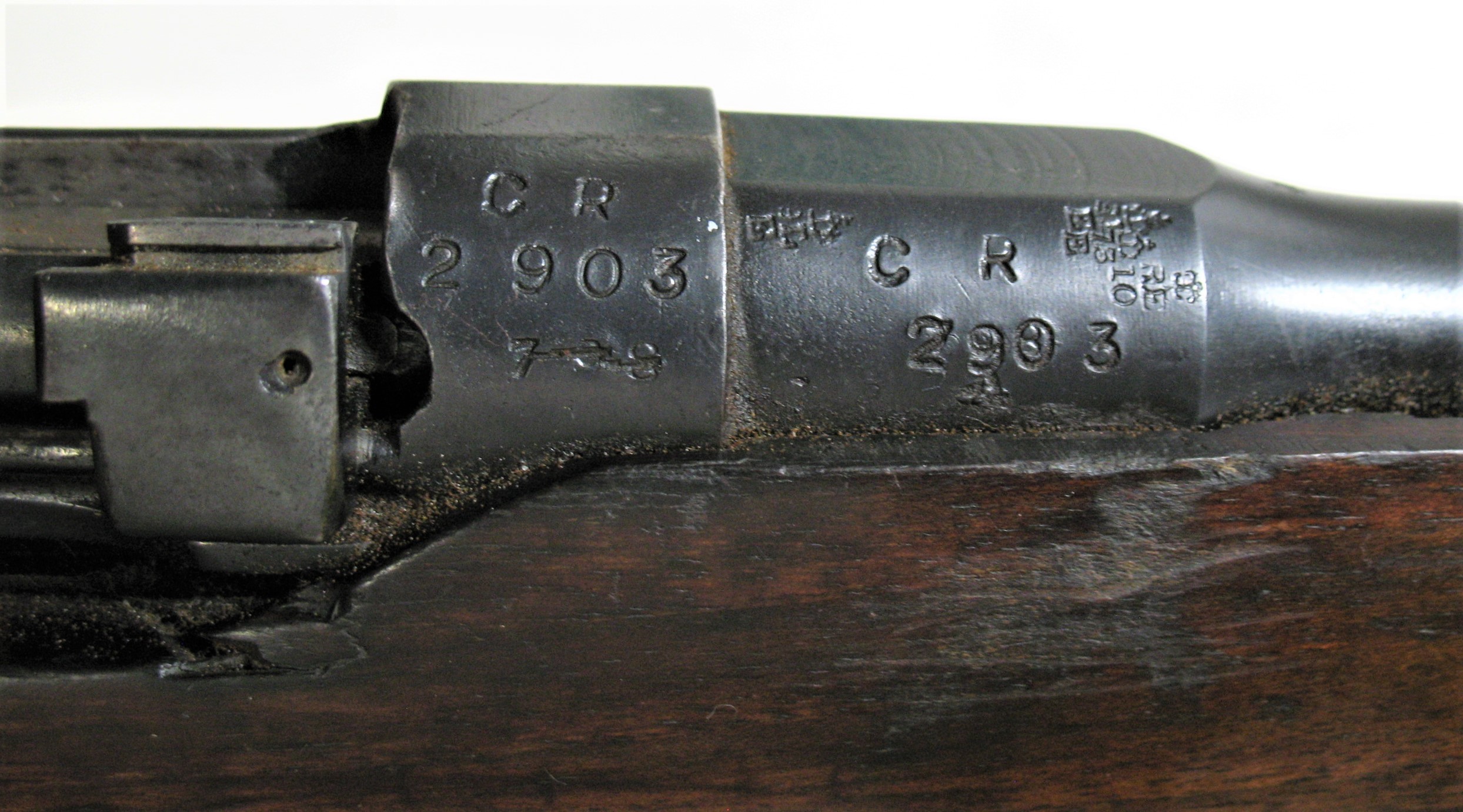

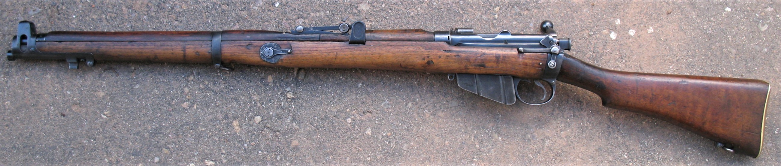

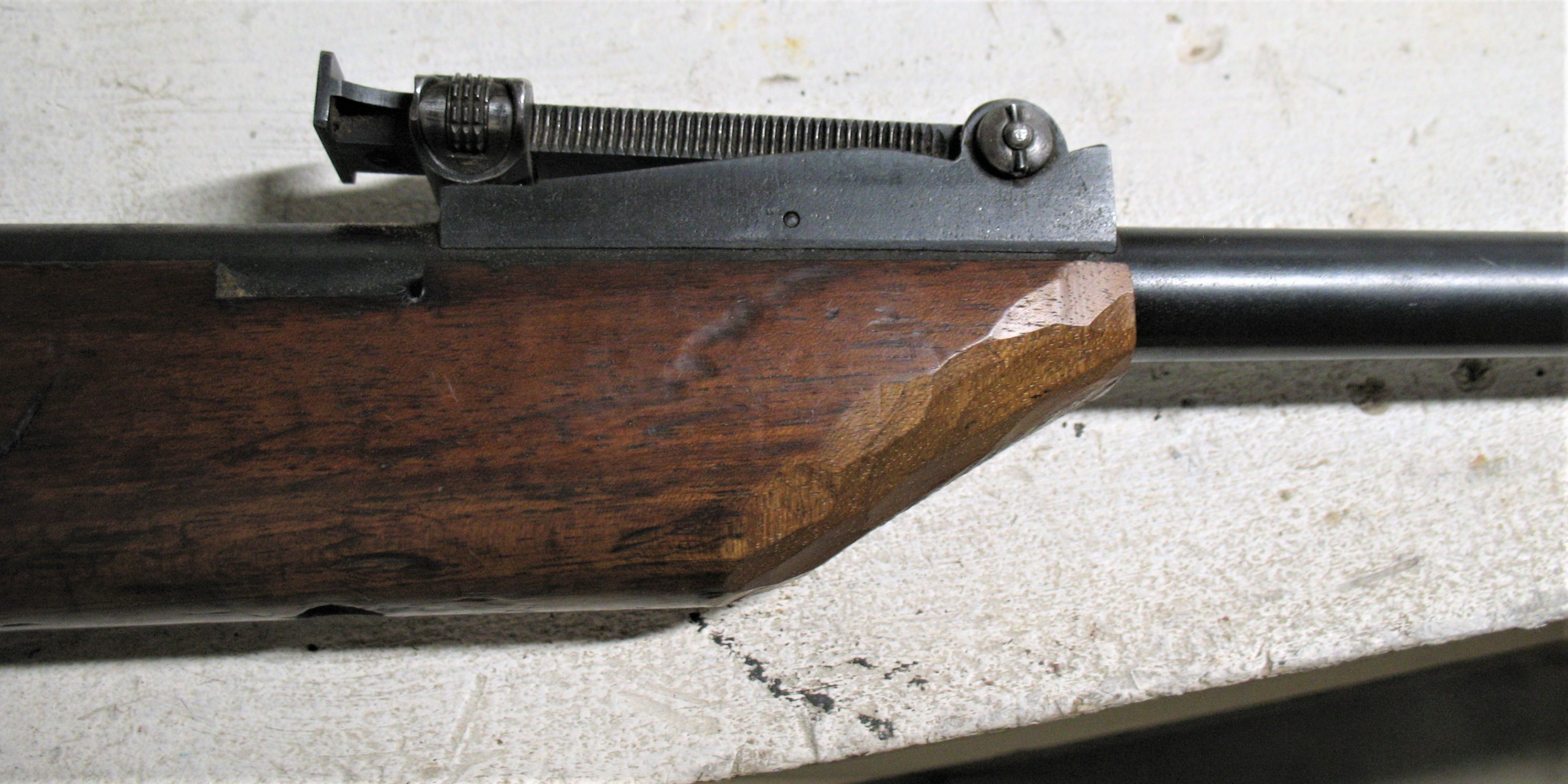

Well, I made it exactly 17 days into 2022 before breaking that resolution. The owner of a local gunshop called me and said he had a sporterized Enfield for sale. He said it was an Indian produced rifle. I was mildly interested until he said it had a "weird peep sight" that folded along the left side. This immediately got my attention. I asked if the rifle had a charger bridge, and he said it didn't. I asked if the serial number began with a CR, an ER, or a G. He said it was a CR prefix serial number. Later, he texted me pics, and I couldn't believe my eyes; it was an Ishapore Mk I* IP later upgraded to I***, made in 1908. Only approximately 3000 were ever made. I made it over to his shop and wound up buying it for $300.

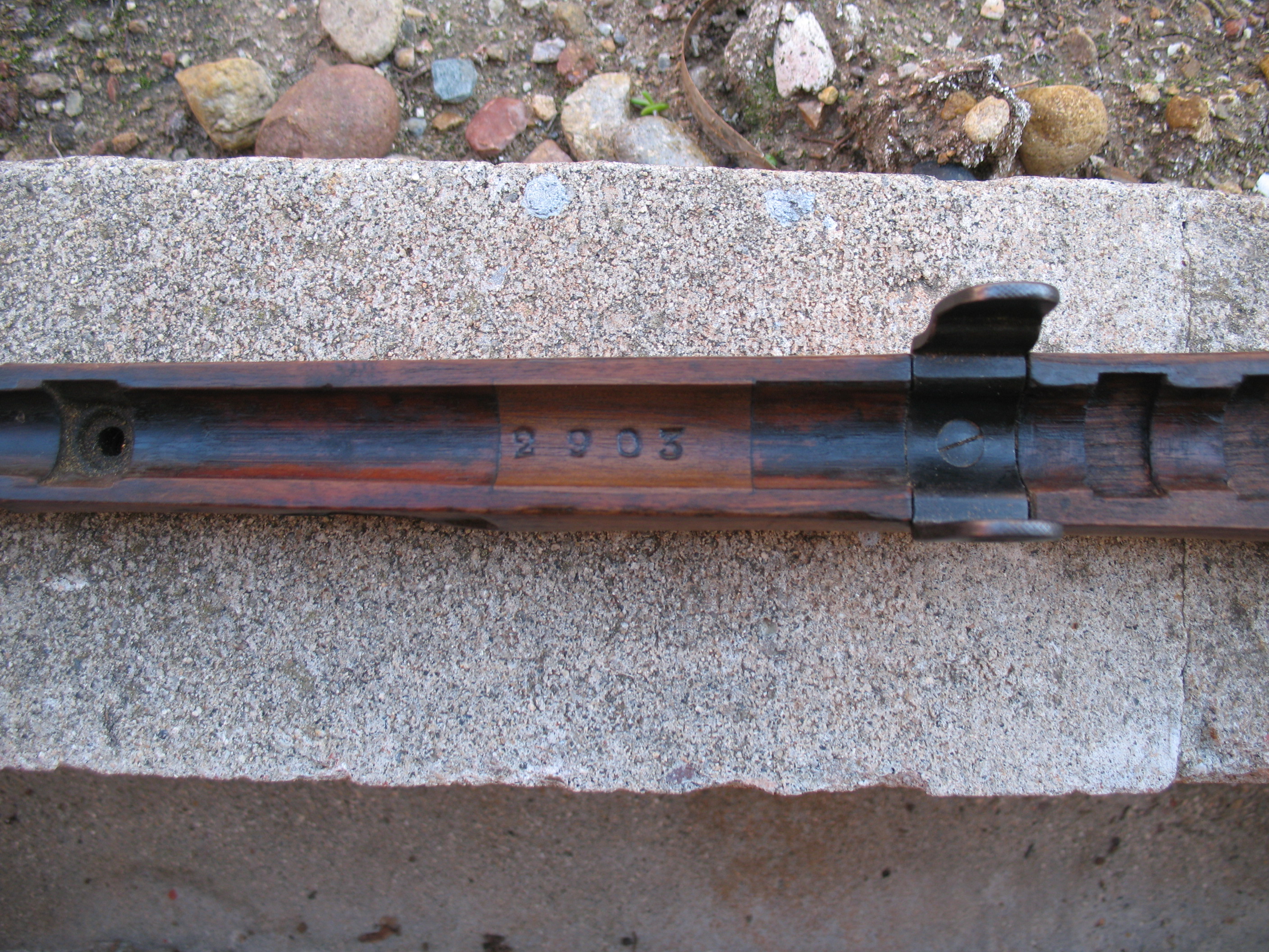

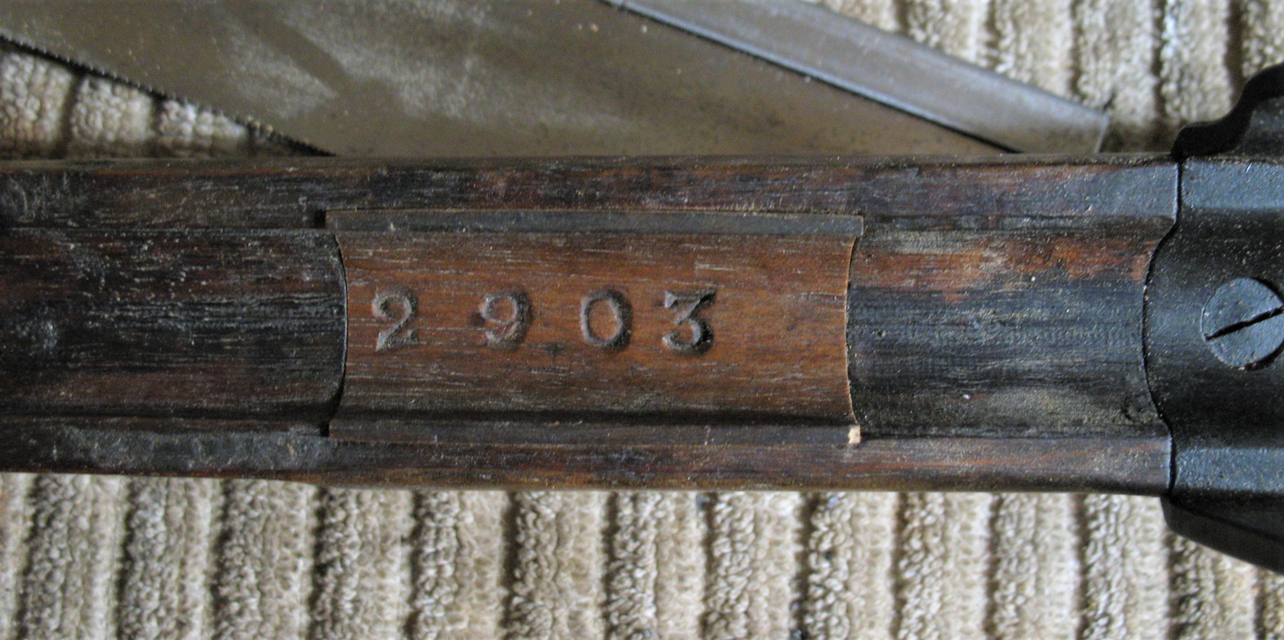

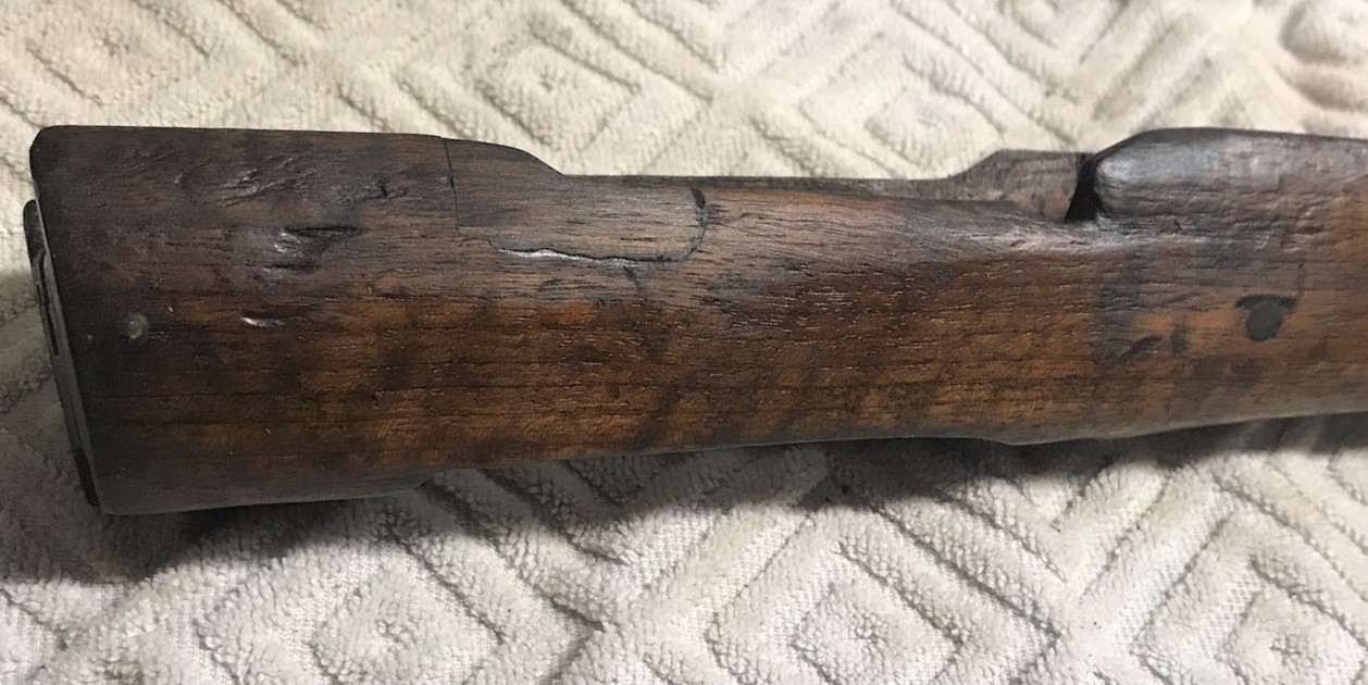

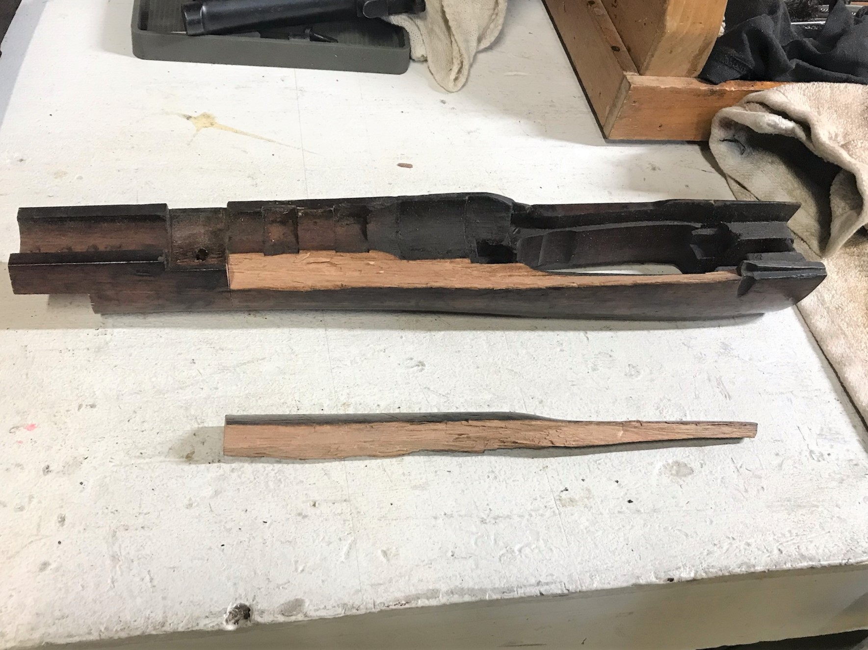

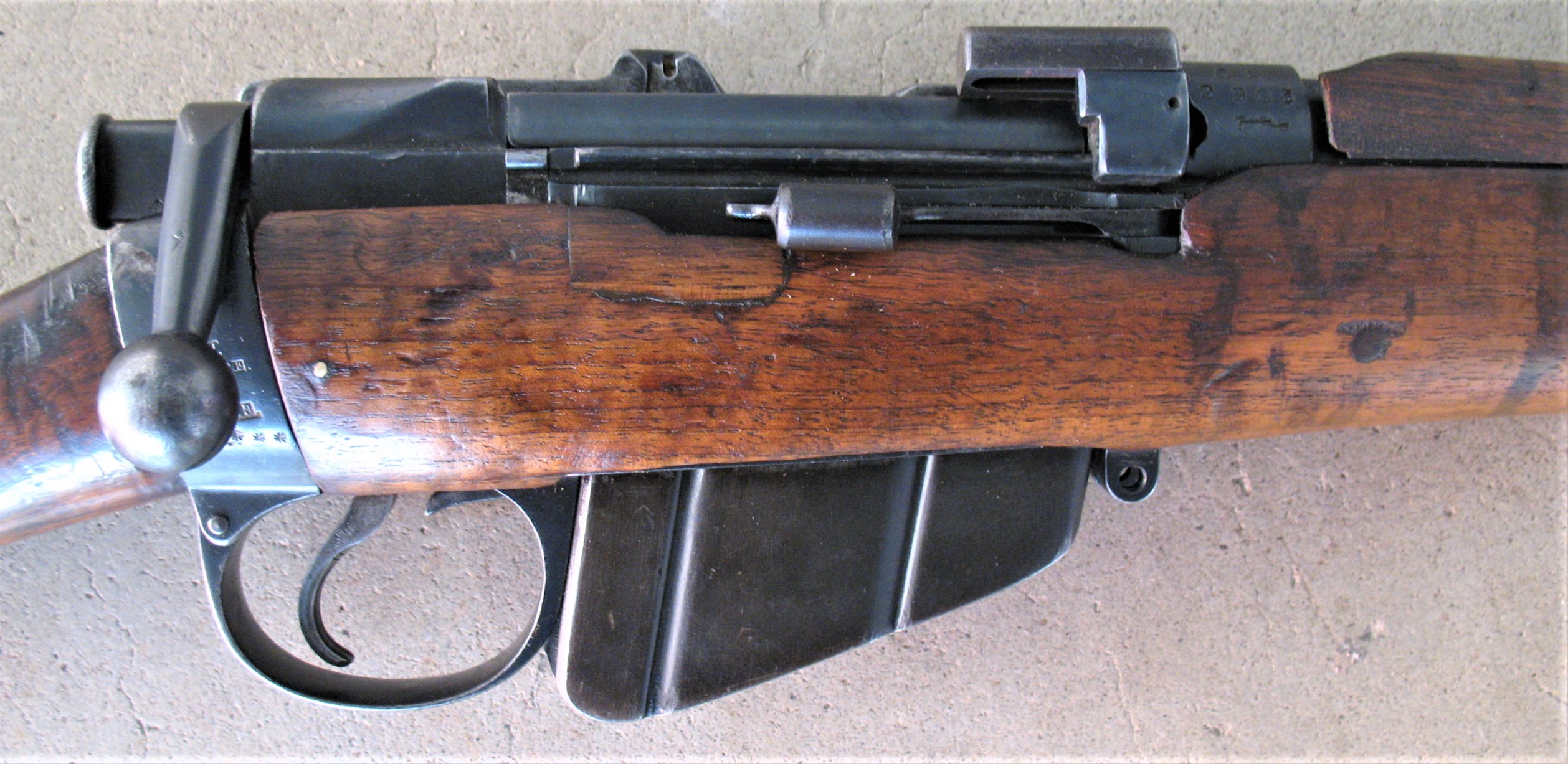

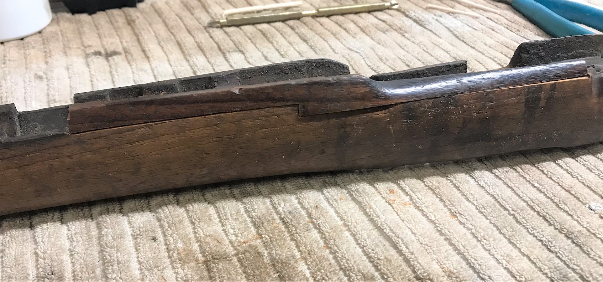

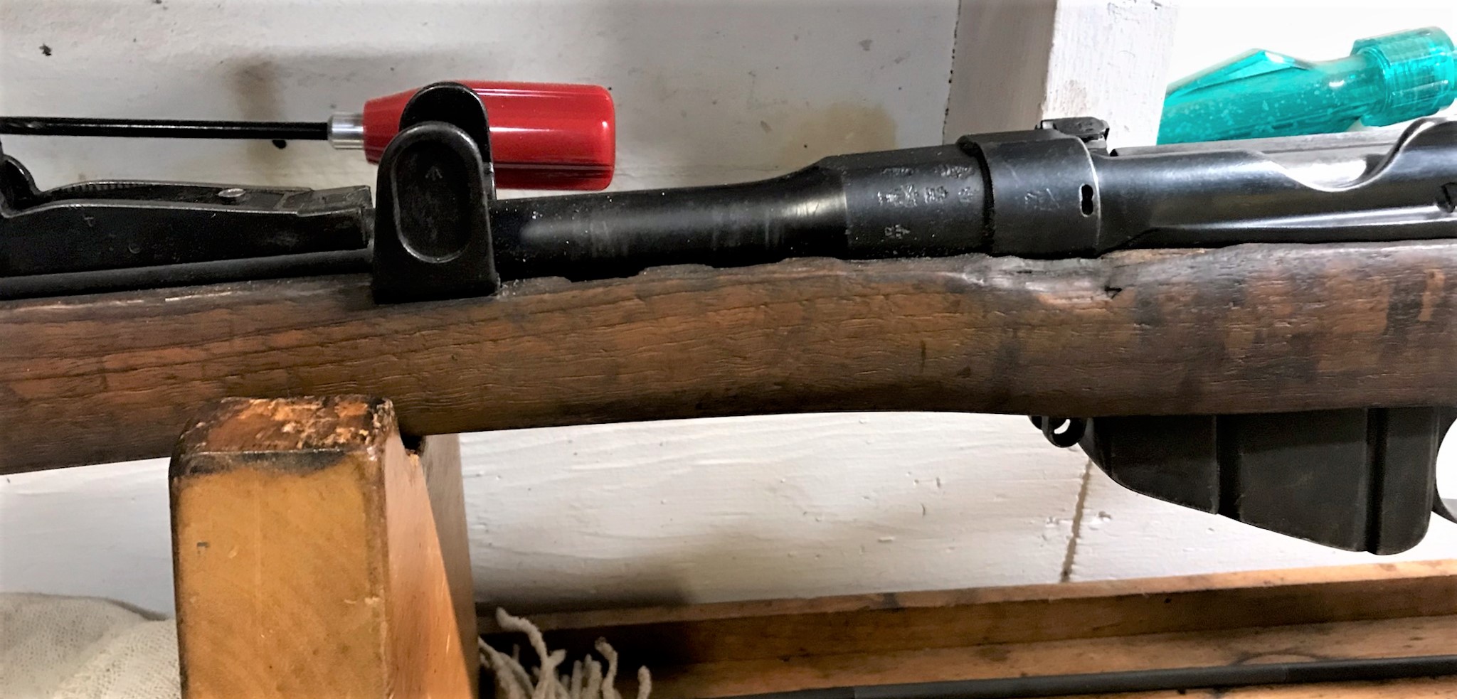

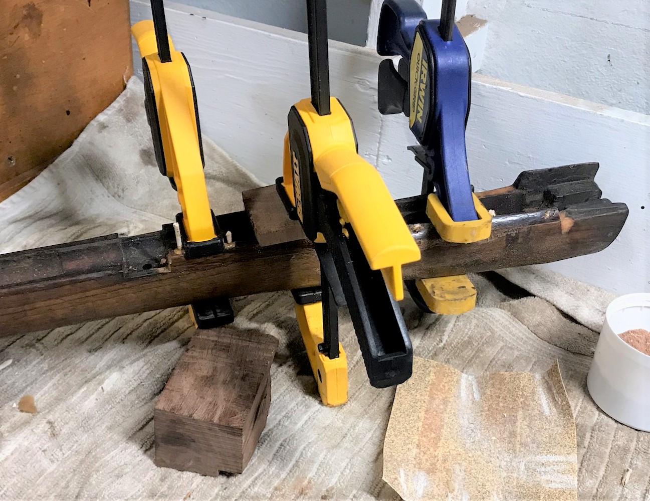

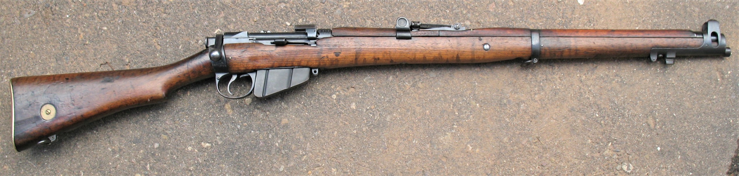

Unfortunately, it had been horribly sporterized. The forend was in awful shape. When I took it apart, I saw the draws were pulp, so I knew I wasn't going to be able to salvage it. It was also missing the sliding charger guide for the bolt, the volley sight plate, a magazine, and other small parts. I had most of the parts needed (magazine, Mk I nosecap, cut-off). I also had an SMLE Mk III forend with volley sight cut-outs I had been hoarding for about 30 years. I pulled this out of the garage rafters and remembered why I hadn't used it earlier; it was in dire need of repair. So I set about repairing the cracks, draws, and patching in missing wood. I thought it was a shame to lose the original serial numbered forend. So I cut out the serial number, and used it as a patch in the stock where the SMLE Mk III sight base would normally occupy. I was able to source a sliding charger from a fellow collector, and between my spare parts bin and Apex Gun Parts, I was able to get this rifle back to looking like it should. As the CR-prefix Mk I***'s had many Mk III characteristics, it does look the proper part.

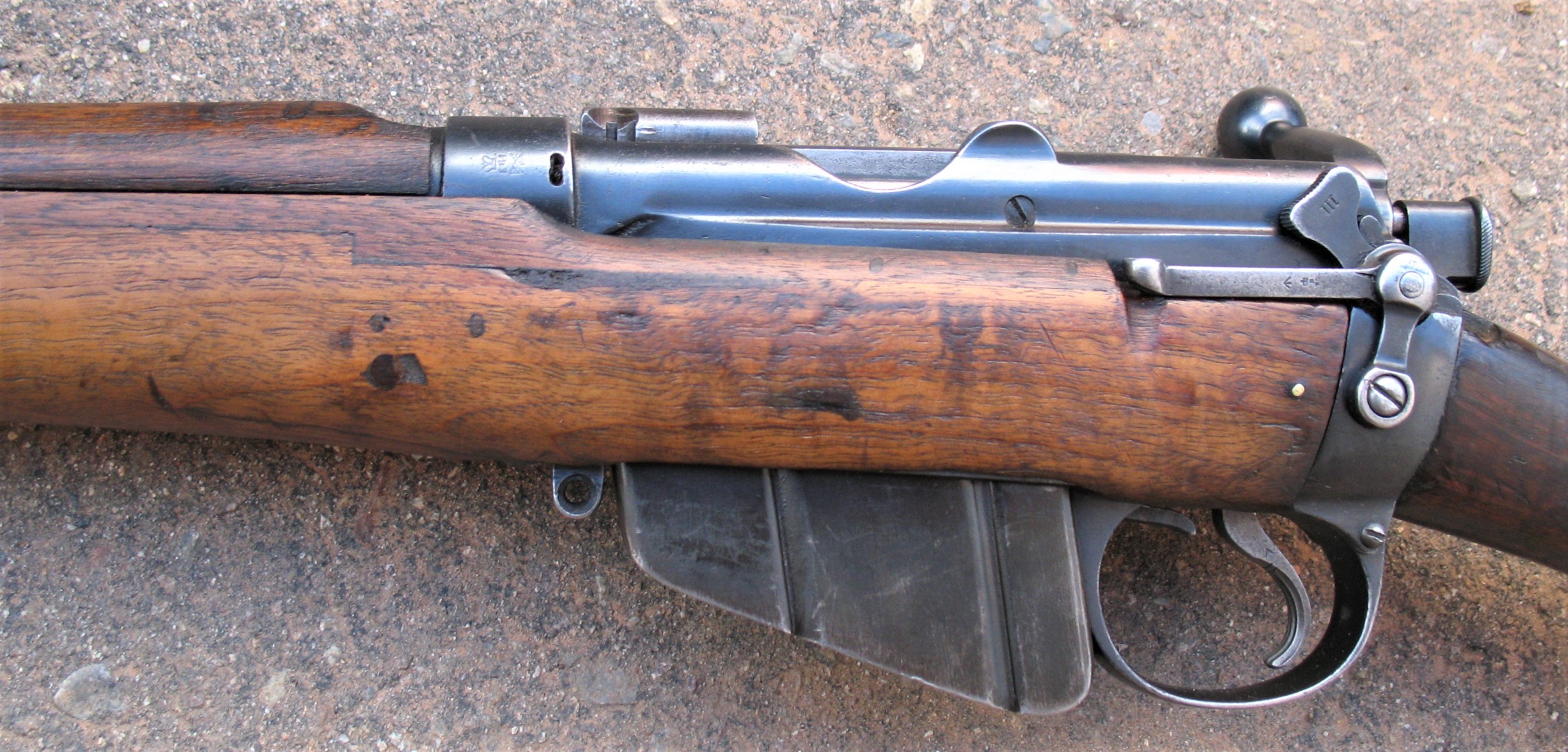

Attachment 124704Attachment 124705Attachment 124706Attachment 124707

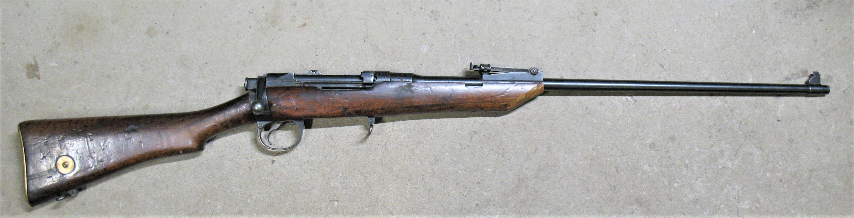

The rifle as i bought it.

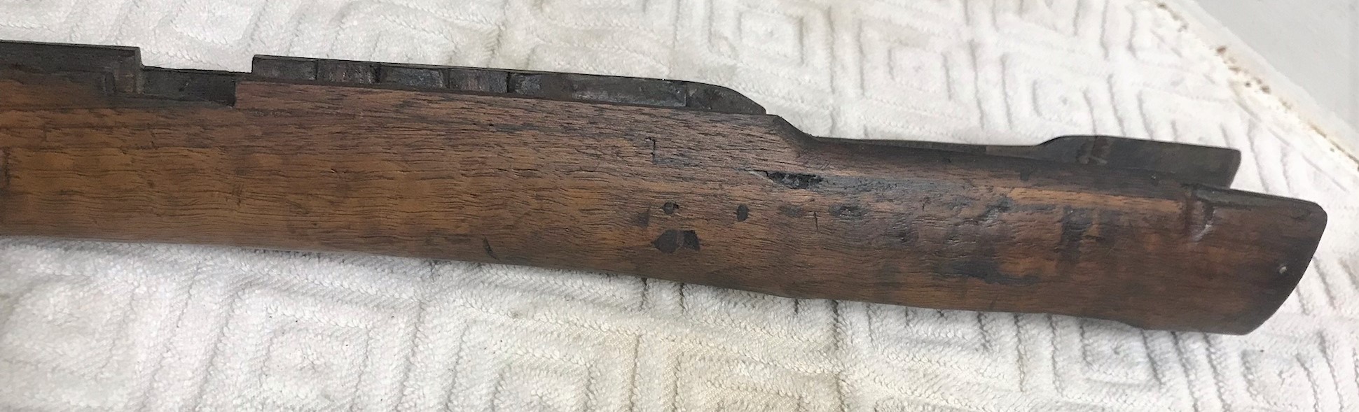

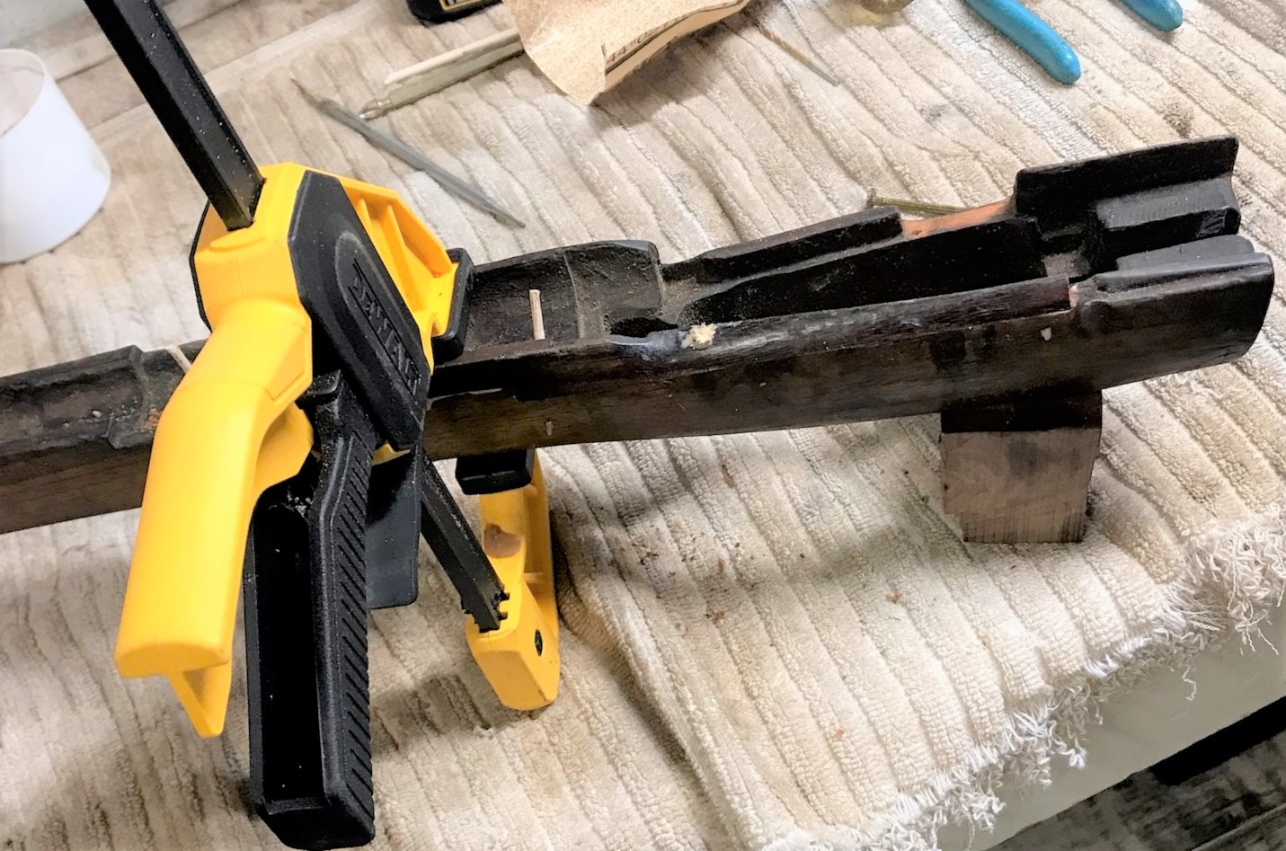

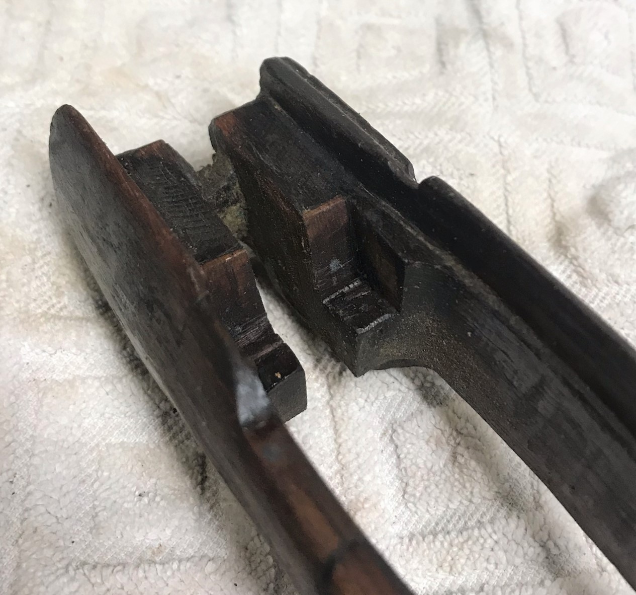

Attachment 124708Attachment 124709Attachment 124710Attachment 124711Attachment 124712Attachment 124713Attachment 124714Attachment 124715Attachment 124716Attachment 124717Attachment 124718Attachment 124719Attachment 124720Attachment 124721
The wood repair, replaced draws, and patches.

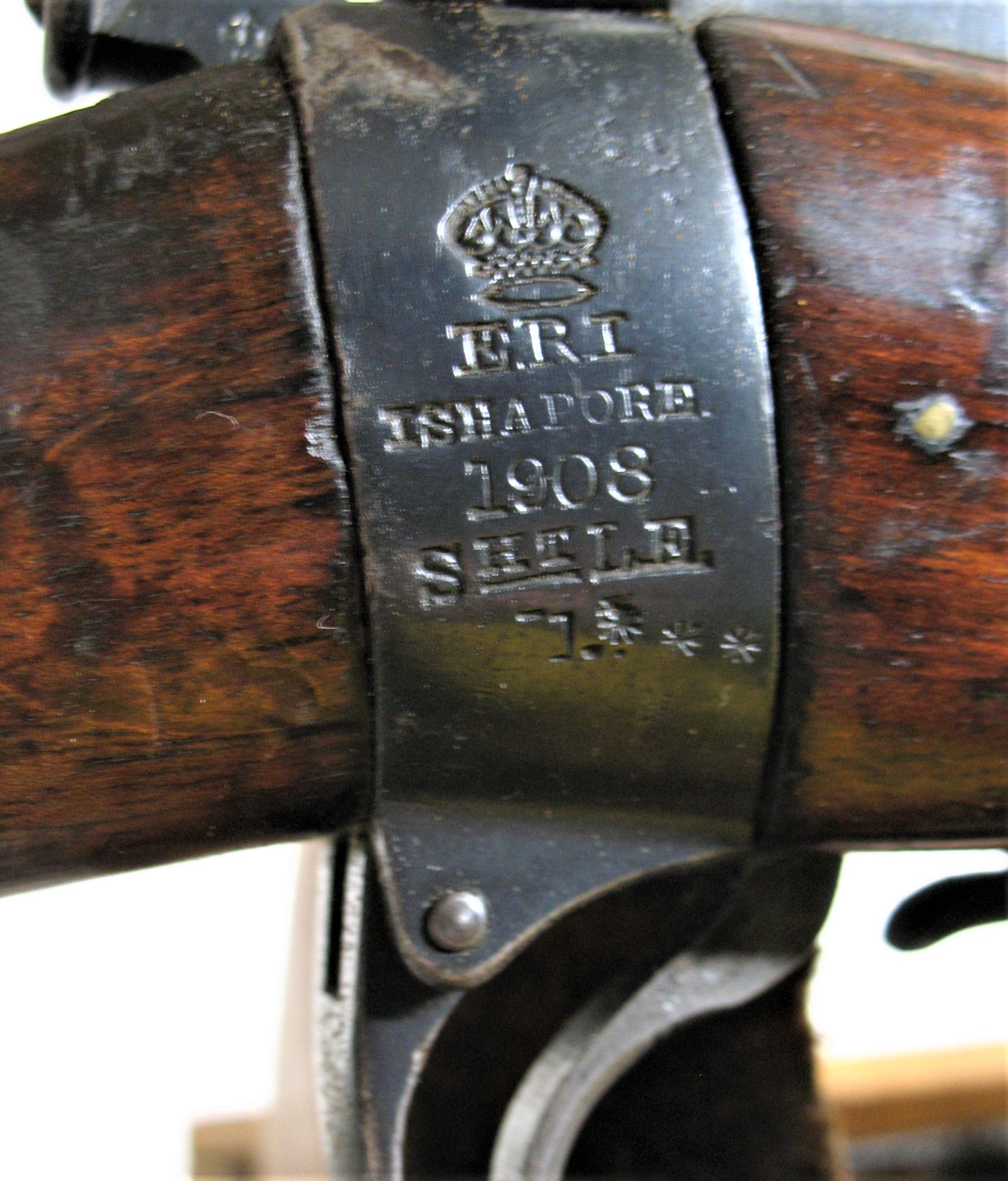

Attachment 124722Attachment 124723Attachment 124724Attachment 124725
The completed rifle
Great work.
My favorite part of the whole restoration is how you save the original Mk I*** serial number.
