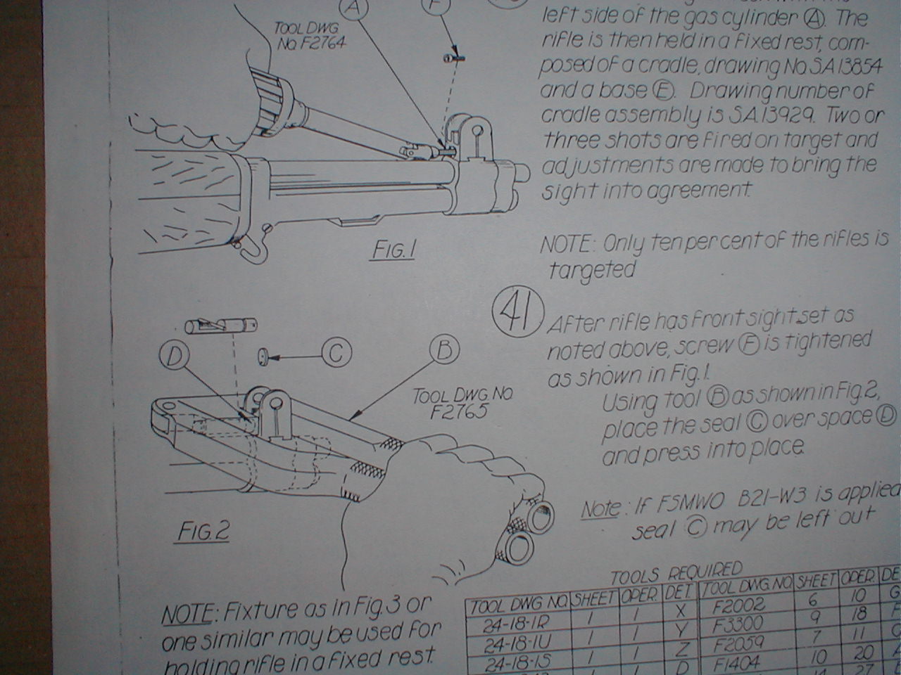

1 Attachment(s)
front sight seal installation tool
Here is a photo from the Rock island Arsenal Shop Manual 1943 showing the tool used to install the front sight seal. This tool if found today would be quite rare !Attachment 126116
Later the wide base gas cylinder and deleted front sight seal provided additional adjustment
