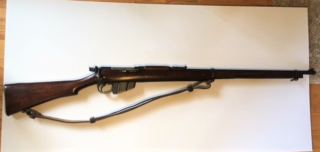

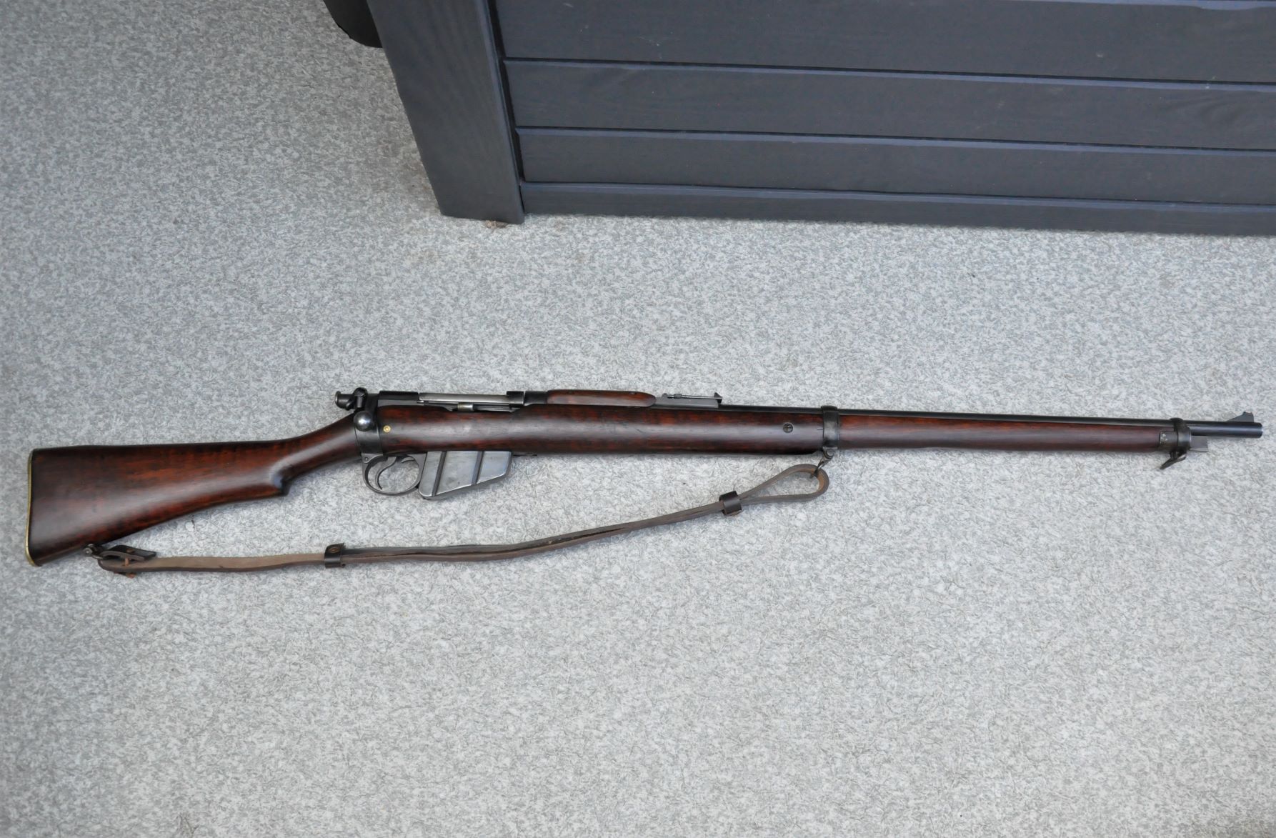

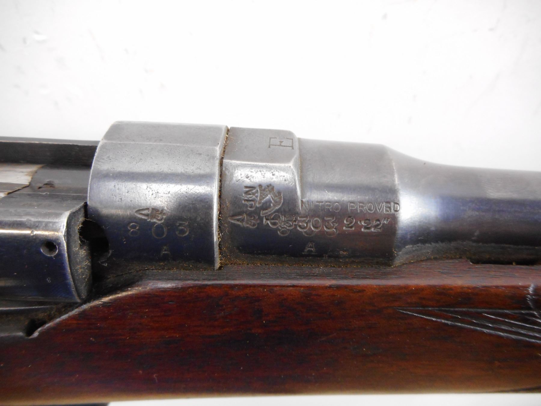

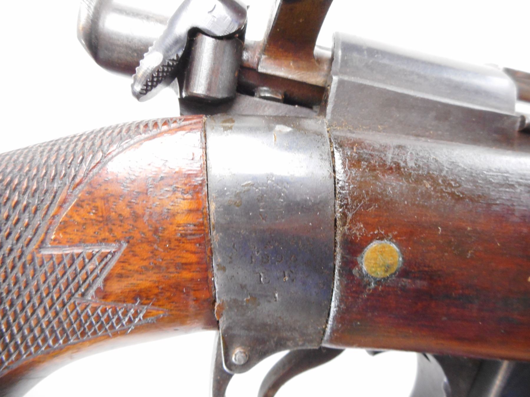

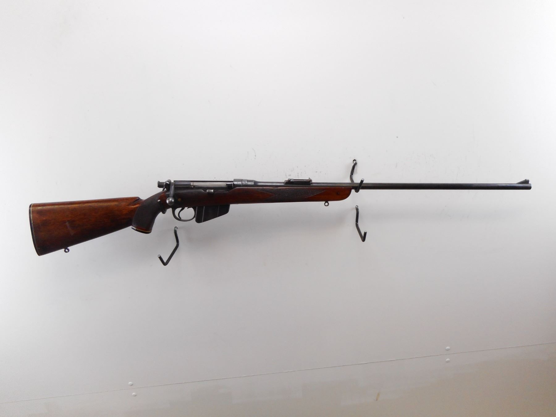

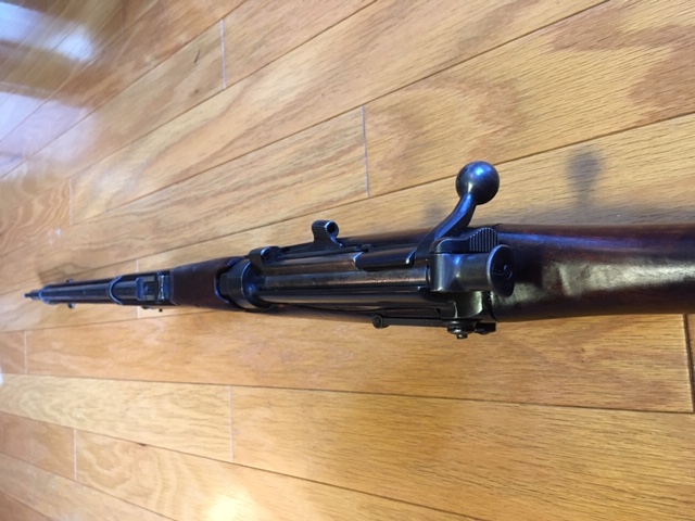

I've wanted an Long Lee for ages, but the prices for the good ones were beyond reach for me. I managed to get a sporterized 1896 BSA MLE with an OK bore, which seemed to be a manageable project for me. Little did I know!
Attachment 128030Attachment 128031Attachment 128033I
The barrel has been cut which I can't do much about, and I was soon to discover how hard replacement parts are to source ... even repro ones.
Off the top of my head here's the list of things that I did for this project.

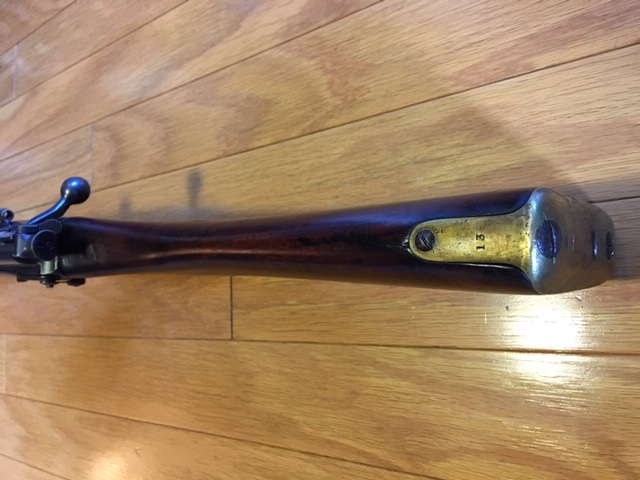

-Replacement buttstock (a used original with butt plate stamped "13" potentially the Royal Hamilton Light Infantry originated in Hamilton, Ontario on 11 December 1862 as 13th Battalion Volunteer Militia (Infantry).
-Replacement of forestock with shortened used forestock that needed a duffel cut for the hand-carved front piece that I added. Join is hidden beneath the barrel band.

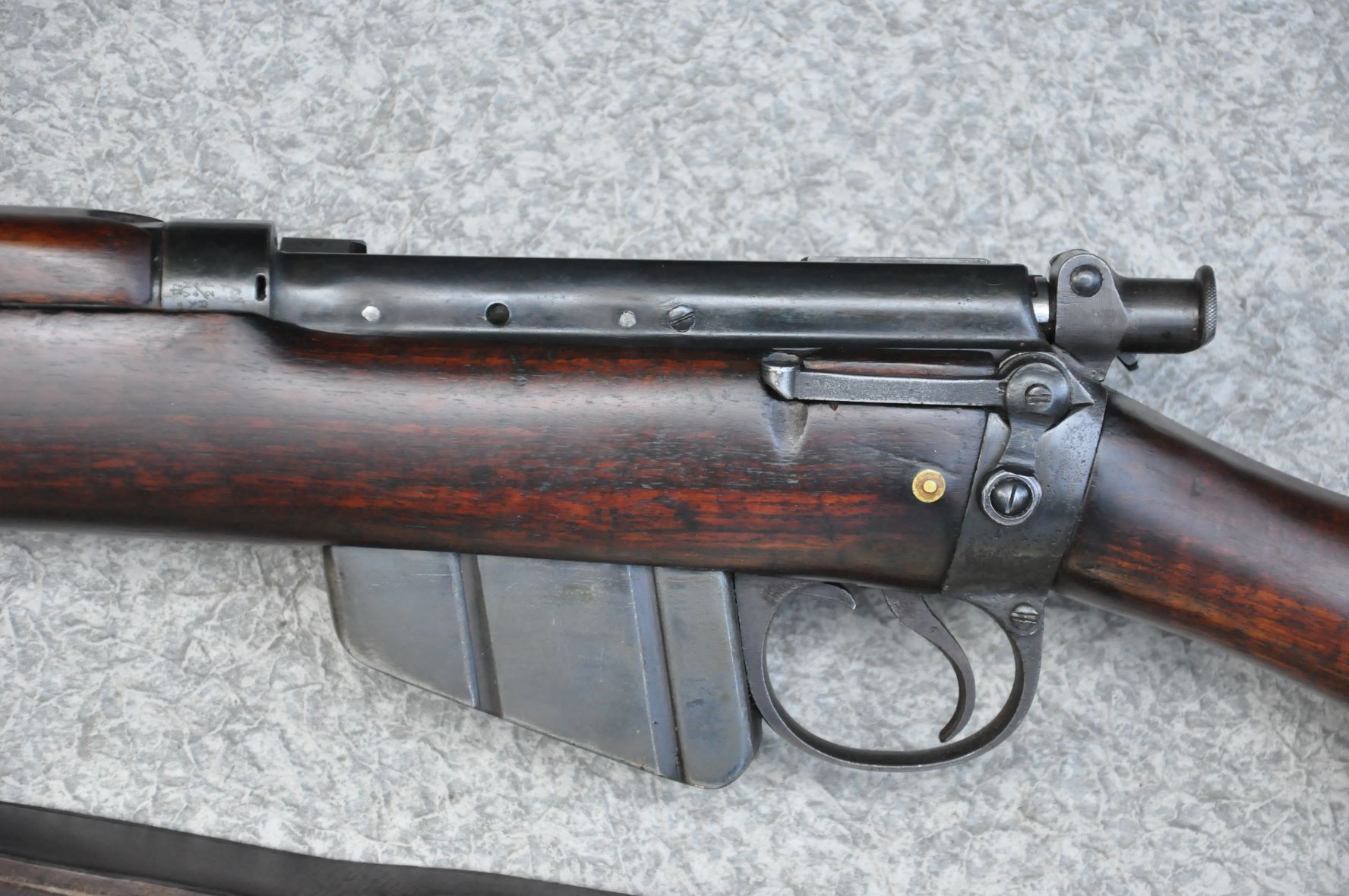

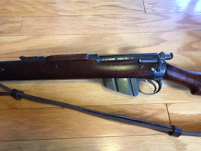

-Hand carved top wood, my original source was not able to provide one, so I made my own. with spring clips and rivets adapted from SMLE parts.
-Sling swivel welded back onto barrel band that was found at a gun show.
-Front band and bayonet lug sourced at gun show, but turned out to be from a Remington Lee which I think is a pretty close match.
-Fill scope holes (i chose poorly on material which wouldn't accept cold blue)
-Drill and tap filled rear volley sight holes and mount replacements.
I'd still like to find a dust cover, but this is pretty much done. It's not my best restoration work, but I'm pretty happy and it was certainly a challenge.
Enjoy.

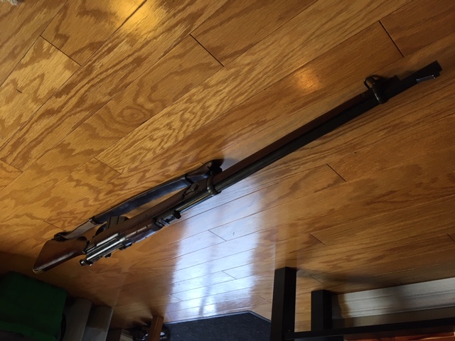

Attachment 128024Attachment 128025Attachment 128026Attachment 128027Attachment 128028Attachment 128029Attachment 128032
And the best part is she shoots? Nicely done!

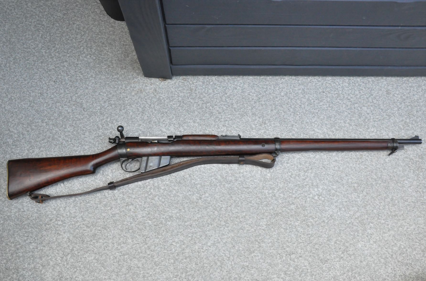

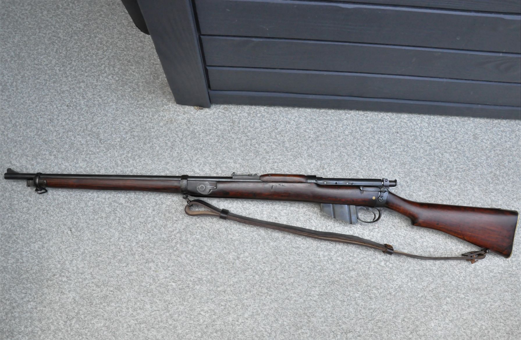

5 Attachment(s)

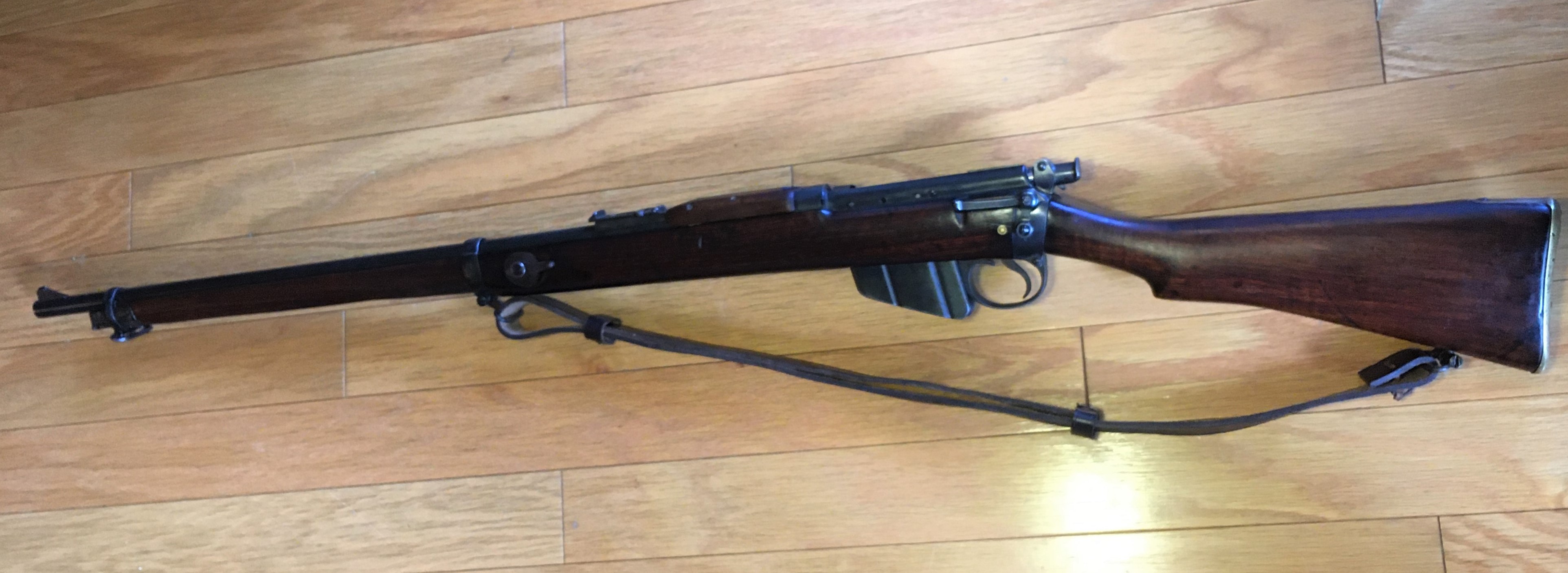

Some better pictures added.
