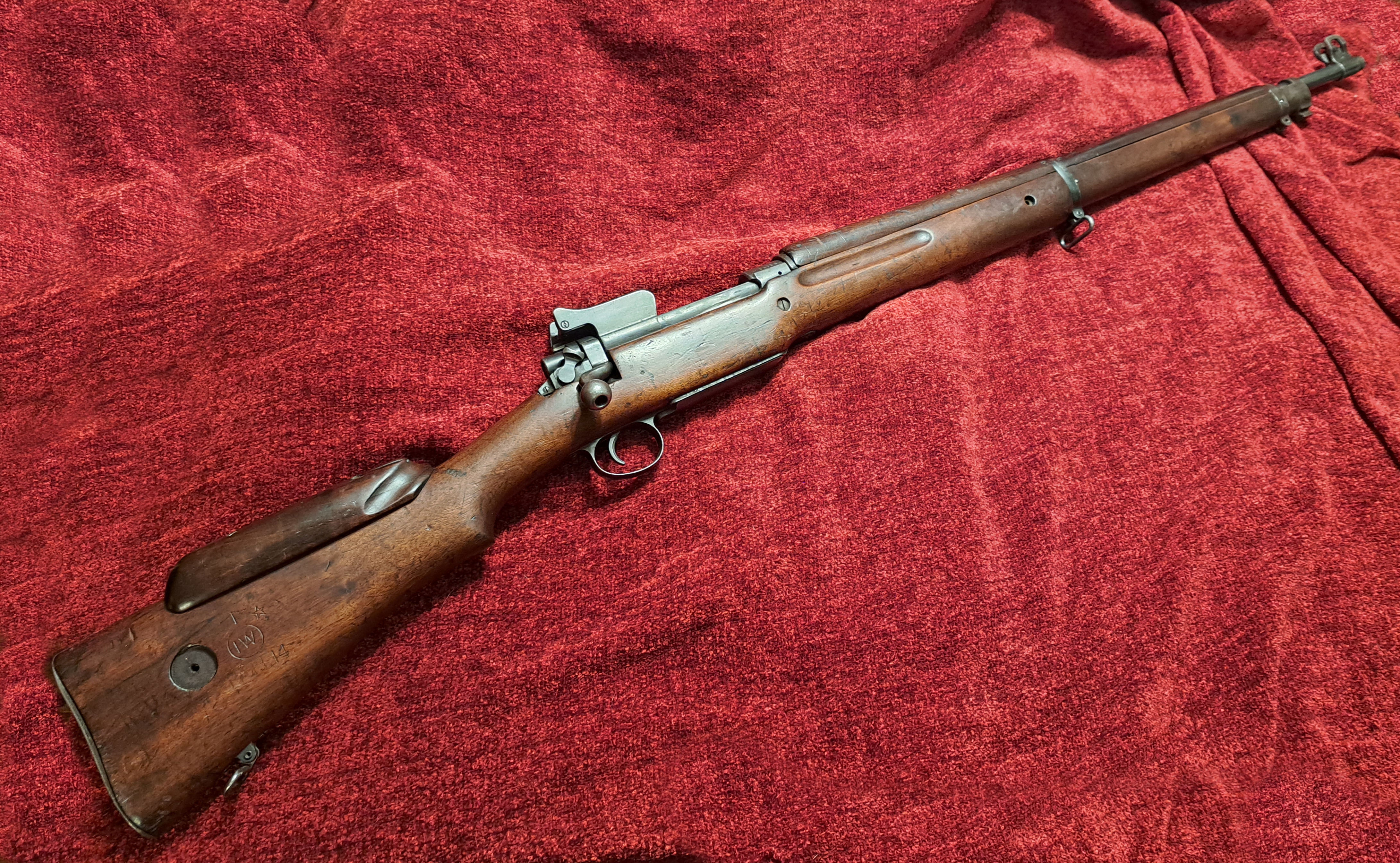

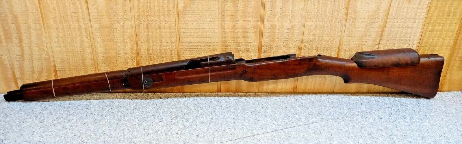

Hi Guys, A number of years ago I acquired a nice P14 Winchester all matching sporter and set at trying to find an original wood stock to restore it into. I recently acquired one, but believe I probably didn't get exactly what I was looking for. (I have attached some pictures of both the stock and the re wooded rifle). What I think I have is a stock that was modified during WWI to mount an Aldis scope. What I'm looking for I guess is confirmation that I still have to continue looking.
Attachment 128855Attachment 128856Attachment 128857Attachment 128858Attachment 128859Thanks in advance.
It looks like you have a stock set off a Rifle No3 Mk1* (T) A. It is not off the 'common' P'14 sniper rifle that bears the Model 1918 scope on over bore claw mounts, but from one of the 421 rifles set up by Alex Martin in early WW2 using Great War rifles & Great War Aldis scopes (Aldis for the most part, a few other types of vintage WW1 scopes were also fitted).

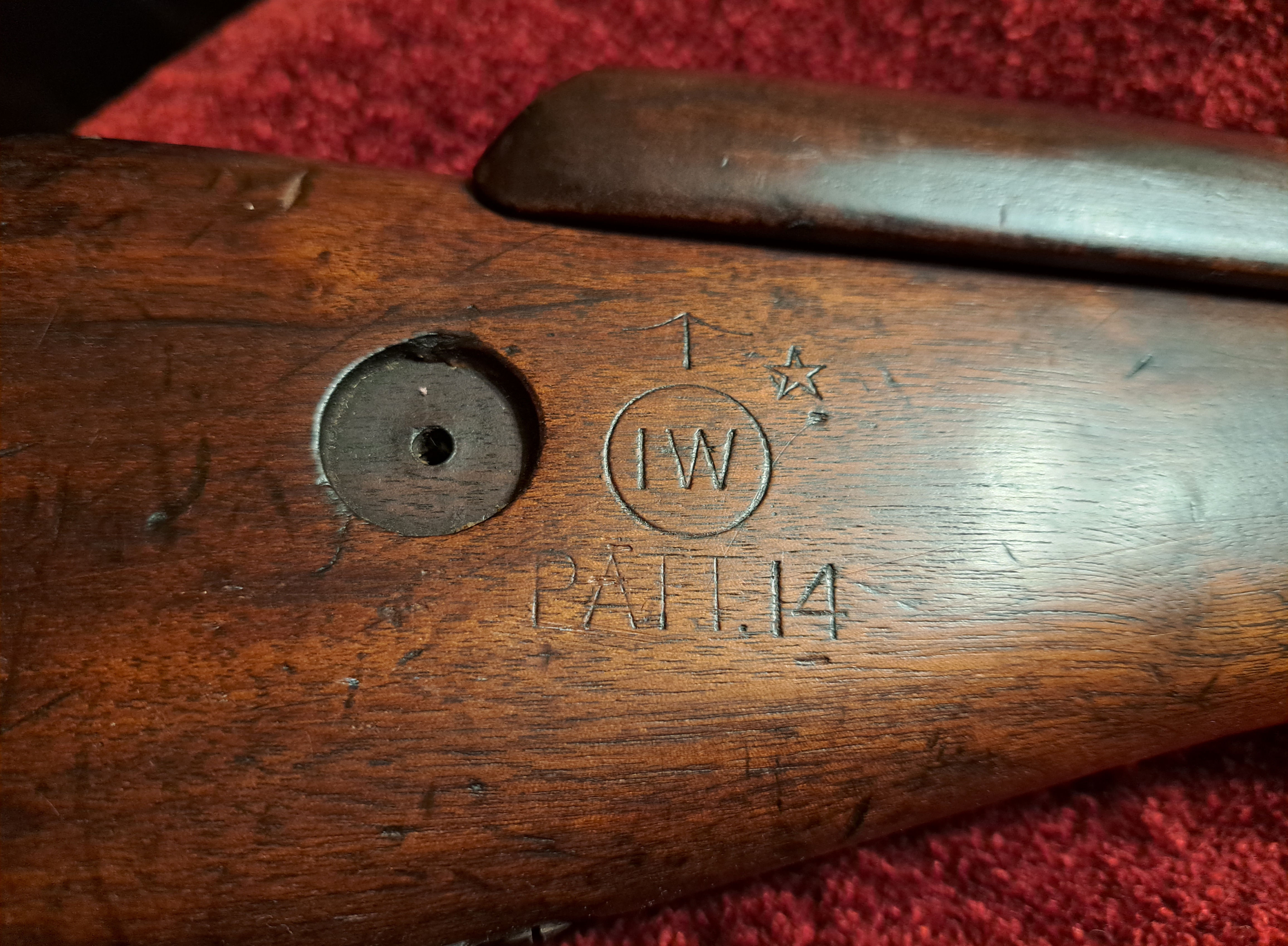

Then why does it say Patt.14 on the buttstock?
Because the stock was originally made (& marked) in 1916/17 when the official designation of the rifle was the Pattern '14. The system changed in 1926 when the P'14 rifle became known as the Rifle No3. The two orders for the sniper conversions for which the OP has the woodwork were made in 1940 & 1941, & the correct designation had become the Rifle No3 Mk1* (T) A.

Could use that stock set alright. Would love to see the inside of the stock where the front bracket would sit around the barrel before it protrudes out through the handguard. I'm guessing the woodwork is relieved in that area. One day I'll get my restoration sorted....
