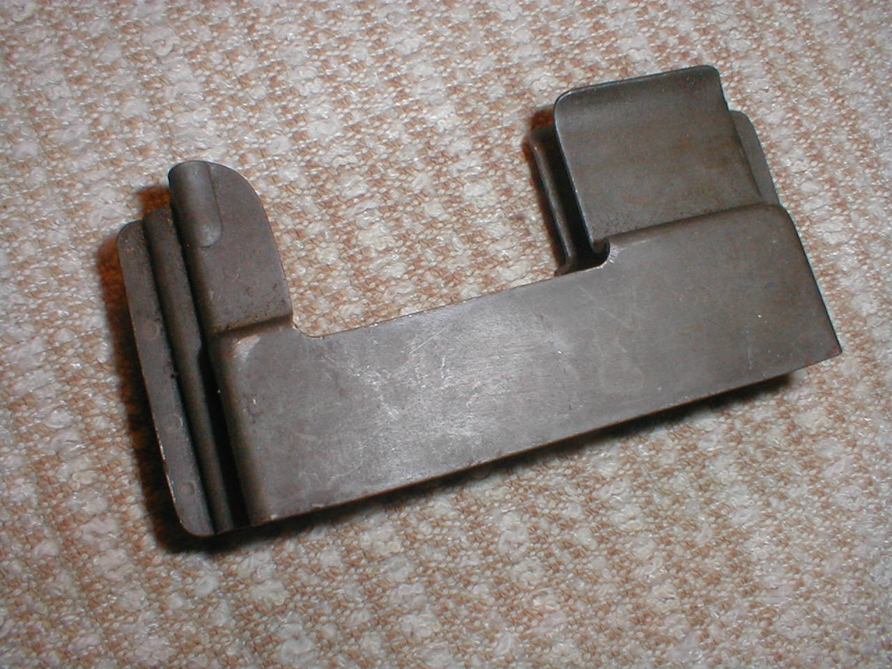

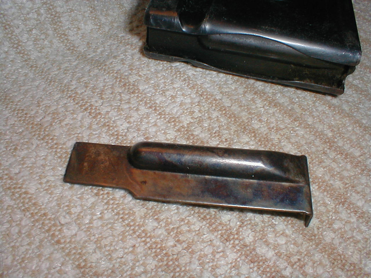

At some point in time, a magazine guide was designed to load 1903 stripper clips into the BAR magazine (I never saw one in service) but do remember M1 rifle clips broken down to load BAR magazines with 16 rounds by hand. Everything was black tip cartridges.

During the mid 1920's both 30rd and 40rd magazines were developed for the BAR for use against aircraft but scrapped during the early 1930'sAttachment 129122Attachment 129123

I had a couple of BAR mag chargers during my ownership of BARs and they have to be the sturdiest made. Heavy and durable, there was nothing disposable about them. Our FN mag charger was just stamped tin.
