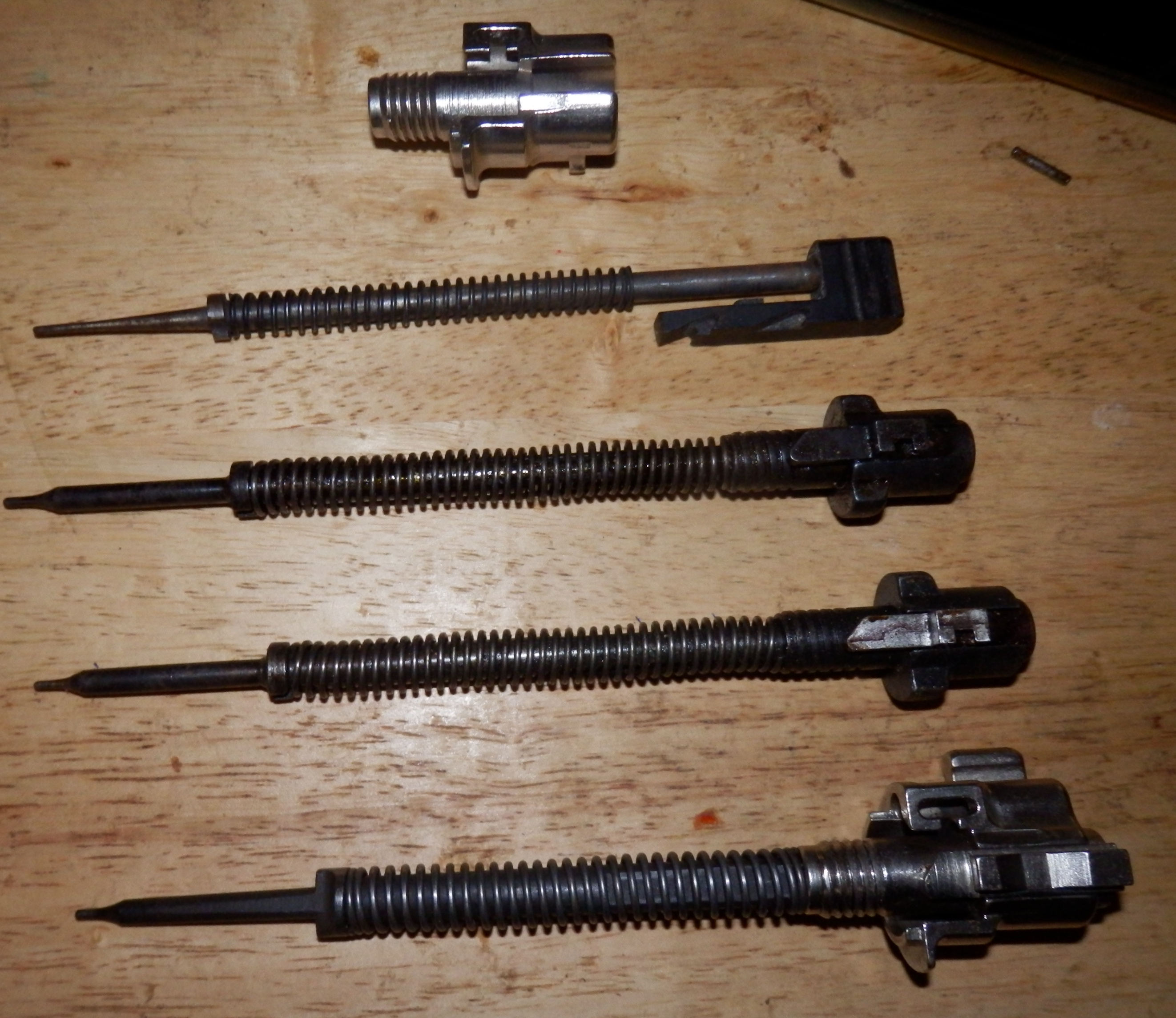

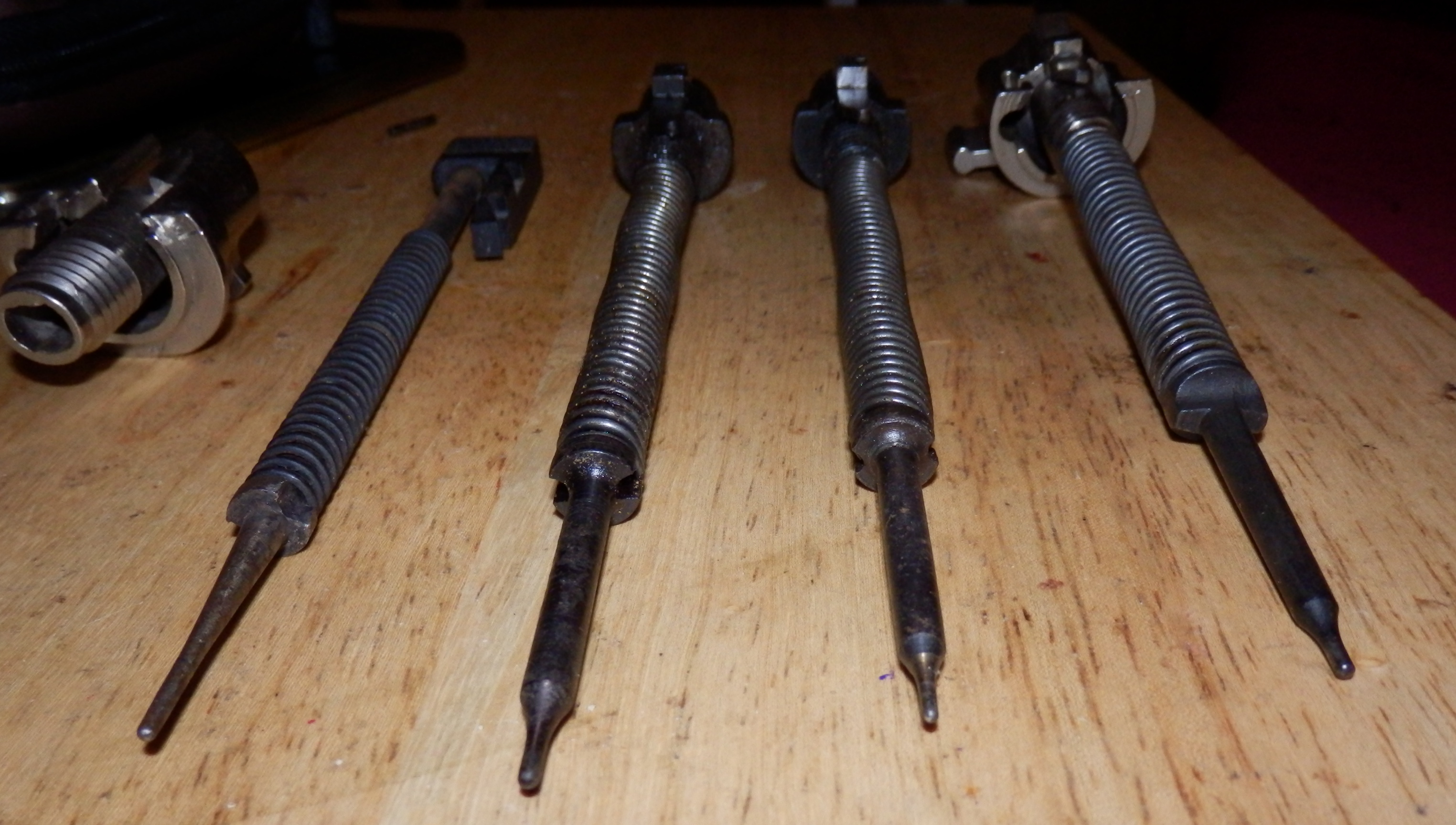

These recently came into my possession but although I've tried to work out what they fit exactly I am still clueless.
They look to be Mauser firing pins but what version...I have no idea.
I have a yugo mauser & a swedish 96...but these dont seem to be either of those?Attachment 130835Attachment 130836

Right photo, top to bottom:
Lee Enfield, probably No. 4.
2 and 3, P'14 or US M1917.
98 Mauser.

Well John it looks like in the side view from the top, stripped South American Mauser 98 bolt shroud, Enfield No4/No5 firing pin assembly, Enfield No3/P14-US Model 1917 cock on opening firing pin assemblies positions 2 and 3, unspecified Mauser 98 firing pin assembly.
I assume it's a South American bolt shroud because it's in the white. Markings will identify it further same with the bottom 98 firing pin.
Position #2 is a M1917 firing as it is the same size as the M1903 Springfield. Position #3 is a Pattern 1914 as the firing is significantly smaller than the M1917. Quite a number of M1917 firing pins were provided to British ordnance and they were machined to Pattern 1914 "specifications".
