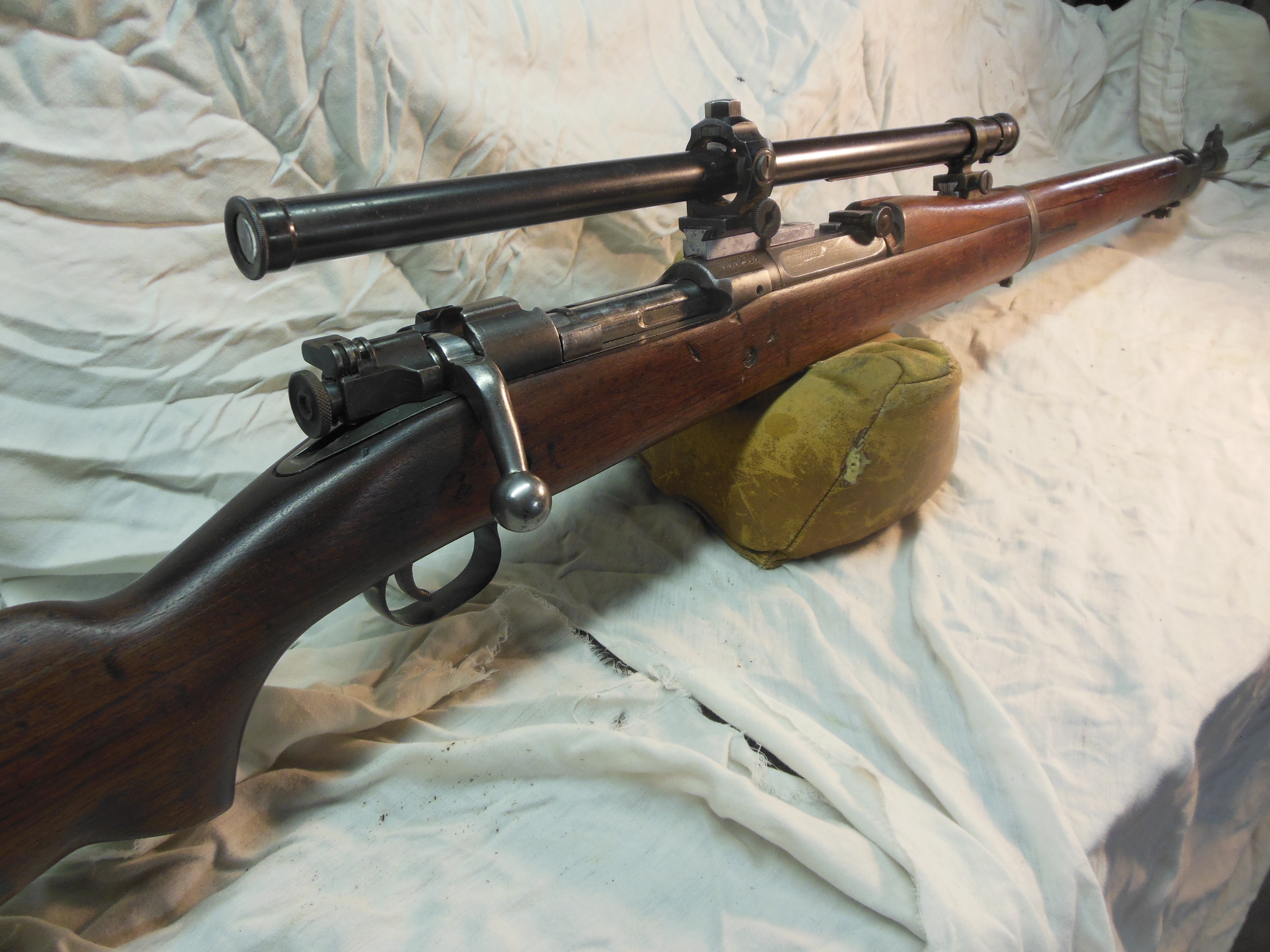

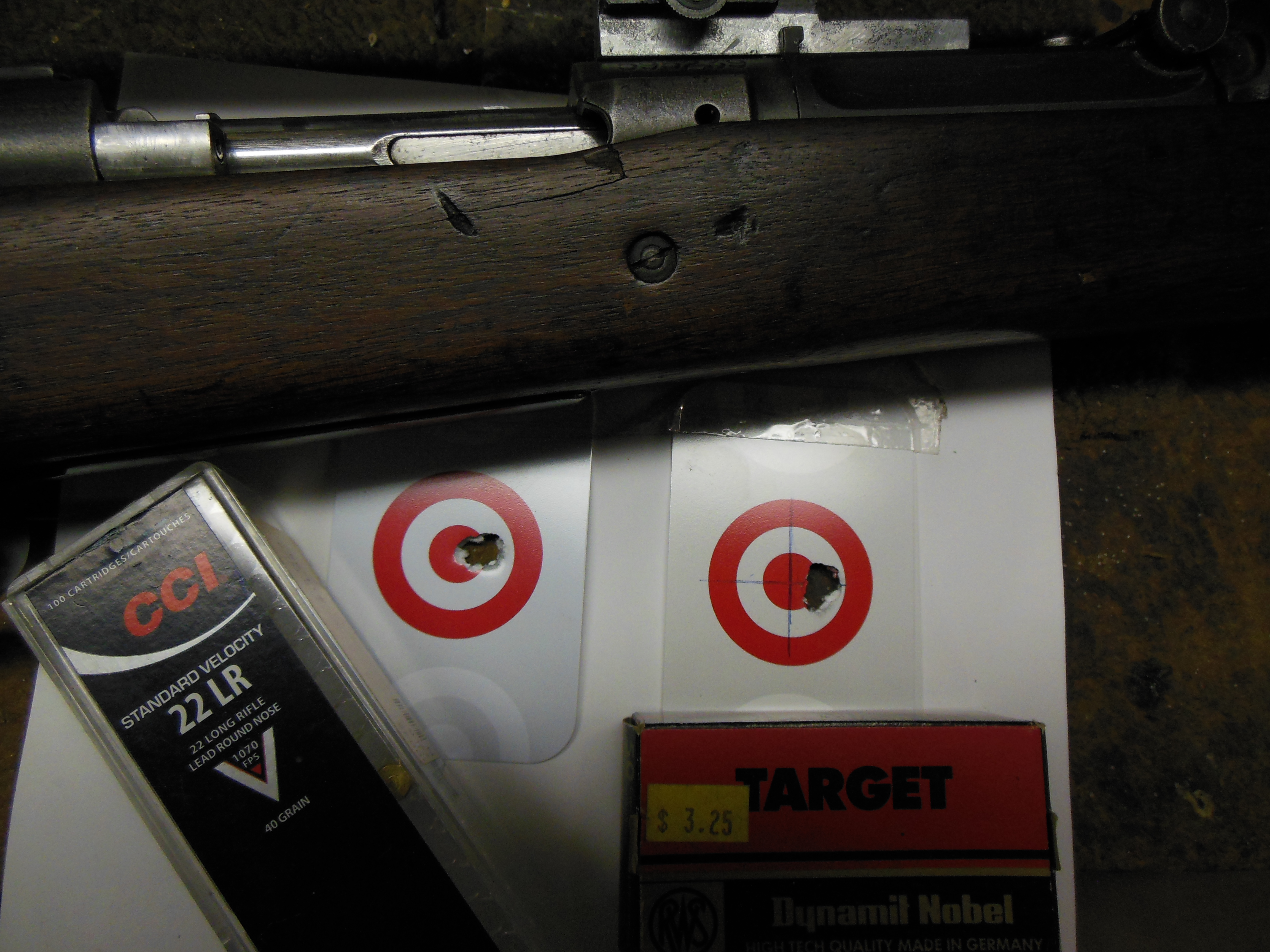

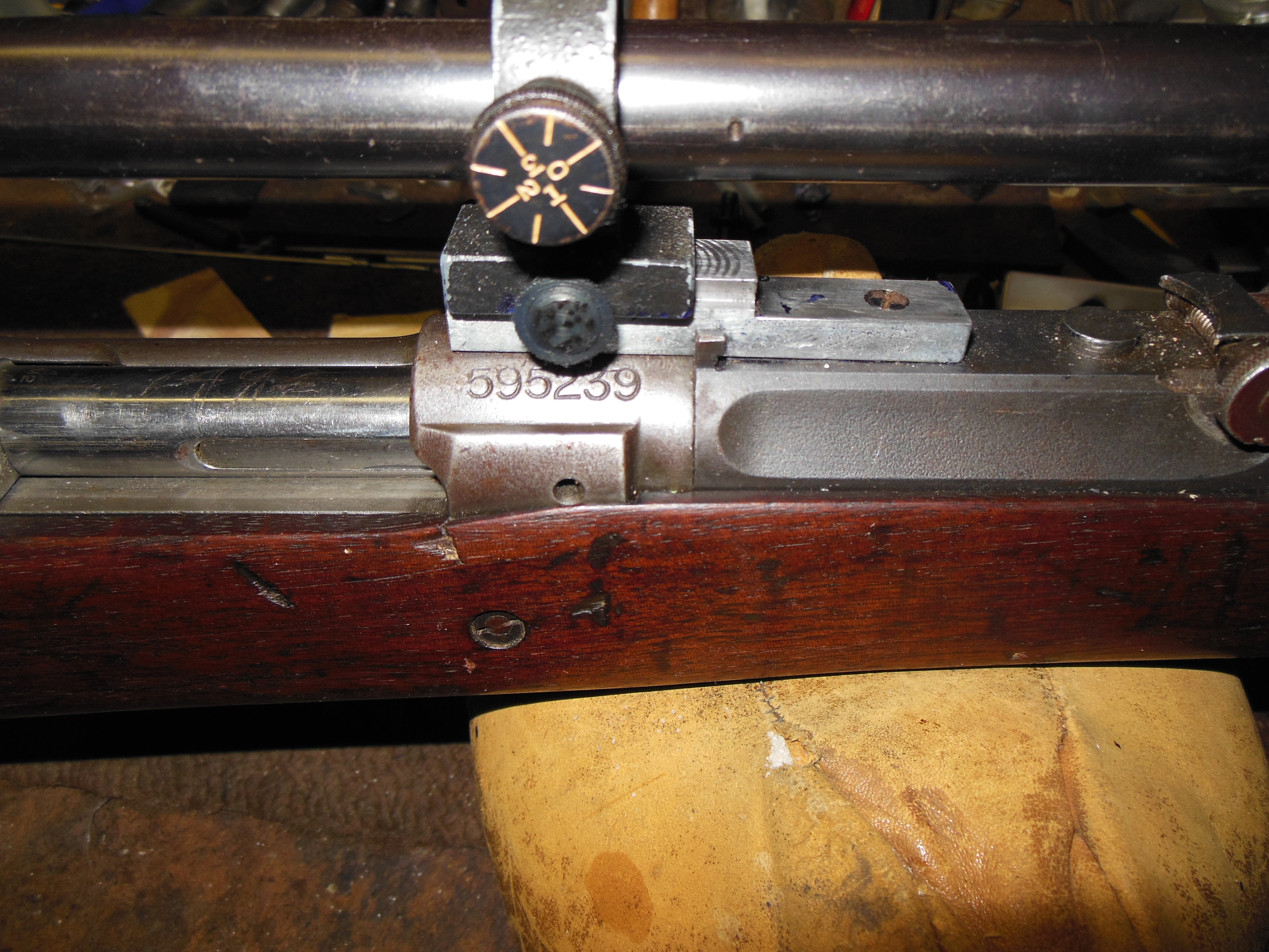

building a 22 RF Model 1903 rifle
You did neglect to show a barrel date and serial number in your posting. Some years ago when the CMP was selling M1903 actions with poor bores for $100 shipped, I bought one, then had a quality 22 rim fire liner with rear extension installed. Also bought a nice M2 RF bolt from a dealer in Ohio. Then I made some scope mounts to use an old Lyman 4x pre war scope, used a Unertl rear mount but the Lyman rear mount was better for this project. Rifle shows potental for accuracy and will test at 50 yards.
The punched 1903 butt plates are around, not really a rare part, stocks are becoming more difficult now. I would think your example was put together Attachment 131964Attachment 131965Attachment 131966
