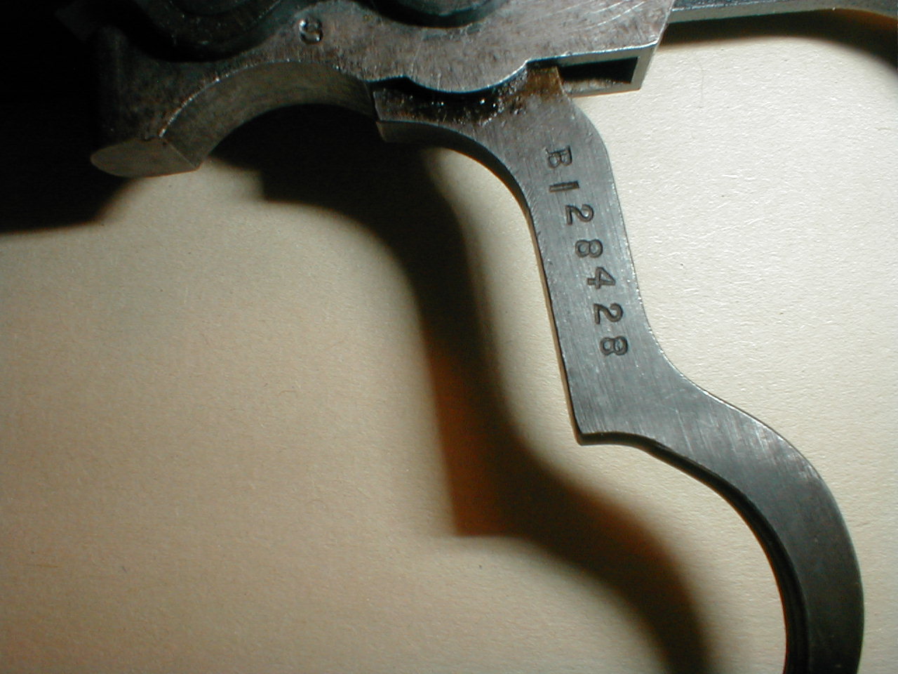

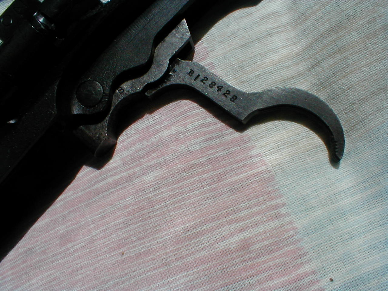

2 Attachment(s)
trigger for M1903A1
This trigger would be correct as they started with the drawing numbers late in the 1930's, NM trigger has different number.
Actually, i have noAttachment 137082Attachment 137083 idea where you find one with the drawing number
