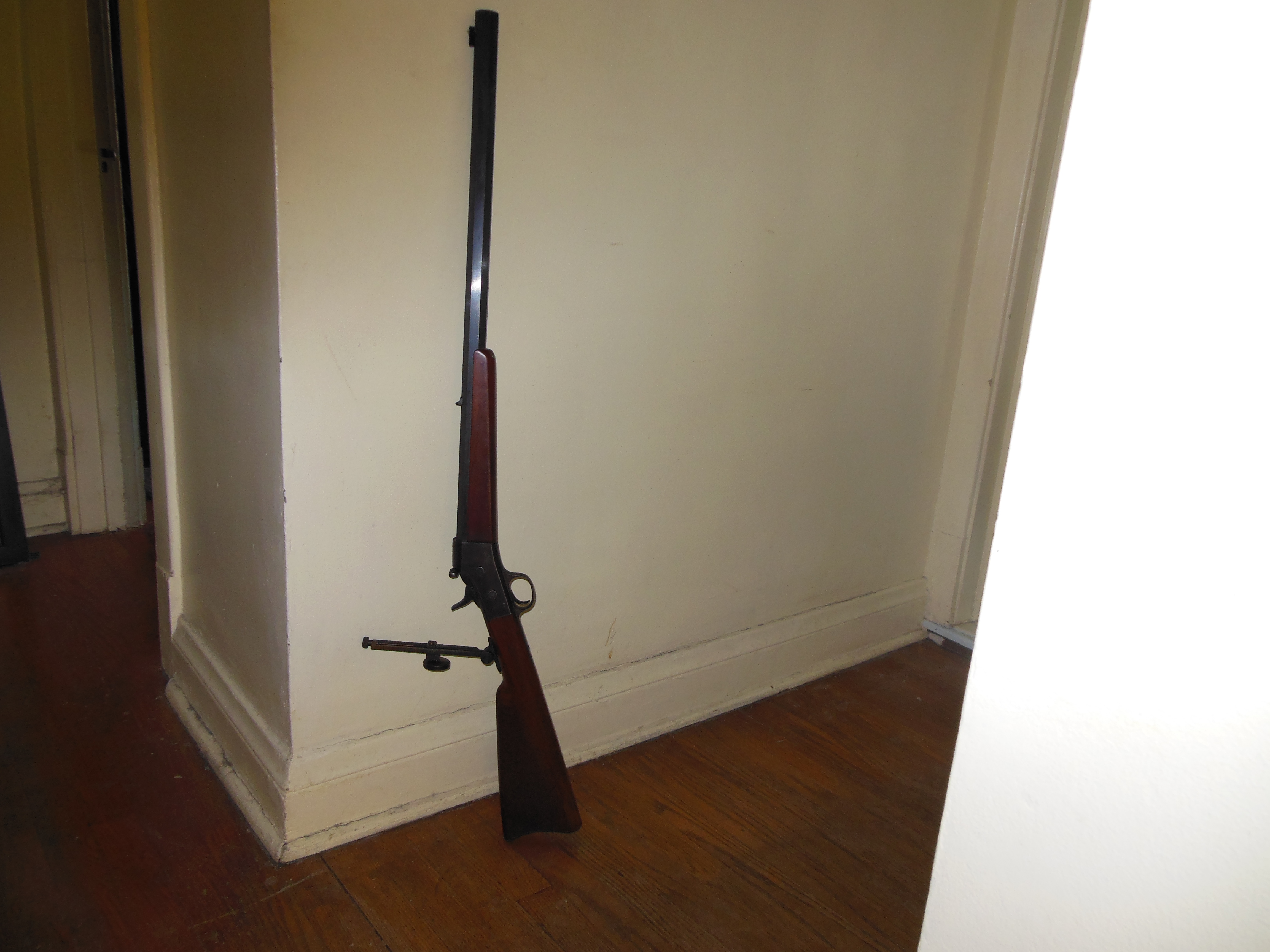

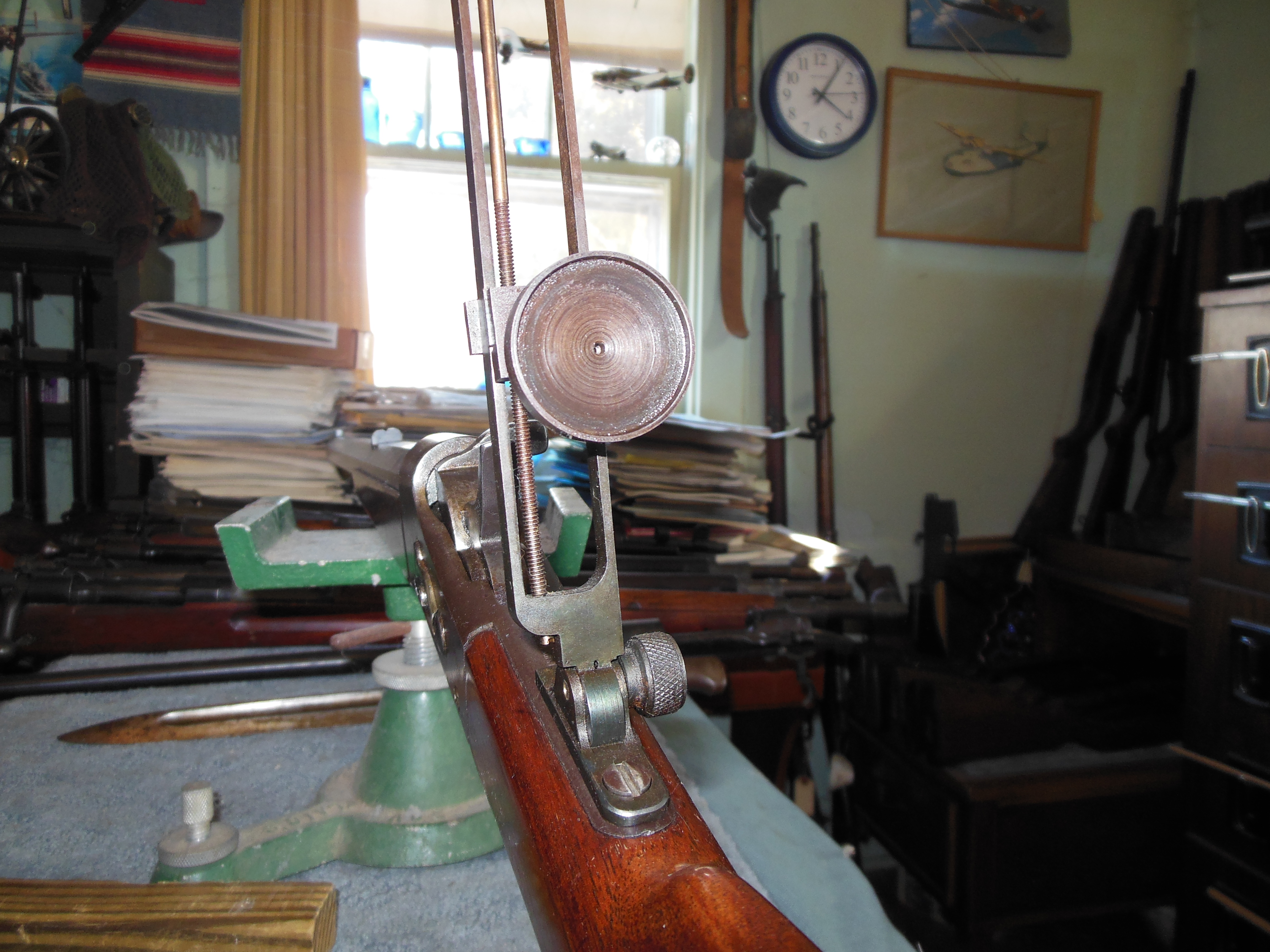

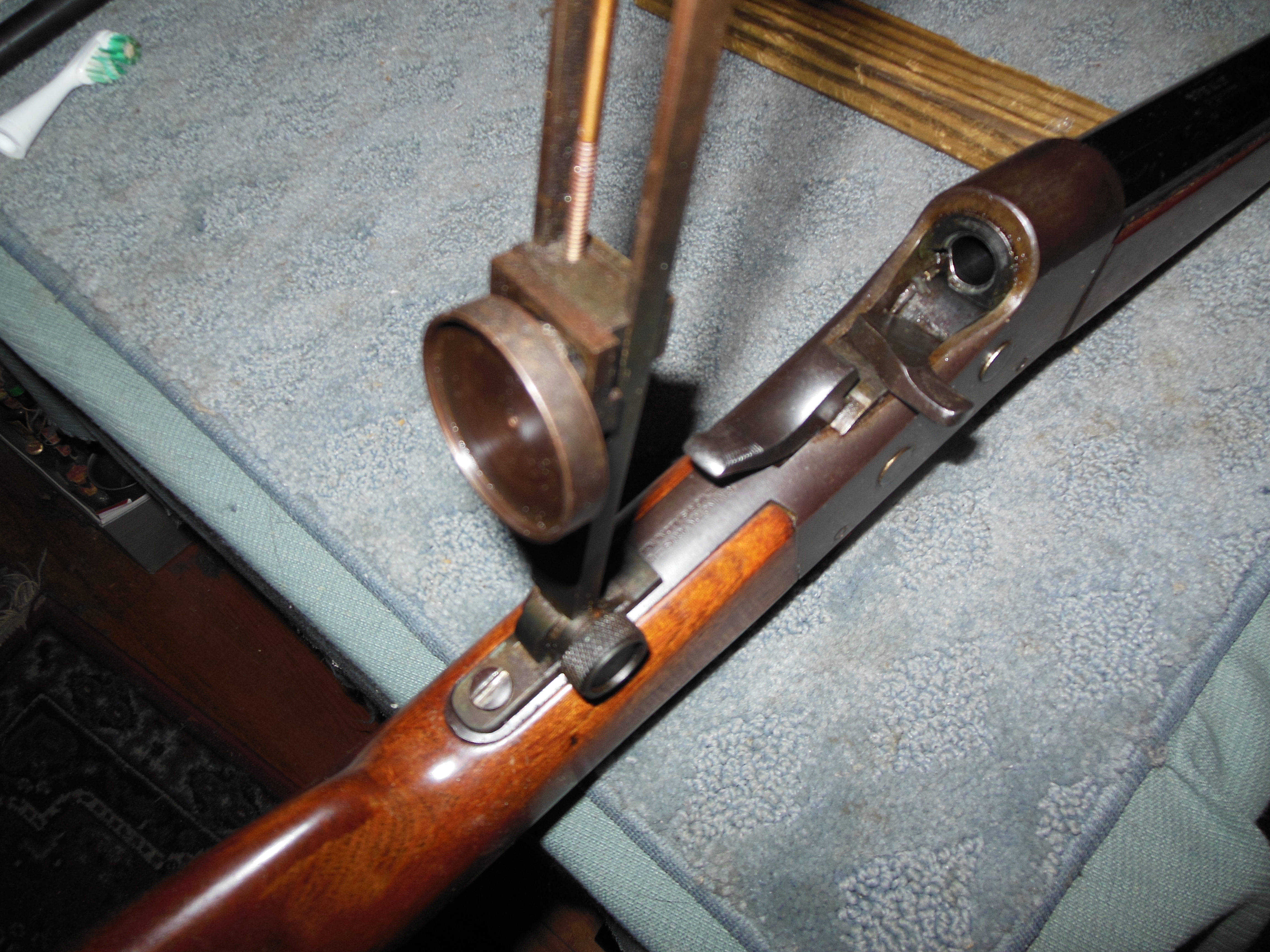

I bought one that had been sporterized years ago and rebarreled it to 45-70. As I was shooting alot of black powder reloads with the heavy 500 gr lead bullets, I decided to make
a simple but effective tang sight, When the bullets hit the small three inch steel plate at 100 yards, I marked the sight and so on to 200 yards. I was also able to provide windage too.

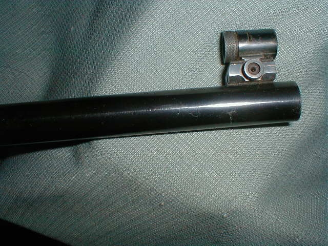

For the front sight , a dovetail scope block was installed with a M70 Win globe front sight with inserts.

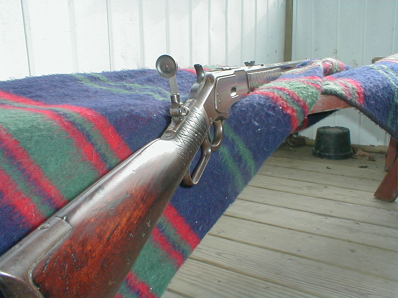

What I would advise, is to buy a reproduction Lyman No 2 tang sight, like the original in my Win 1873 photo. You will need a gunsmith for installation. A good gunsmith should also be able to provide some choices for a front sightAttachment 137112Attachment 137113Attachment 137114Attachment 137115
