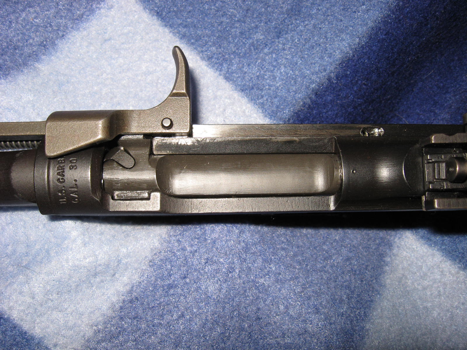

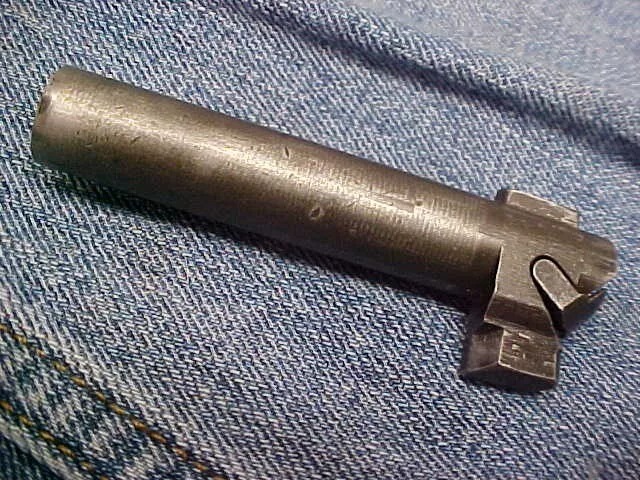

Looking for M1 Carbines and Bolts that are Missing the Punch or Pr!ck mark on them that means they went thru a Proof Firing test before Ordnance acceptance.
The Receiver, Barrel and Bolt are to be marked by the Ordnance Inspector to indicate that they have successfully passed the Proof Firing test with a high pressure M18 proof cartridge. This applies to finished carbines, spare bolts and spare barrels.

Bolt and Receiver Proof Firing Punch Pictured
