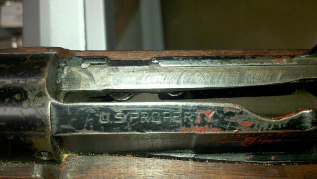

Here's a link to a thread showing a Savage with a badly mauled bolt head guide. Somewhat unintentionally shown on artyldr01's part, but it's a great example. More photos on his thread:
Savage No 4 Mk1/3 with red paint?
https://www.milsurps.com/images/impo...8fe1246f-1.jpg
