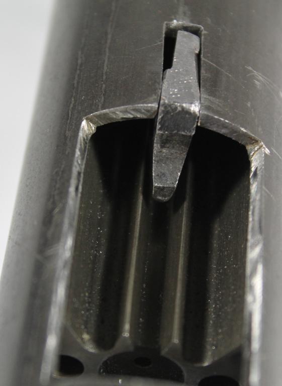

Getting close to the weld. I need to ensure I position the ejector properly before welding.

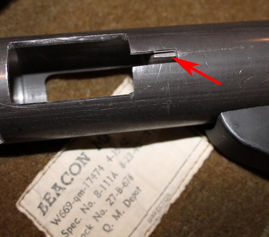

I'm going back to my problem with the slot for the ejector. You recall when the charging handle is moved up and forward it moves he block into the upper slot (safety), the bolt is moved forward and the rotation of the block puts a portion of the block over the grove where the ejector should be and the block will not move fully forward into its slot. I do not want contact between the two as that will damage the block or weaken the weld between the ejector and the tube. You CANNOT move the slot for the ejector, because if you do, the ejector will be in the wrong position when the block is moved forward to load a round.
You could mill the upper safety slot a little lower than depicted on the tube's template, but that leaves less metal between the upper charging handle groove and the lower. I think it would make it too weak. I think the proper solution would be to move the location of the safety groove aft (away from the ejector) by about 5/16" Of course Newton said for every action there is an equal and opposite reaction. Moving the charging handle safety slot aft will make it all the harder to pull the block to the rear and into the slot because you are compressing the springs tighter. That tiny handle takes a lot of rearward tension to compress two springs. I do think this is the approved solution though.

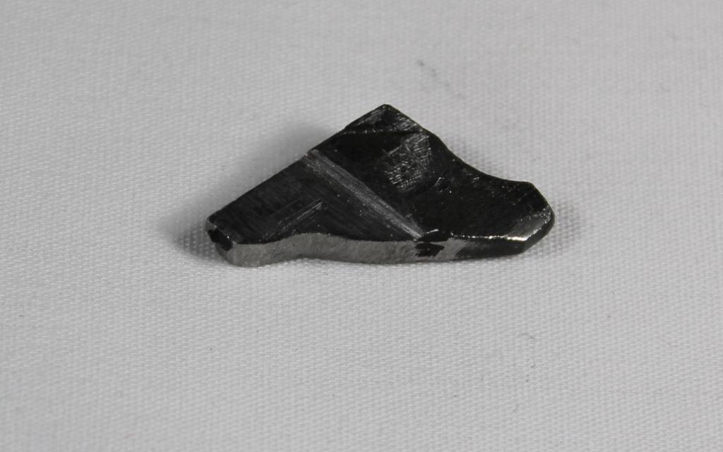

SInce my receiver tube is already milled, I have to work with the ejector. I filed the upper surface of the ejector thinner so that the block, when moved up and forward into the "safety" position would ride over the ejector with slight clearance. Here is the correction:
https://www.milsurps.com/images/impo...ctor1JPG-1.jpg
Here is how it looks with the ejector installed and the block in the forward (charged) position. You can see the filed portion will allow for the block to move forward when in the safety position. My problem now is that I've filed the ejector down to it's original height. That was done by removing the scrap from the original tube where it was welded into the tube. Now I've created another problem; ( the photo below shows the ejector installed too high. In this position it will not contact the backof the 9mm case. It needs to be moved down into the block groove)I should have left a bit of scrap on the top so that it could be wedged into the slot and moved up/down to create the proper depth of seating so that the tip of the ejector rides in the block grove almost to the point where it contacts the block. If you do not do this, the tip of the ejector will not contact the back of an extracted/fired case and cause the lateral momentum to sling it out of the ejection port with the spring aided extractor. In the photo below, the ejector must move down quite a bit so that it will actually do its job. When I move it down into position, I no longer have anything to hold it onto the tube.
I will purchase a stainless steel hemostat clamp, zip strip it to the front of the tube and clamp it to the ejector in the proper position so that I can tack weld it in the right place and use that to hold it into the proper position using the paper shims between the ejector and the grove in the block. If tacked properly, I can remove the hemostat and fully weld. When the hemostat arrives, I'll take a photo and post that.
If anyone has any other ideas please let me know. Its very tricky to get the ejector to sit properly between the shims and in the grove when you use a file like Jack the Ripper:madsmile:

Another option would be to just make another ejector, which would fit the slot in the casing, and interface correctly with the bolt.

You don't want the ejector to be flush with the outside of the tube. The weld will be stronger if it is sitting down in the slot. Remember the magazine well will be sliding over this. So the weld needs to be in the slot. If you get any above the slot, you will have to grind it off so it's flush with the tube.. or the magazine well will not go on.
Yea...that's why i ground off the old tube so it could sit down a bit lower and receive some molten metal on top, thus binding it to the tube. I would then file the excess off to match the outer contour of the tube. I suppose I should have left just a bit on to wedge it in there, yet provide room for the weld. I did not know about the mag interference issue...thanks for calling it out!

By filing the ejector as I have, will there be strength issues with the part? It seems since I left the front profile alone and made my ramp down to the lower profile with a rounded bevel instead of a right angle, I should minimize the reduction in the strength of the part and not create a structual weakness. I mean....jeesh...we're only talking about knocking out an empty case that's held behing a spring extractor on one end. SHould not be much force impacting the ejector. Or am I a worry wart?:sos:
I will get a picture of the modified tripping lever and centering block up soon.
Don''t worry about you're ejector. You could file more away and it would is still be larger than the ones I have. They are shorter and still work fine.
