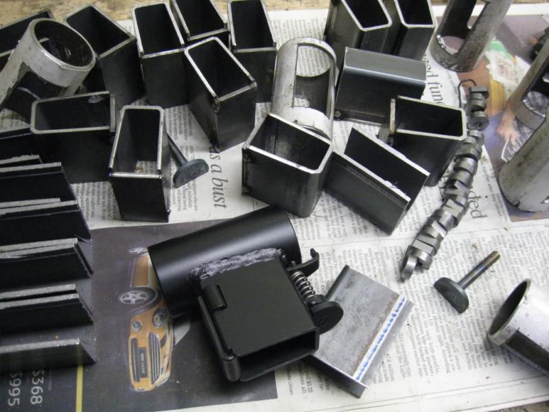

Mick, the trick with the MIG is to use it at very high power. I have a dedicated 20A circuit for my machine and upgraded wiring to handle the extra impedance. To get good mag box welds, I crank up the power - literally.

As for MIG welding, technique is a HUGE part of it. You need to build up an appropriately large puddle of molten metal to start with. I then traverse across the joint with a sort of swirling pattern to get a nice thick weld similar to what you get from OA welding.
My first sten was built with OA, I used mig on this one because a) I have the gear and b) MIG is easier to use if you are practiced enough to know how best to use one.
I like magwells a lot. I'm not sure, but I think I think I may be developing an obsession :madsmile:

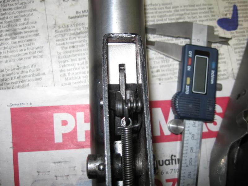

Here's another way of blocking the trip lever.
https://www.milsurps.com/images/impo...IMG_0666-1.jpg
https://www.milsurps.com/images/impo...IMG_0667-1.jpg
https://www.milsurps.com/images/impo...IMG_0662-1.jpg
My open-bolt design is actually with the CFC and RCMP labs right now for approval. It's actually been with them for almost 2 months now.
Some key points are that in my version the sear pin and trigger pins are welded in so that the internals can no longer be removed for modification.
