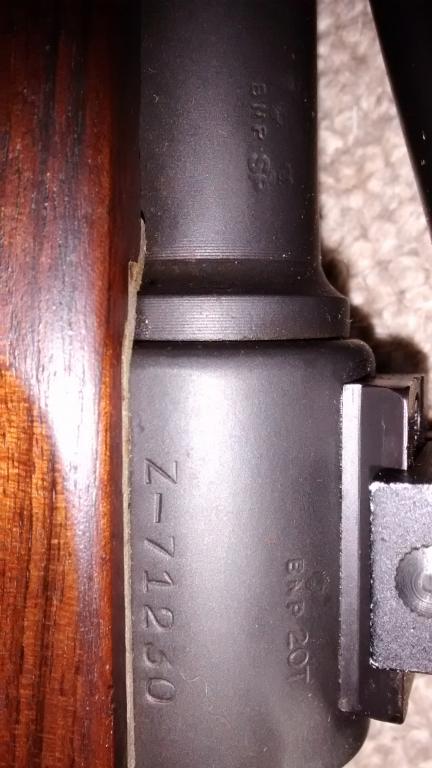

I have the C3 Contract in my hands and the rifle numbers that came back fro refurbishment for upgrades. I also have the schematics and oddments referring to the C3A1. Spoke to Bill, from his memory he says those rifles should have received a stamp :
"special proof 20 tons" stamped on them, so in answer to your query 20 tons is what he believes they were rated to.

Just to confirm your two numbers came back to Parker Hale on the 2nd November 1993 R23292 and R29813 which are recorded.
