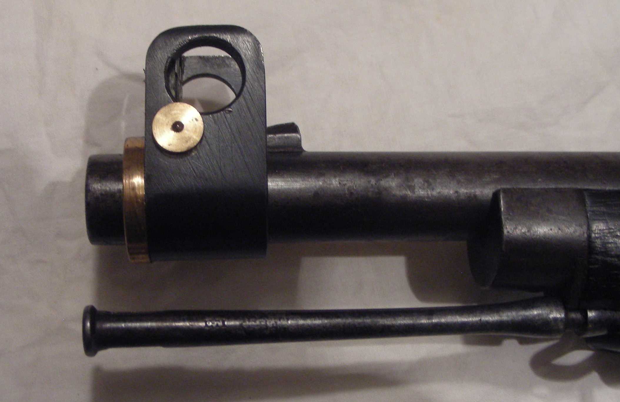

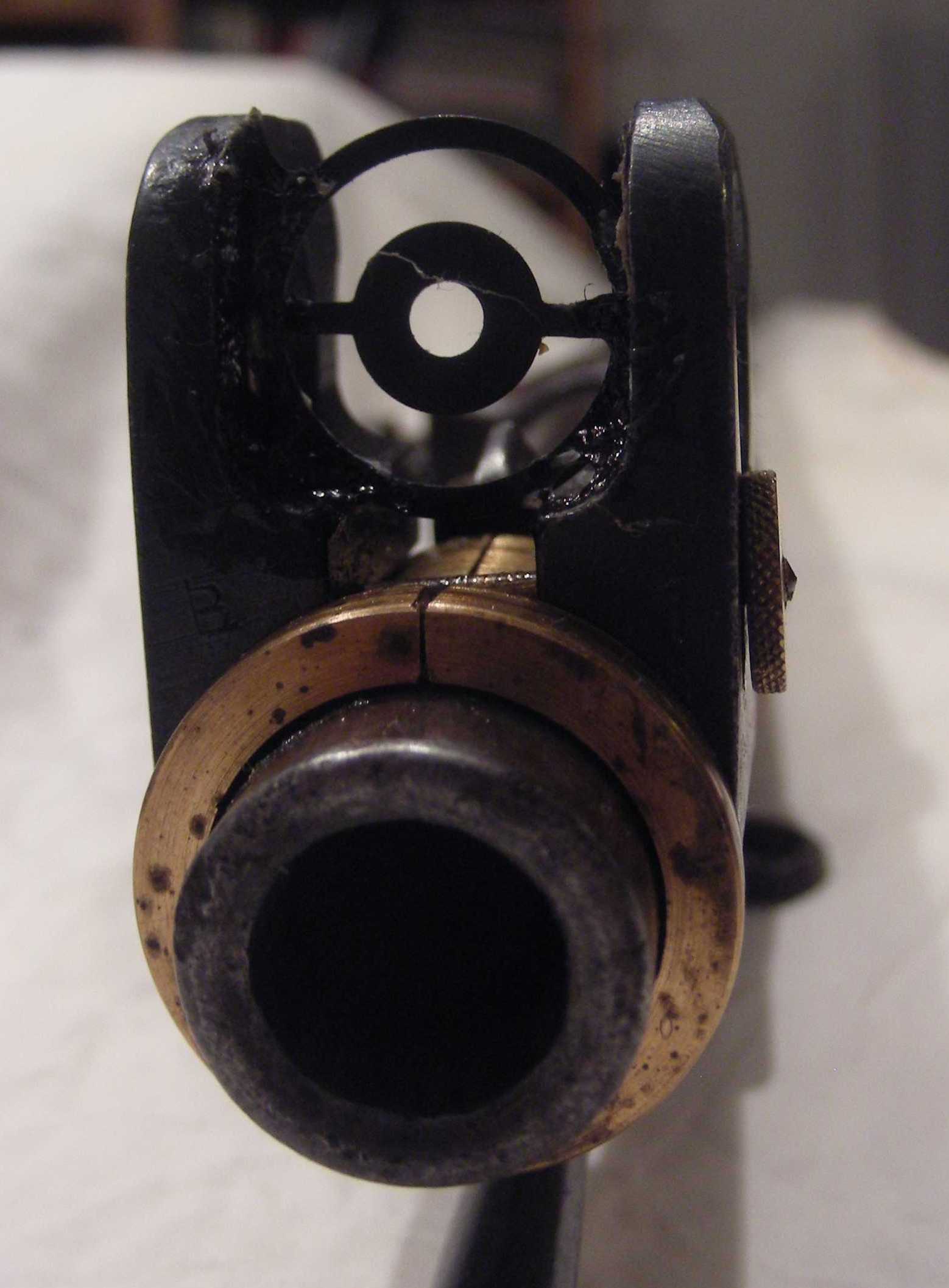

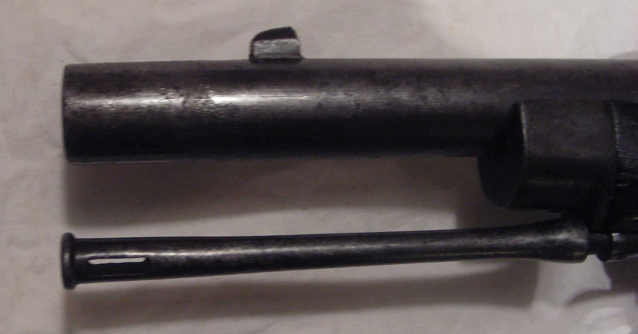

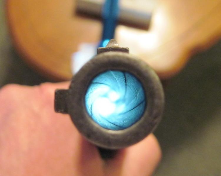

Surprisingly when I look down the barrel with my naked eye, it actually looks pretty good. Using +2.00 diopter reading glasses, it appears as a mild rough spot in otherwise smooth rifling. For now I’m not going to worry about it. I’ll concentrate on correcting the front sight, my own sight ....
100% agreement here. Correct the sight picture before doing anything else.
DId you take a close look at that foresight as I suggested. Spray it with the best penetrating oil you can find. Then a bit of tapping with the brass drift on the foresight blade, left-right AND fore-aft. Not heavy, but sharp taps. If there is a dovetail in either direction, then this micht just crack the bond enought that it shows up under a watchmaker's eyeglass. If you have not got one, such an eyeglass is a must. It is VITAL for the next problem...
