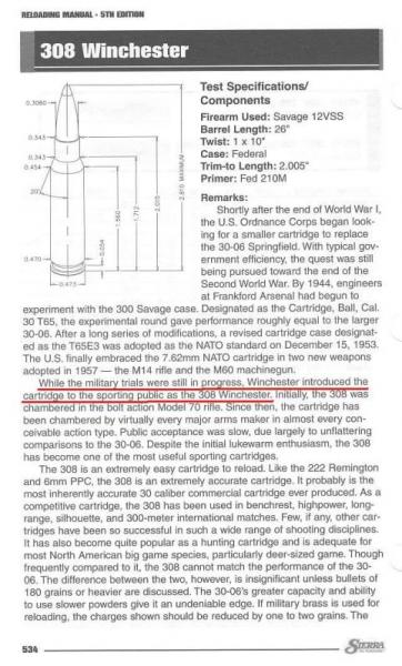

Reloading manuals are suggested safe loads, they don't mean that no factory ammo can exceed those suggested loads. As Ed's post above shows pressures can vary by thousands of PSI within the same lot.Quote:
No one would, that is being stupid, look at your reloading manuals I doubt any 308Win max load will reach 55,000PSI. Now look at that same reloading manual where the Winchester Short/Super Short Mags and the Ultra Mags are listed as 62,000PSI loads.
