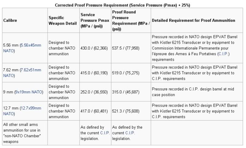

A .308 load that is safe enough for a modern Long Range Sniper Rifle that is manufactured to SAAMI standards may not be safe for a converted WW2 era sniper rifle when chamber pressures as high as 62,000 PSI were not envisioned for the 7.62X51 NATO cartridge when that conversion was aproved. The rifle was never proofed for cartridges producing 62,000 PSI and if it were built today it would still not be required to be proofed for use with cartridges of that pressure range by MOD standards.
Pressures of 62,000 PSI would be excessive for the L42, its not proofed for this pressure level and never would be.
