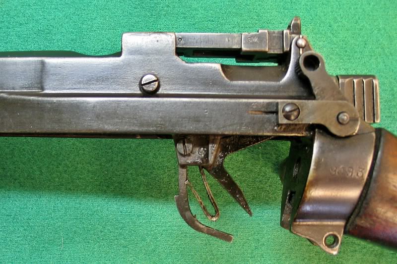

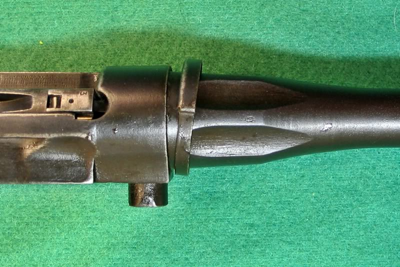

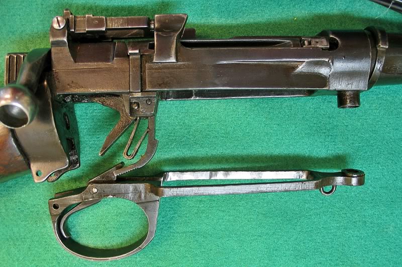

Perhaps these photos will provide the info you need:
https://www.milsurps.com/images/impo...gerGroup-2.jpg
https://www.milsurps.com/images/impo...erGroup2-2.jpg
Relief cuts on Barrel shank:
Please let me know if you need any additional photos.

Yep, that's a true, real No5! Not a lot of people realise that a genuine No5 body is lightened between the rear trigger guard screw ears too and this one definately is.
I was suspicious because the bodyside designation had been linished off. Thanks for the C&R
Pull the hand guard off and look for the lightening scallops in the Knox Form. I dont think anyone replicates these on a fake.
OOPs sorry. I posted before going to page 2
Yepper. Thats them.
