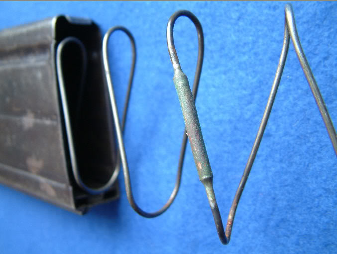

What type of extended spring do they then use, with such an alteration? I would think the spring function would be the weak link here?

Just going on the ones I have, the 30rnd one has an extra section of spring joined to the main spring by the ends inserted into a copper tube and soft soldered.
https://www.milsurps.com/images/impo...agspring-1.jpg

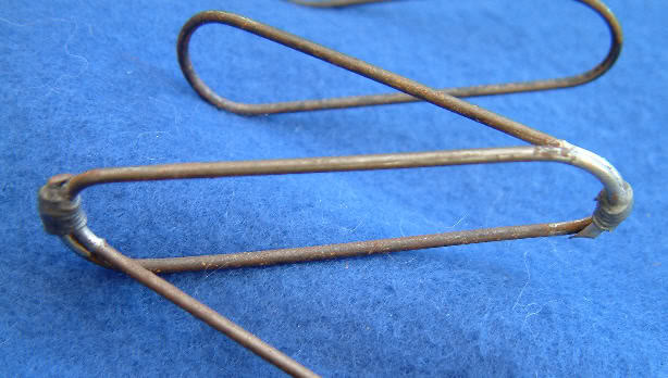

The 40rnd mag is extended by an extra section of spring that is wire bound and soft soldered to the main spring section.
https://www.milsurps.com/images/impo...mage0077-1.jpg
Soft solder should not have affected the temper of the spring and they still function OK today........a neat solution.

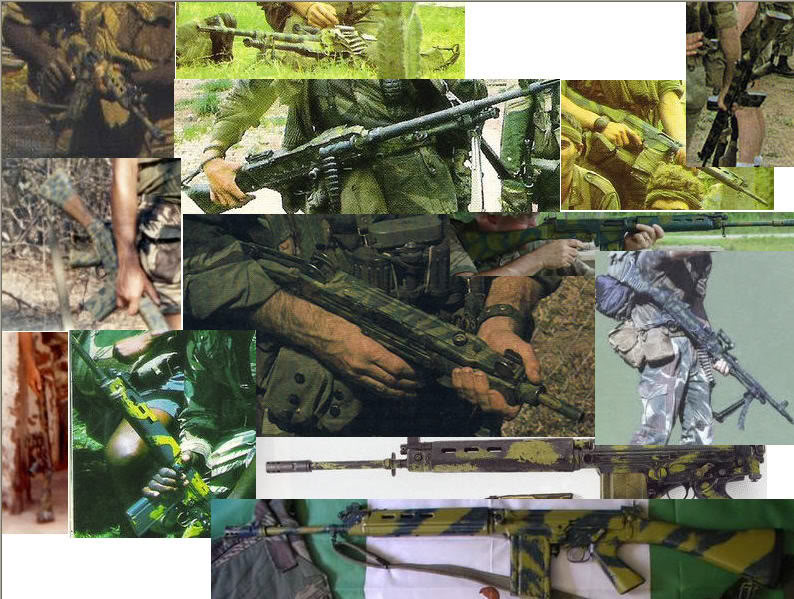

A kind person has given me a link to plenty of pics of Rhodesian cammo weapons that ID the cammo as 'pre Bob'
ATB Kevin
Great link and I guess that answers the question

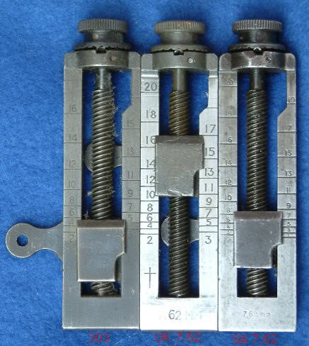

I'd be inyterested to know if the backsight is recalibrated to 7.62mm Metric or left in its .303" guise KevG. The generally accepted notion that a .303"-yards backsight was the same as a correctly calibrated 7.62mm sight when read in metres was an absolute myth.
They equated on the 25 yard range but thereafter, it was just a myth
ATB Kevin[/QUOTE]
A great link, I have not seem so many photo's of the Rhodesian armed forces. I like to think that their memory will live on.
The Rhodesian cammo is still very different from the pictured weapons, and nowhere near the "all over" coverage.
Peter the original .303 calibration has been scrubbed and re-engaved with metric range markings.
ATB Kevin

There was a lot of variation in the applied camo pattern, and if some Rhodesian weapons don't seem to have an "overall coverage", it's probably because they were being humped around in the bush & banged against vehicles for years.
