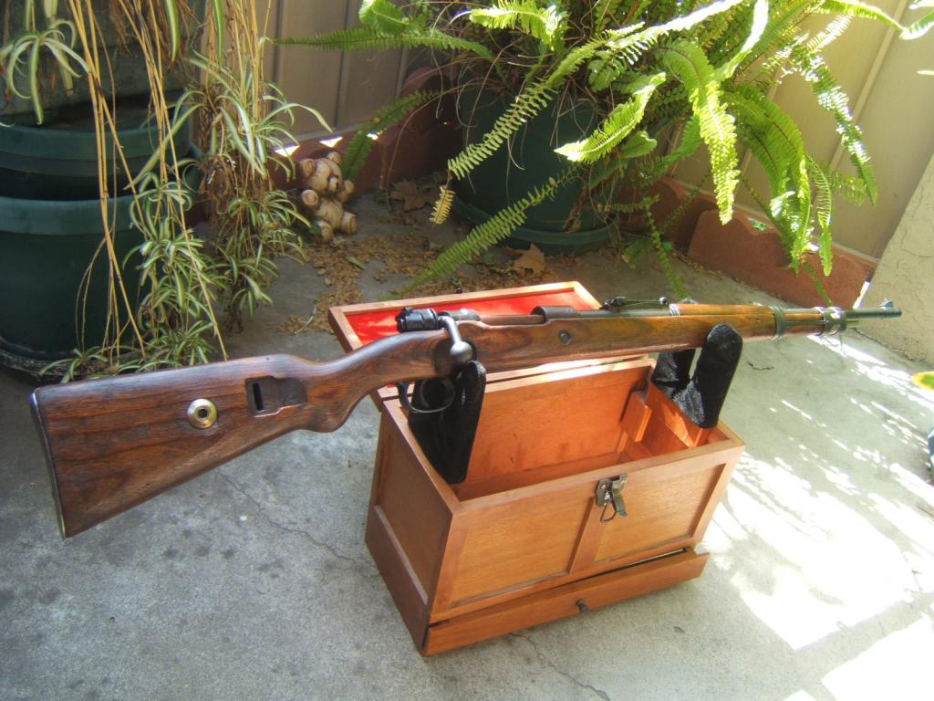

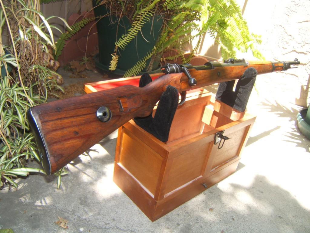

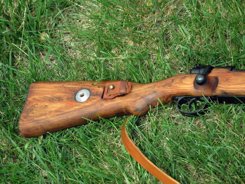

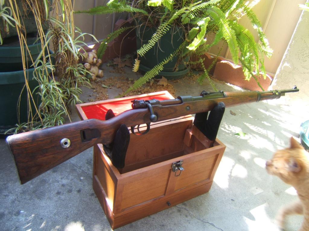

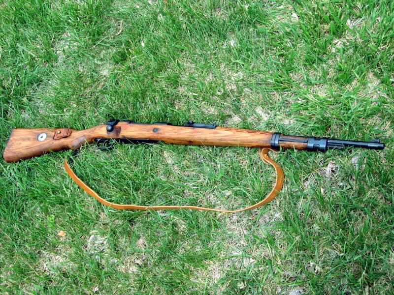

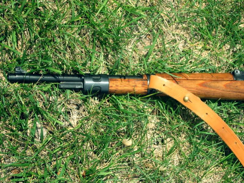

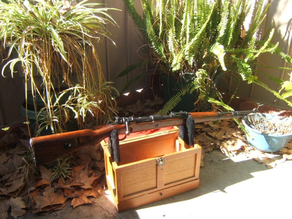

here are a couple of mine:
before:
https://www.milsurps.com/images/impo.../30bfx2w-1.jpg
after:
https://www.milsurps.com/images/impo...5/jhempu-1.jpg

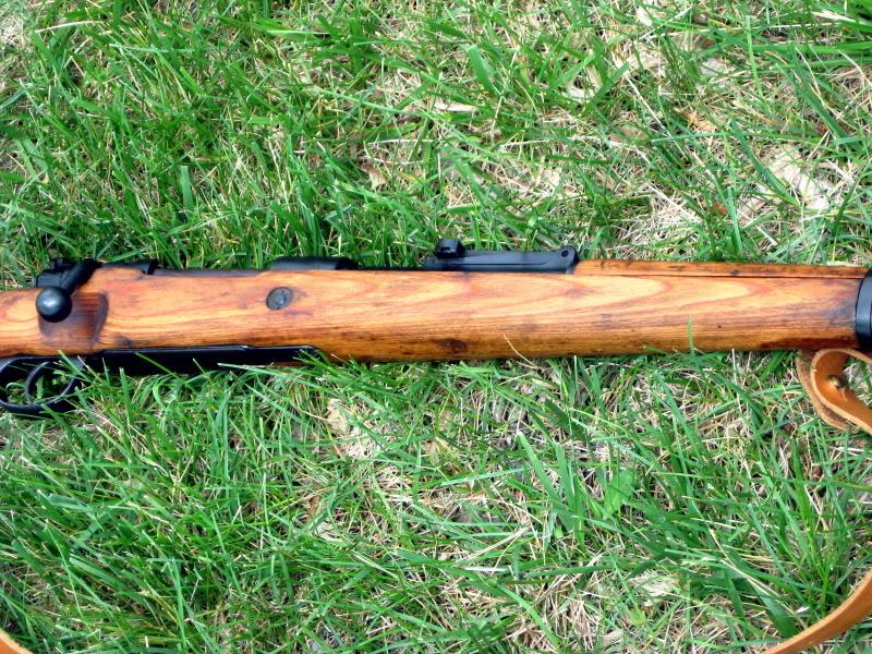

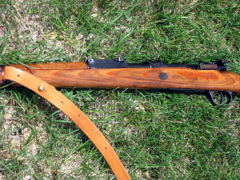

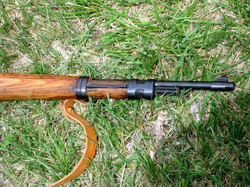

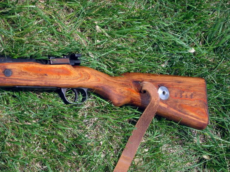

a different rifle before:
https://www.milsurps.com/images/impo.../2edz4ef-1.jpg
after:
https://www.milsurps.com/images/impo...5/axza05-1.jpg
